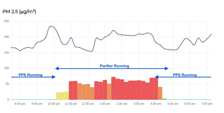

The comparison was done in a 32m2 room with the above PPS system permanently installed.
Timeline of the experiment:
  • 10:10pm: PPS System was switched off and purifier was switched on (to maximum setting)
  • 04:15am: PPS System was switched on
  • 04:45am: Purifier was switched off
As we can see from the graph, once the positive pressure system was switched off, polluted air entered the room through small air gaps. It increased for approximately 1 hour until it reached equilibrium with the purifier at around 50μg/m³.
The standalone purifier was able to reduce the ambient PM 2.5 values by about 75%. We can see some correlation with the outside PM 2.5 values so we can assume that the indoor pollution would always fluctuate depending on the outside values.
On the other hand with the positive pressure system switched on, we can see that the PM 2.5 values stay permanently at zero and there is no correlation with the outside air quality. This is because the positive pressure inside the room prevents any dirty air from entering the room.
