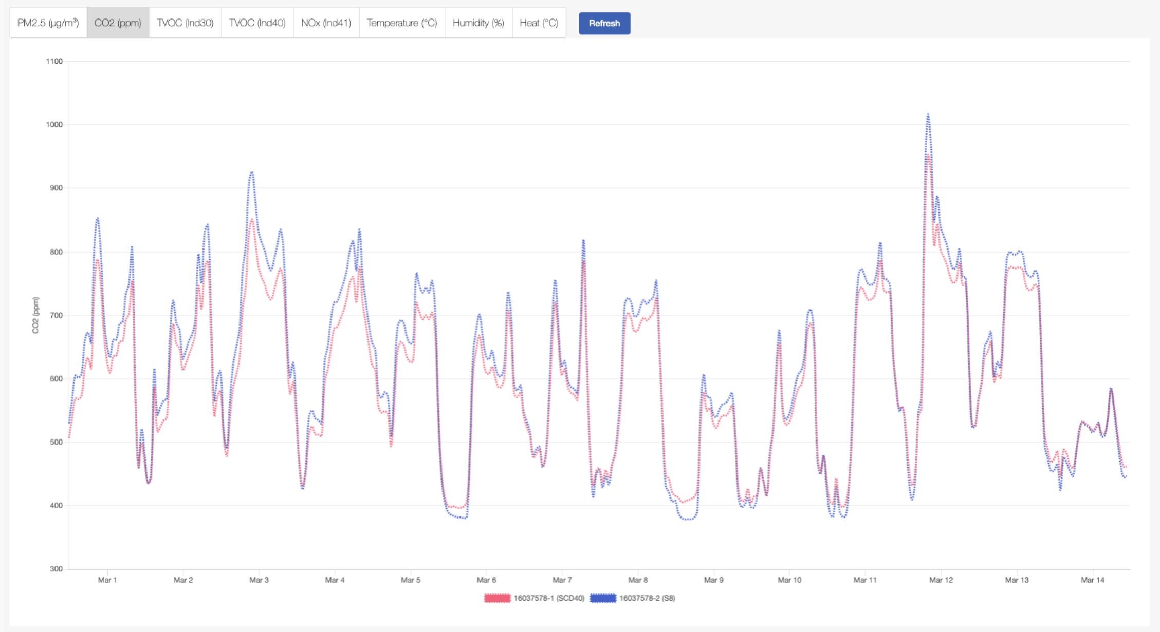

We tested the SenseAir S8 and Sensirion SCD40 / SCD41 for a few weeks and saw them behaving very similarly. Below is a chart over 14 days in a typical indoor home environment (bedroom).
Photo acoustic principle diagram
Timeline comparison SenseAir S8 and Sensirion SCD40.

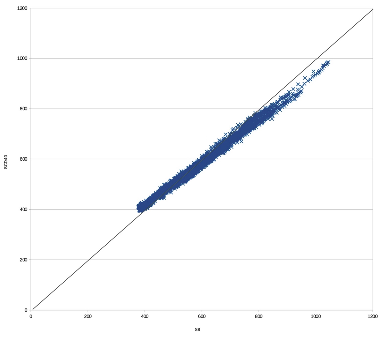

Both sensors deliver very reliable results and the only difference that can be spotted is that the S8 seems to be a bit more sensitive and picks up higher values more. This can be seen on an X Y chart:
Comparison chart
X Y comparison SenseAir S8 and Sensirion SCD40.
