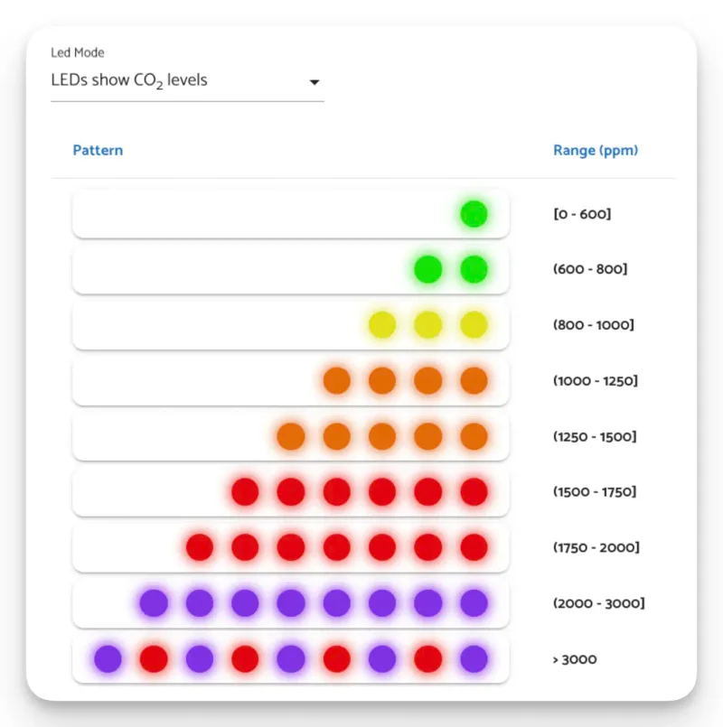

```Carbon dioxide threshold table
AirGradient's CO2 thresholds

A CO₂ Scale for the Spaces We Inhabit
Given these findings, there is a need to shift how we assess CO₂ levels indoors. Instead of using CO₂ as a marker of ventilation efficiency, it should be recognised as a direct factor influencing human health and productivity. While CO₂ monitoring is increasingly accessible, there remains a critical question: At what levels should alarms be set to safeguard health and performance? A standardized CO₂ Exposure Scale similar to the Air Quality Index (AQI), could help guide public awareness and regulatory standards.
LEVEL CO₂ CONCENTRATION (ppm) RECOMMENDATION
GREEN SAFE/OPTIMAL < 800 Maintain levels of occupancy, ventilation and air filtration
YELLOW MILD CONCERN 800 - 1000 Mild cognitive effects with potential increase in fatigue and headaches. Generally safe for most individuals. Ensure adequate ventilation and monitor CO₂ levels.
ORANGE MODERATE RISK 1000 - 1500 Noticeable cognitive decline, early signs of physiological stress. Increase ventilation and introduce CO₂ scrubbing strategies.
RED HIGH RISK 1500 - 2000 Metabolic and cardiovascular stress markers increase. Increased risk of respiratory symptoms in children. Increase ventilation and introduce CO₂ scrubbing options.
PURPLE SEVERE RISK > 2000 Severe cognitive decline and increased likelihood of worsening metabolic and cardiovascular impairment with symptoms such as dizziness, shortness of breath and difficulty concentrating. Requires urgent ventilation improvements. Vulnerable populations are at risk.
3000 + Immediate Ventilation improvements required.
