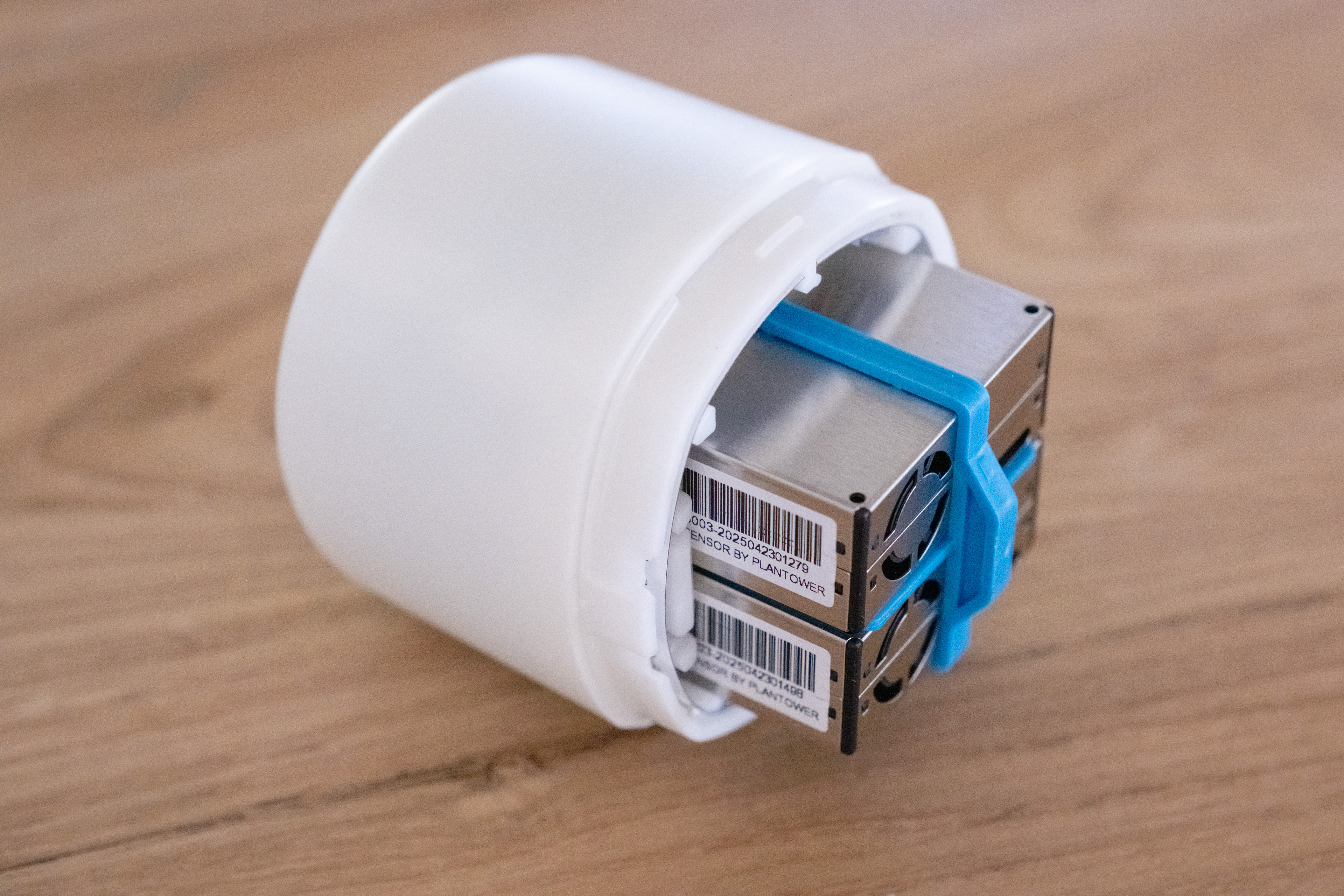

PurpleAir Zen AQ Monitor
A PurpleAir monitor with the Plantower PMS6003
Anyone who has spent time around air quality monitors already knows that many consumer devices and so-called professional devices share most of the same components. I was well aware of this before arriving in Chiang Mai. It is common knowledge in the industry that a fifty dollar monitor can use the same PM or CO₂ sensor as a three hundred dollar monitor, and that even devices costing thousands of dollars may use the same basic modules. Achim has actually already discussed this in more detail in this blog post.
Despite the enormous price differences between these monitors (which partially could also be due to different services provided), they all use the same type of Plantower particle sensors (PMS5003 or PMS6003):

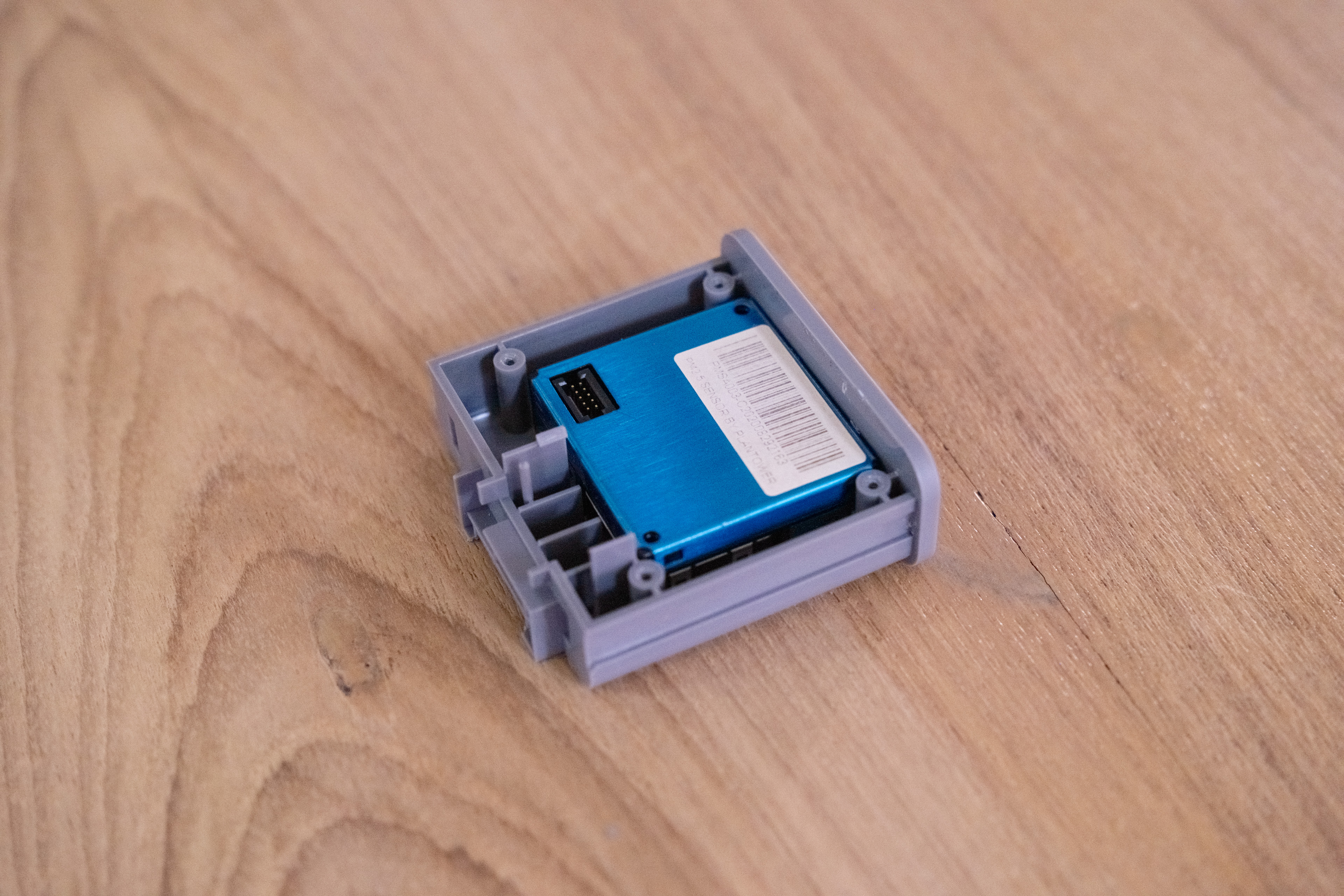

A Plantower PM Module
And this is where the problem begins. Instead of clearly showing the components they use, many brands hide the actual sensor modules inside proprietary cartridges or custom-shaped housings. On the outside, these cartridges look specialised and high-quality. On the inside, they often contain the same standard $10 off-the-shelf sensors used in much cheaper devices — just wrapped in a well-designed casing to make them appear bespoke.
I appreciate well-made products, and there is nothing wrong with paying a bit more for something that feels solid and looks clean on a desk. The issue arises when design is used to obscure what is actually inside, especially when those proprietary housings also come with significant markups. Some cartridges cost 10x more than the underlying sensor itself, even though they add no measurement benefit.

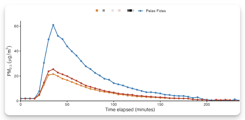

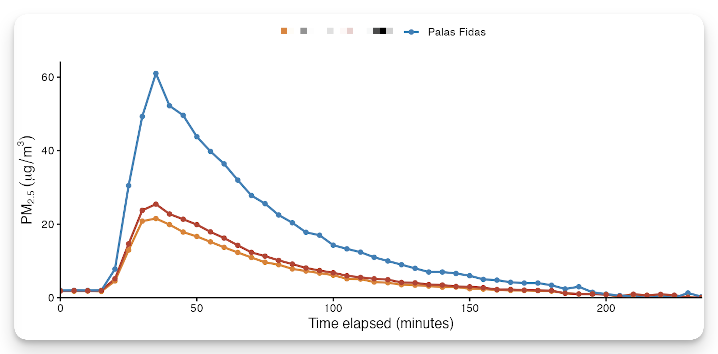

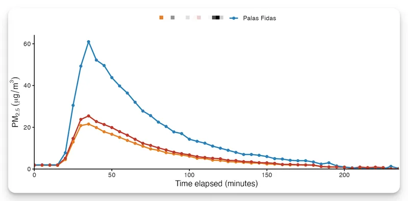

Timeseries plot
Two of the tested monitors deviating significantly from our reference device
Another persistent issue - and the last one that I will discuss today, but by no means the last one that I encountered - in this space is how many brands claim high levels of accuracy without providing any evidence. It is common to see specifications like “±5 µg/m³ accuracy” for PM2.5, even when the underlying sensor has a published specification that is far less precise. This appears to be especially common with proprietary cartridges that appear bespoke on the outside but contain standard modules inside.
What makes this even more concerning is the near-total absence of supporting data. Very few companies publish co-location results, reference comparisons, long-term drift analyses, or even basic calibration notes. Some mention “factory calibration,” but almost none provide the data that shows how well that calibration performs in real-world conditions. Even when accuracy reports are requested directly, many manufacturers are unable to provide anything beyond the marketing sheet.
This lack of transparency becomes especially visible once you begin comparing devices. In some of our tests, monitors simply did not match the accuracy implied by their specifications. There could be many reasons for this — perhaps the manufacturer calibrated with a different aerosol, under different environmental conditions, or against an unspecified reference instrument. It’s impossible to know. And that is ultimately the problem: users are asked to trust numbers that appear authoritative but are rarely substantiated, explained, or repeatable.

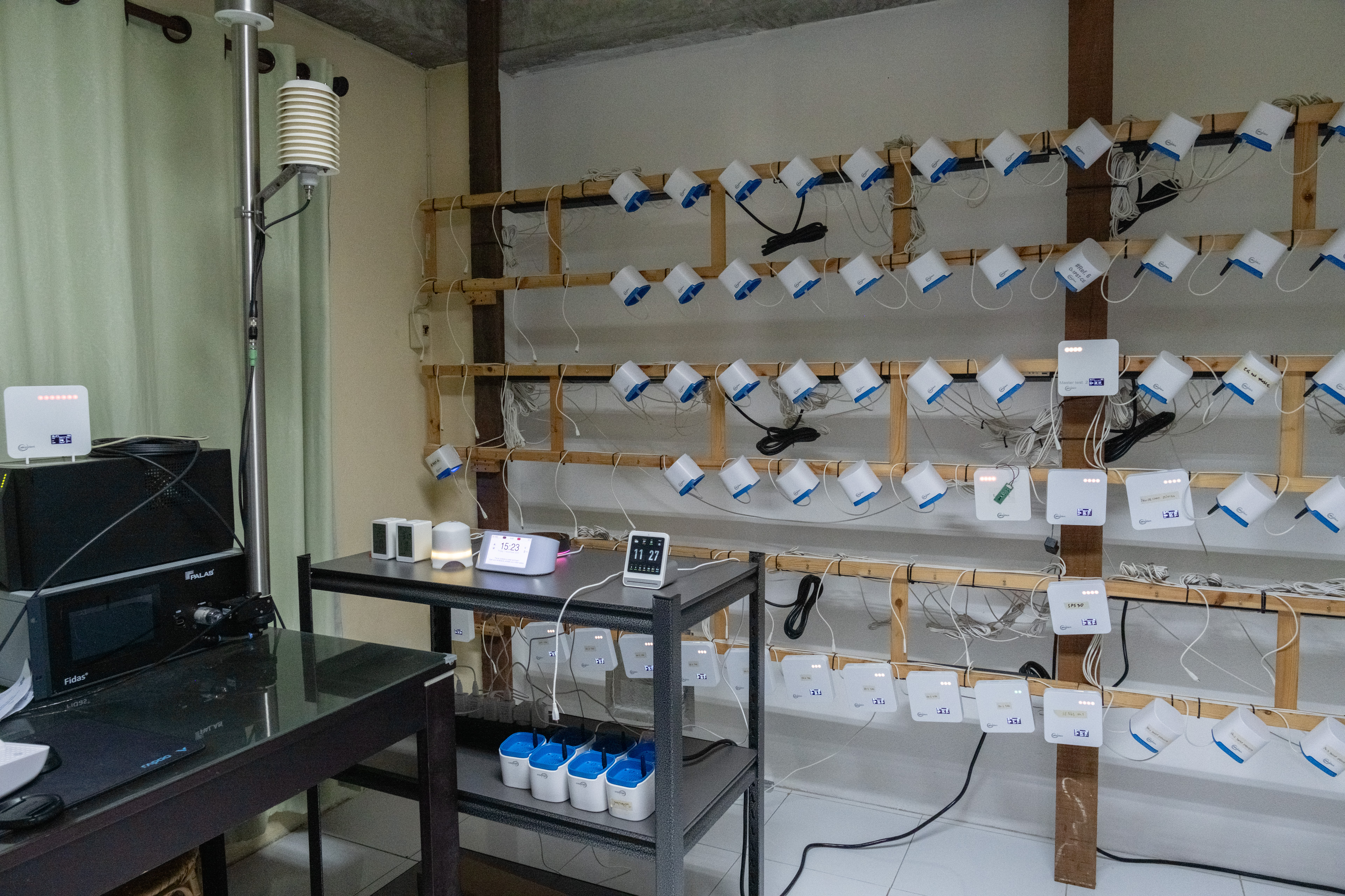

Testing air quality monitors
Testing dozens of monitors has exposed to me something that often stays hidden: how much of this industry runs on opacity. When devices conceal their components, rely on cloud services to function, or advertise accuracy no one can verify, trust breaks down and the people relying on these devices are left with little to go on.
