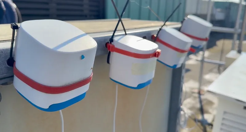

It is easily possible to add a Wemos D1 mini to the Vindriktning and thus enable it to send data to a cloud backend. So I was able to get a constant stream of data from it and was able to compare it to our AirGradient standard sensor which is the Plantower PMS5003 sensor.
The Plantower PMS5003 is one of the best low cost PM2.5 sensors using the laser-scattering method and has been proven to have a good correlation and accuracy compared to reference instruments.
Below is a chart with the Ikea Vindriktning (red) versus two Plantower PMS5003 sensors (green and blue):
It can be seen that all three sensors correlate very well but that the Vindriktning only shows about 65% of the PM2.5 values of the other two sensors and thus seems to considerably understates the air pollution.
