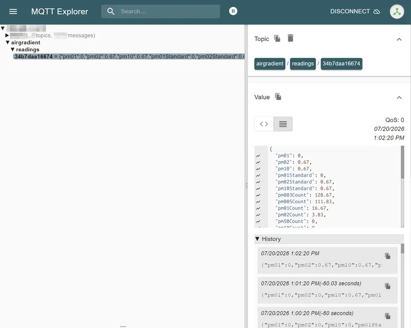

AirGradient ONE & Open Air can send the data not only to the AirGradient Cloud, but also to a local or remote MQTT broker. It publishes a JSON payload every 60 seconds.
The payload is sent under the following Topic: airgradient/readings/{{SENSOR SERIAL NR}}. For example: airgradient/readings/34b7daa16674

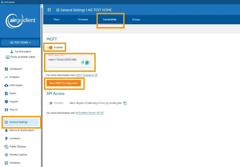

To enable MQTT via the AirGradient Dashboard, go to General Settings > Select 'Connectivity' tab > Toggle MQTT switch to enable > Input your MQTT Broker URL > Click 'Save MQTT Configuration'
If your broker has a username and password it can be set in this pattern mqtts://username:password@my.broker.com:4711/dir
For more information visit: https://docs.espressif.com/projects/esp-idf/en/stable/esp32/api-reference/protocols/mqtt.html
JSON Payload Structure (an example from AirGradient ONE)
"pm01": 0,
"pm02": 0,
"pm10": 0,
"pm01Standard": 0,
"pm02Standard": 0,
"pm10Standard": 0,
"pm003Count": 129.83,
"pm005Count": 116.17,
"pm01Count": 18.17,
"pm02Count": 2.33,
"pm50Count": 0.33,
"pm10Count": 0.33,
"pm02Compensated": 0,
"atmp": 26.61,
"atmpCompensated": 26.61,
"rhum": 42.91,
"rhumCompensated": 42.91,
"rco2": 397.33,
"tvocIndex": 98.83,
"tvocRaw": 30777.58,
"noxIndex": 1,
"noxRaw": 15251,
"boot": 4,
"bootCount": 4,
"wifi": -47,
"ledMode": "iaqs",
"serialno": "34b7daa16674",
"firmware": "3.7.0",
"model": "I-9PSL"
