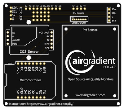

| DIY Basic 4.0 |
Gerber files STL Files |
Switched to shorter cross-over cable for PM. Made T/RH sensor slot compatible with AG module | standard version | BASIC.ino |

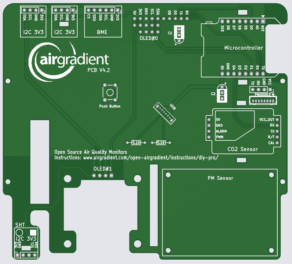

| 4.2 |
black or green PCB [Gerber files](/documents//gerber/gerber_diy_pro_v42.zip) [KiCad files](/documents/gerber/kicad-ag-diy-pro_V4.2.zip) [Enclosure STL](/documents/diy-pro/diy_pro_3d.zip) [Clip-On Stand STL](/documents/diy-pro/airgradient-stand-stl.zip) |
Improved tracing / ground plane, removed D1 shield, change in button connection, switch to cross over cable for PMS | [standard version](../diy-pro-v42/) / [presoldered version](../diy-pro-presoldered-v42/) | [DiyProIndoorV4_2.ino](https://github.com/airgradienthq/arduino/blob/master/examples/DiyProIndoorV4_2/DiyProIndoorV4_2.ino) |

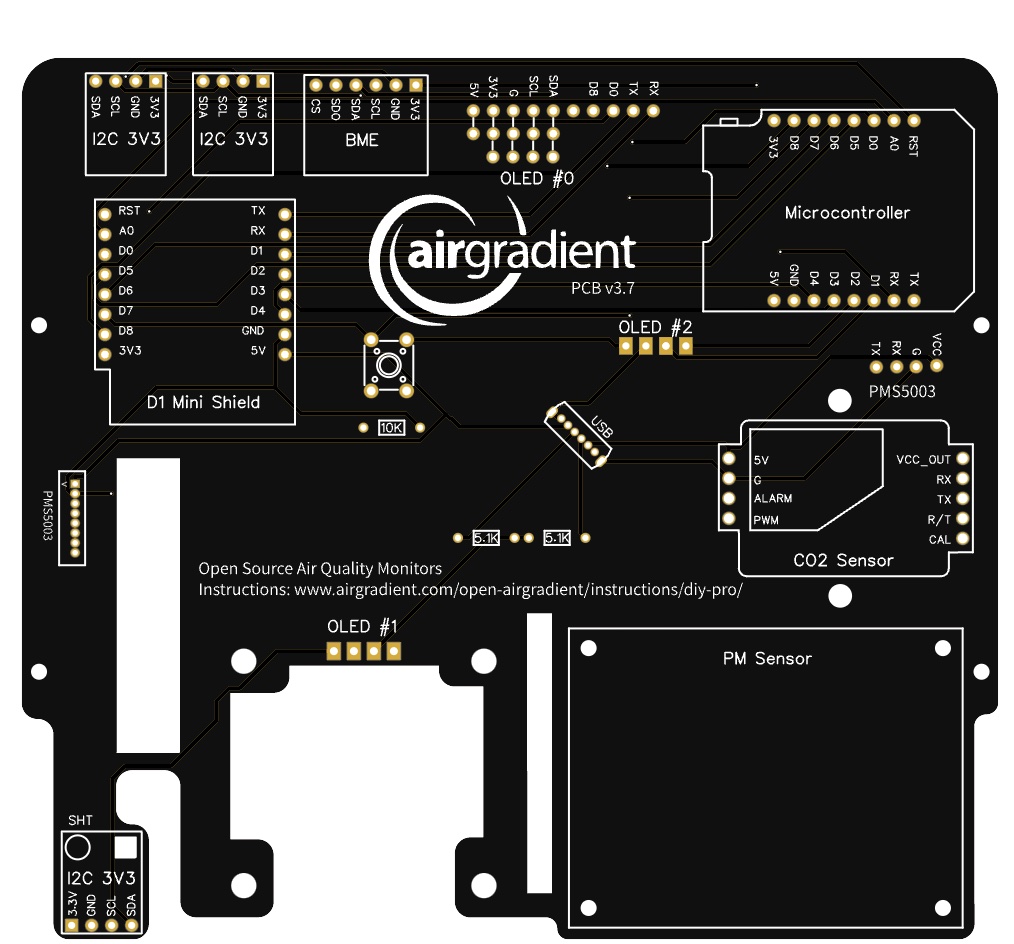

| DIY Pro 3.7 |
black or green PCB [Gerber files](/documents/gerber/gerber_diy_pro_v37.zip) [Enclosure STL](/documents/diy-pro/diy_pro_3d.zip) [Clip-On Stand STL](/documents/diy-pro/airgradient-stand-stl.zip) |
Push button for configuration, rounded corners | [standard version](../diy-pro-v37/) / [presoldered version](../diy-pro-presoldered-v37/) | Compatible with [DiyProIndoorV3_3.ino](https://github.com/airgradienthq/arduino/blob/master/examples/DiyProIndoorV3_3/DiyProIndoorV3_3.ino) but no push button functionality |

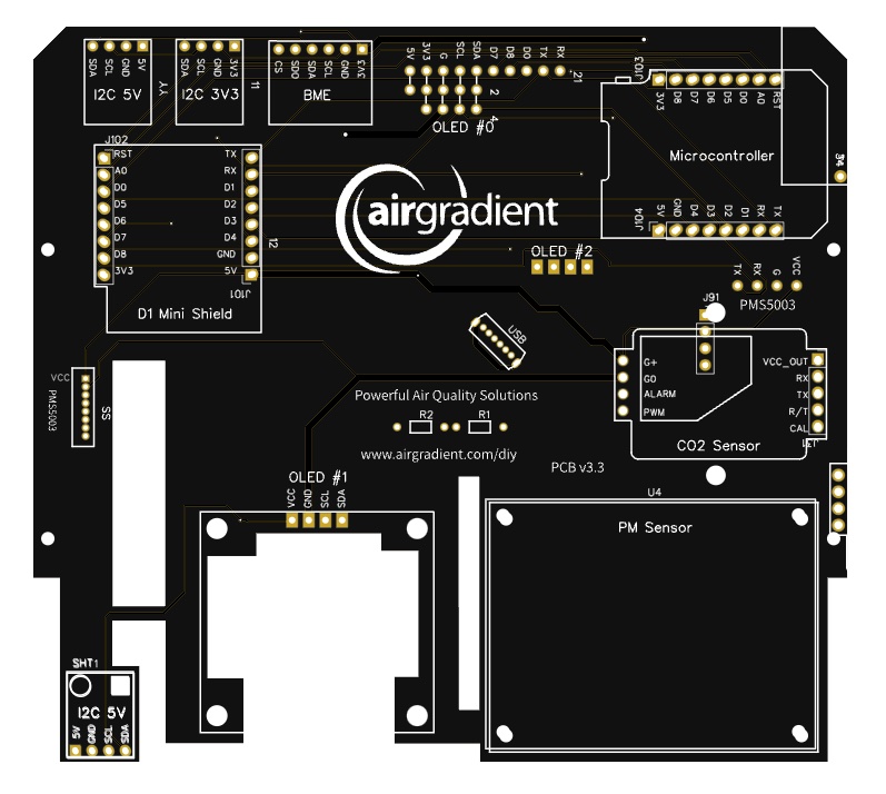

| DIY Pro 3.3 |
black or green PCB [Gerber files](/documents/gerber/gerber_diy_pro.zip) [Enclosure STL](/documents/diy-pro/diy_pro_3d.zip) [Clip-On Stand STL](/documents/diy-pro/airgradient-stand-stl.zip) |
[standard version](../diy-pro/) / [presoldered version](../diy-pro-presoldered/) | [DiyProIndoorV3_3.ino](https://github.com/airgradienthq/arduino/blob/master/examples/DiyProIndoorV3_3/DiyProIndoorV3_3.ino) |
