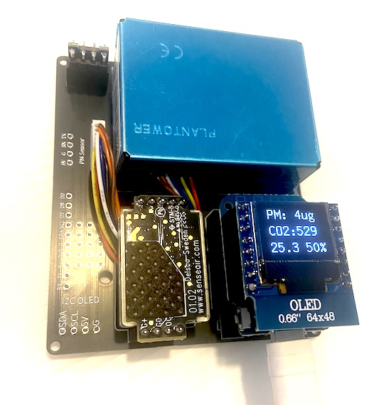

Fully assembled. Please note PCB v4.0 uses a smaller cross-over cable for the PM sensor.

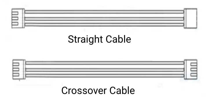

Please make sure you get the cross-over cable:
Straight vs Crossover Cable

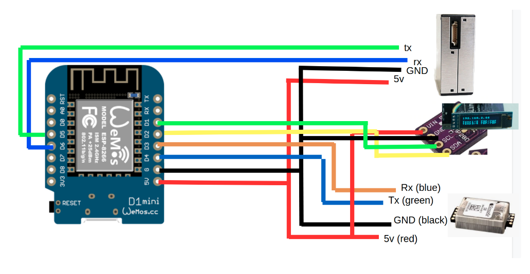

Schematics
You can use the following schematics:
Schematics

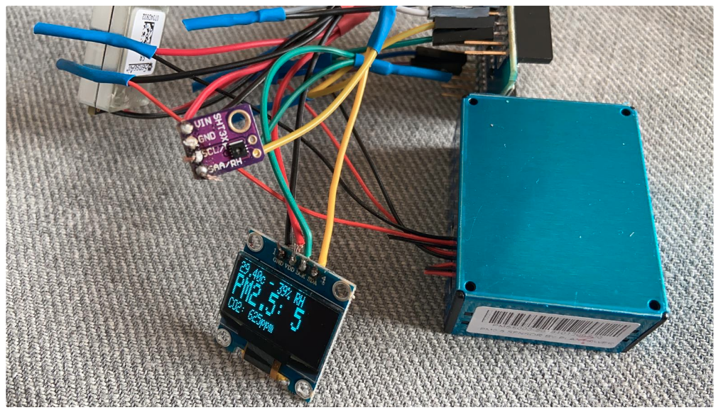

You can also get the components working without the PCB just by soldering the sensor modules with wires directly to the D1 Mini.
Built without PCB
However, we strongly recommend you assemble the monitor with a PCB as it will be much easier and more robust.

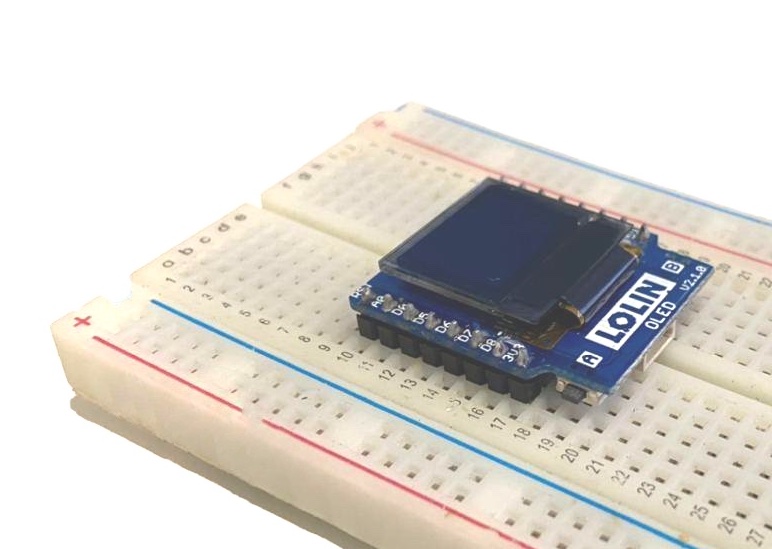

OLED Display Soldering
If you have a breadboard on hand, we recommend that you fix the pins with the breadboard to ensure that they are straight as shown in this picture.

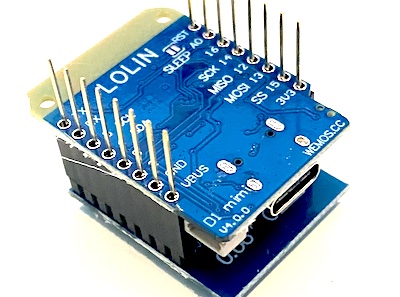

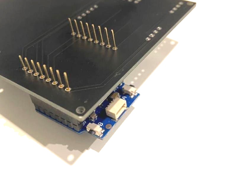

D1 Mini Soldering
Put the long female and male pins through the D1 Mini. Make sure that the female parts are on top of the D1 Mini (on the same side like the USB C plug) as shown in this picture and that the labels of the OLED pins and the D1 mini align:
D1 Mini soldering.
Then connect the freshly soldered OLED display into the female pins to better hold them in place. Then take the D1 Mini with the OLED display attached and turn it around and solder the pins onto the D1 Mini.

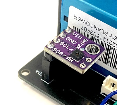

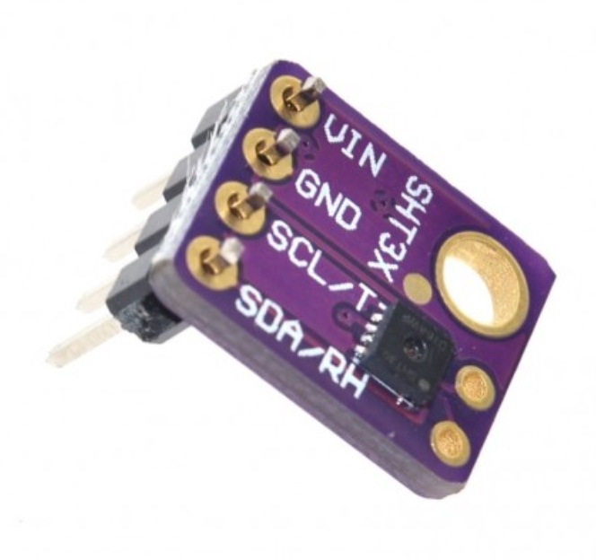

Soldering The Temperature and Humidity Module
You can use either the SHT3x module from AliExpress or the special AirGradient SHT40 module for temperature and humidity. The modules have a different design, so please follow the instructions below.
Instructions for SHT3x Module

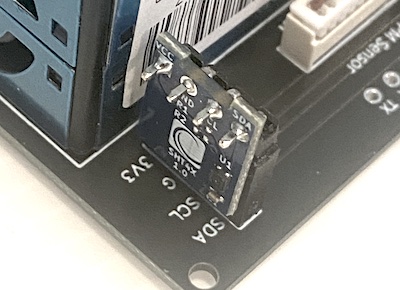

If you have the SHT3x module, you need to first solder the small pins onto the module, you can again use a breadboard to fix it in place. You only need to solder the four pins. No need to do anything with the two pins on the top of the sensor.
Soldering Pins onto the SHT Module
For easier replacement of the sensor modules, solder a 4 pin female header onto the board and then put the SHT3x module onto the pin header as per picture below.
SHT 3x Module Placement

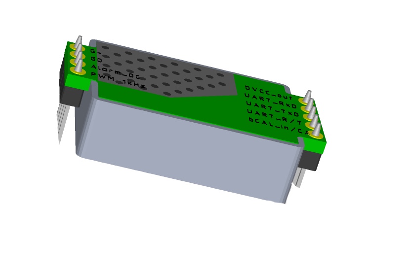

Soldering The Senseair S8 Module (CO2 Sensor)
Solder female pin headers onto the S8 PCB. Then put the S8 onto the pin headers.
Please make sure that the pins face as can be seen on this image. If you purchase the kit from us, these pins are already soldered on.
Senseair S8 pin header soldering
Please note that in previous versions of this PCB, the pins were soldered in the opposite way.
You can use ZIP ties to fix the S8 into place.

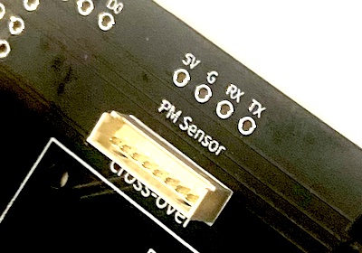

Soldering The PMS5003 Module (PMS Sensor)
The PMS Sensor is connected with a cable to the PCB. There are two ways to connect it. If you can solder the small JST connector, then solder it on the board:
PMS JST Connector
Make sure it is soldered in the correct way (as indicated with the silkscreen and can be seen in the image above).

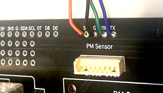

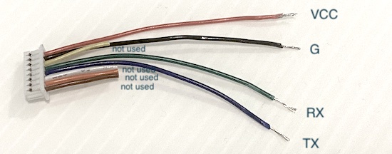

In case you cannot solder these small pins, you can also cut and splice the cable and solder it directly onto the PCB. Please note that the 3rd, 6th, 7th and 8th wire is not used and can be cut.
PMS Cable Wiring
Then solder the cable onto the PCB. Make sure that you solder the correct cable to the correct pin.
PMS Cable Connection without JST Connector
Please note that version 4 of this PCB now uses a smaller cross-over cable. Often the default cable that comes with the PM sensor is not cross-over. See above on how to detect what kind of cable you have.
After you have soldered the cable or connector to the PCB, connect the PMS5003 with the other end of the cable. Then screw the PMS5003 onto the PCB or use a double sided tape to fix it in place.
