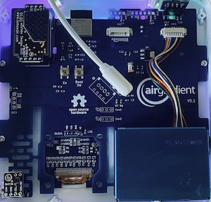

  1. Push the button on the PCB and keep it pushed
  2. Plug in the USB C cable
  3. Release the button. If you do not do this, the board will not get into the flash mode.
  4. Press the blue button above
  5. Select the serial port your monitor is connected to. It is typically called “USB JTAG / Serial Debug”
  6. Follow the instructions for flashing
  7. After the flashing is complete, restart the monitor by unplugging the USB C cable (and plugging it back in)
