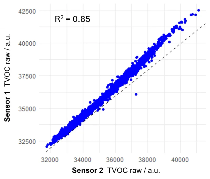

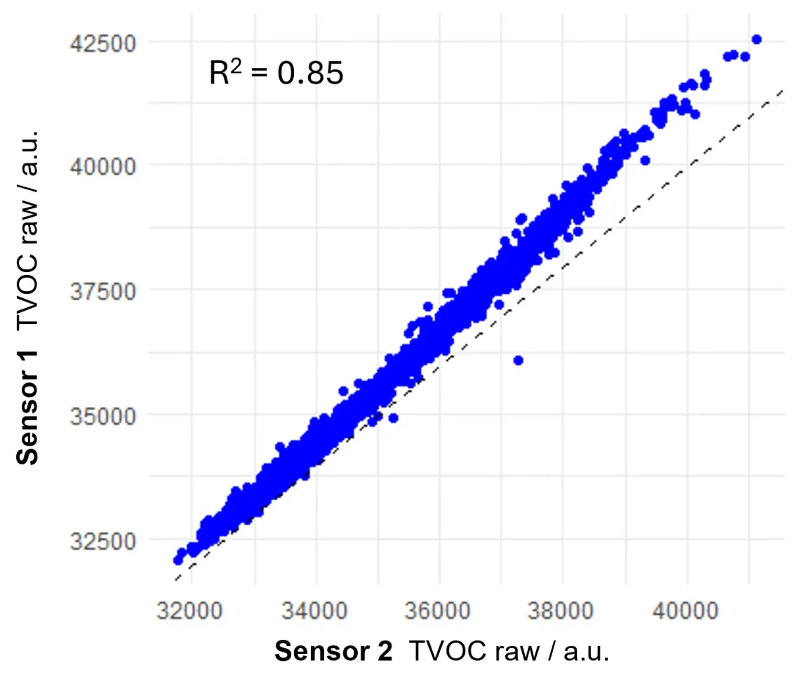

precision tvoc raw 3 tvoc raw 2 mmta04hi 9wcrncl7
A scatterplot analysis further confirms the sensors’ precision. This analysis allows us to visualize the relationship between the two sensors' outputs. Ideally, if the sensors were perfectly aligned in their measurements, all points on the scatterplot would fall directly on the line y=x, indicating exact agreement between the two devices.
In practice, the scatterplot reveals a near-linear distribution of data points, forming a close approximation to the ideal y=x line. From this analysis, it is evident that the raw signals from the TVOC sensors are highly consistent with one another, showcasing excellent reproducibility. High reproducibility is a key indicator of precision, meaning that the sensors can reliably measure changes in VOC levels without significant variability between individual devices of the same model.
This precision also implies that if the accuracy of one sensor is validated through testing, it can be reasonably assumed that other sensors of the same model will perform with similar accuracy.

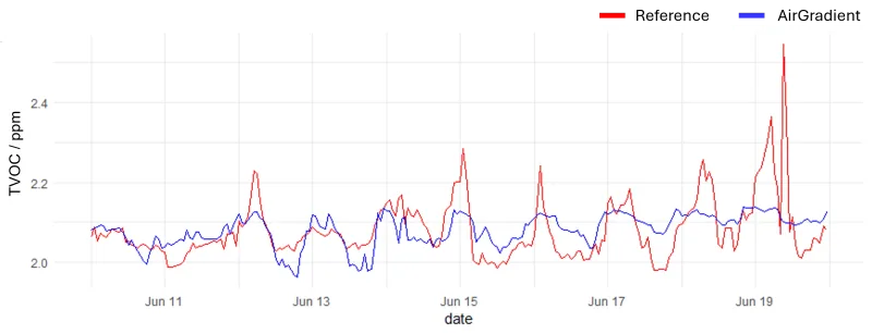

As a next step, we want to compare the sensor signal with that of a reference instrument. In the following, we show data that was collected at the Empa in Duebendorf.
accuracy total hydrocarb zue date mmta04tg hm572lf1
The time plot of the data reveals that while the sensor’s signal qualitatively tracks changes in the total VOC concentration -rising and falling in tandem with the reference - the amplitude of these changes does not match. This leads to a lower agreement between the sensor signal and reference instrument, which is reflected in a lower R squared value (0.27) and can also be seen in the not-so-linear shape of the dots in the scatter plot:

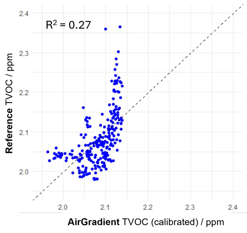

accuracy total hydrocarb zue tvoc cal m1 mmta053f 4j0cmk88
This discrepancy is likely due to the sensor’s varying sensitivity to different VOCs, as it does not respond uniformly across the diverse range of compounds that make up the total VOC concentration.
Bottom line: The TVOC sensor demonstrates the ability to detect qualitative changes in VOC concentrations, accurately capturing trends in rising or falling levels. However, it struggles to measure the magnitude of these changes with accuracy. This limitation arises from differences in sensitivity to specific VOC species, which prevent the sensor from fully aligning with the reference instrument’s quantitative readings. Despite this, the sensor remains a useful tool for applications where detecting general changes in air quality is sufficient.

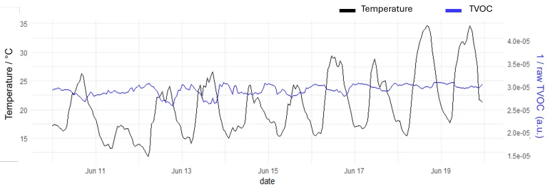

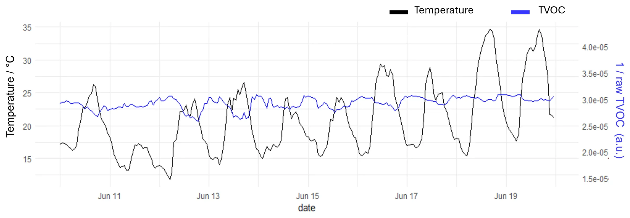

Low-cost TVOC sensors are often susceptible to interference from environmental factors such as temperature and humidity. To evaluate this, we examined the sensor’s performance under varying temperature conditions to determine if such interference affects its raw signal output.
temperature date mmta05f5 7mq8gz9c
To assess the potential impact of temperature, we compared the sensor's raw TVOC signal to the temperature it was exposed to. The results show no visible agreement between the two datasets, which is also confirmed by the scatterplot analysis.

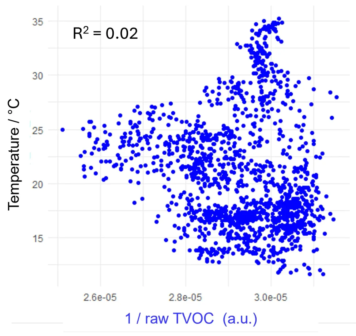

temperature tvoc raw inverted mmta05nj untqidrb
The scatterplot points are widely dispersed and do not form a clear linear pattern. This lack of correlation is quantified by an R-squared value of 0.02, which indicates essentially no relationship between the temperature and the TVOC signal. Again, for reference, an R-squared of 1 would represent perfect correlation, while an R-squared of 0 indicates no correlation.
Based on these findings, the TVOC sensor does not exhibit interference from temperature fluctuations within the tested range. However, this analysis is limited to a specific set of conditions. Further testing across different seasons and a broader range of temperatures would be necessary to confirm this behaviour under more extreme environmental conditions.

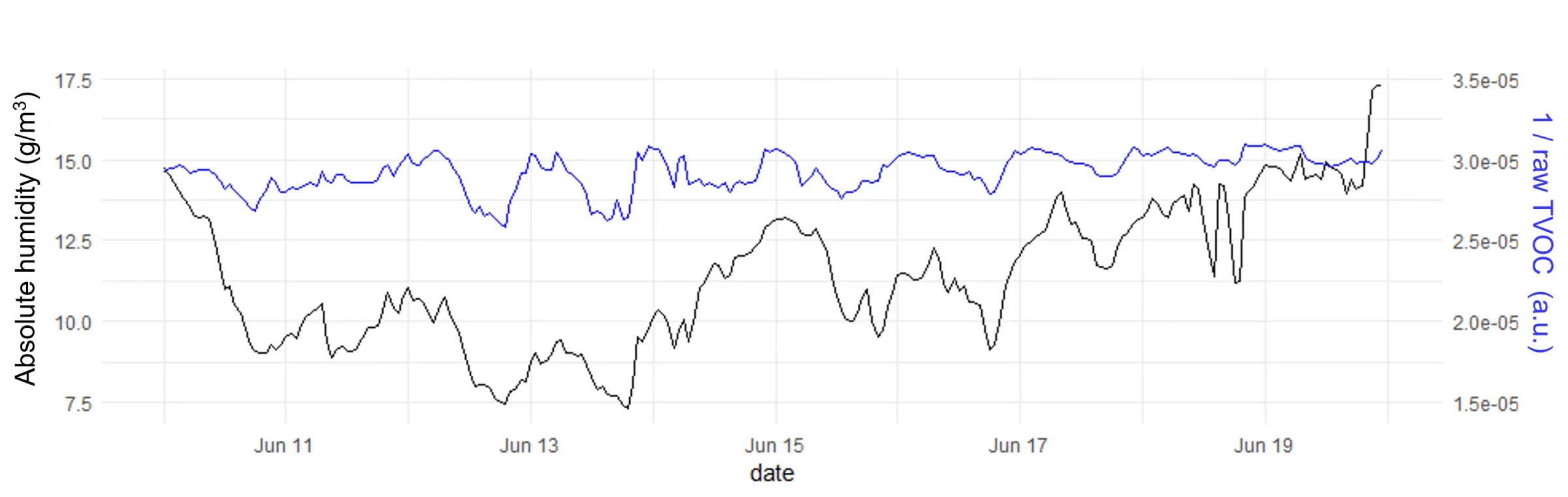

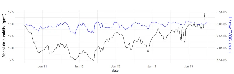

To investigate whether humidity influences the performance of a TVOC sensor, we compared the raw TVOC signal to the absolute humidity, measured as the amount of water (in grams) per cubic meter of air. This analysis aimed to determine if cross-sensitivity to humidity affects the sensor’s output.
humidity date mmta060a 9ag3hqh1

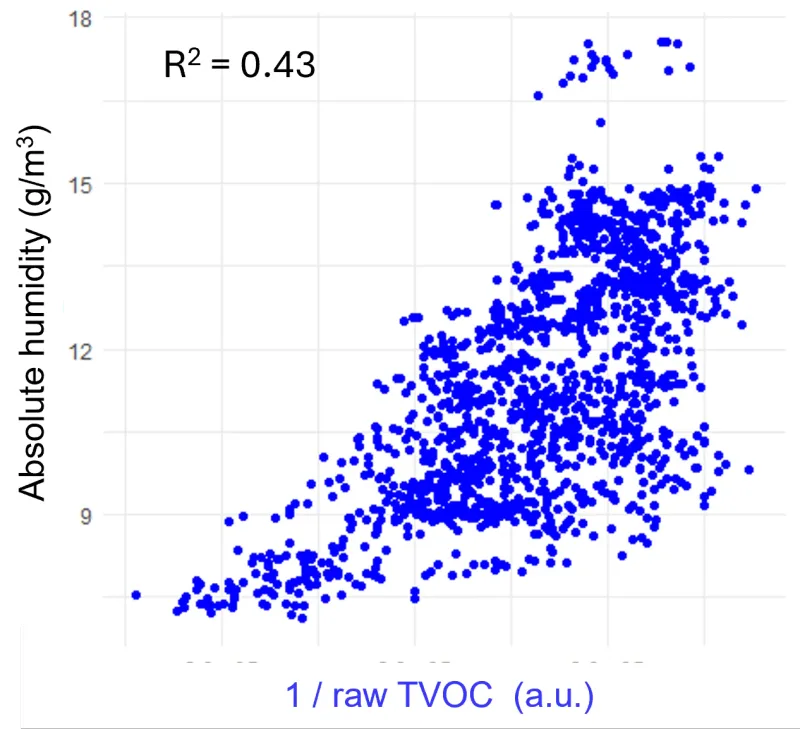

The comparison yielded an R-squared value of 0.43, indicating a moderate agreement between absolute humidity and the raw TVOC signal. This level of correlation suggests some relationship between the two variables. However, upon consulting with VOC experts from Empa, it became evident that this observed correlation is likely due to a genuine interaction between humidity and TVOC concentrations, as both meteorological factors and VOC levels in the air can be influenced by the same factors (e.g. boundary layer height).
humidity tvoc raw inverted mmta067j wa7lj1t8
If the sensor is cross-sensitive to humidity, adding humidity as a factor into the calibration should improve the accuracy of the sensor. We tested this here:
MODEL 1 MODEL 2
Calibration formula TVOC_cal = 1/TVOC_raw * scaling factor + intercept TVOC_cal = 1/TVOC_raw * scaling factor + humidity * humidity_correction_factor + intercept
RMSE 64 ppb 64 ppb
R2 0.27 0.27
As you can see with the R-squared value, the calibration model doesn’t improve even if we include humidity.
While there is some correlation between humidity and the raw TVOC signal, this relationship is likely due to a real correlation between humidity and VOC concentrations rather than the sensor being directly cross-sensitive to humidity. Furthermore, incorporating humidity into the calibration formula does not enhance the sensor's accuracy. Therefore, the impact of humidity on the sensor’s performance is not significant under the tested conditions.
