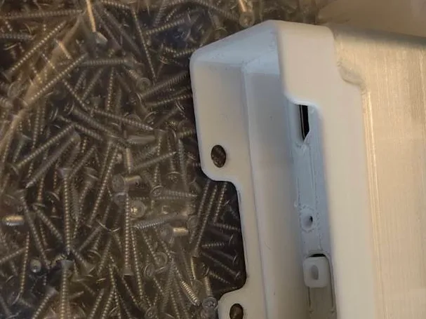

We just received a shipment of custom-made screws for the new AirGradient Go. Sounds like a tiny detail - but it’s one of those “hardware realities” that decides whether a product feels solid, serviceable, and long-lasting… or not.
Why we went custom
  • Quality: we wanted a countersunk head, torx drive, and stainless steel (we’re using 410), with a finish that holds up over time.
  • The exact length: we needed M1.8 x 15mm - not something you can reliably source in the consistency we want at scale.
  • Magnetic: 410 stainless is magnetic, which makes assembly with tiny screws a lot less annoying.
10000 screws for the AirGradient Go
