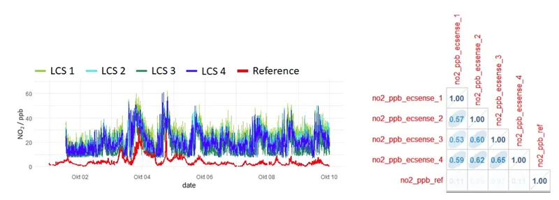

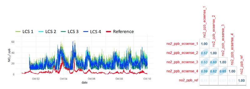

Real-World Testing
no2 chart mmtaafz9 4p7ybthm
To illustrate just some of these challenges, our science team recently ran some tests in collaboration with the University of Cambridge. When four identical electrochemical NO₂ sensors from EC Sense were tested straight out of the box against laboratory-grade reference equipment (Chemoluminescence, Thermo Fisher Scientific Model 42i), the results were shocking:
  • A relatively low signal-to-noise ratio - even with a time resolution of 5 minutes. This means the signal is significantly affected by unwanted interference or fluctuations (noise), reducing the accuracy and precision of measurements. This issue is particularly pronounced at lower concentrations, such as those typically found in ambient air.
  • A shift in the baseline and capping of lower readings at ca. 10 ppb (i.e. the sensor is not able to produce readings below 10 ppb (which might, however, be recovered through post-processing).
  • Poor correlation between the sensors’ NO₂ readings and the reference NO₂ measurements (R² values ranging from -0.1 to 0.23).
  • Stronger correlation with the reference Ox measurements (R² values between 0.44 and 0.56), suggesting significant cross-sensitivity to O₃.
For comparison, PM2.5 sensors tested in similar conditions showed near-perfect agreement with each other (R² of 0.97-0.98) and strong correlation with reference instruments. While PM sensors might overestimate absolute values, this is easily corrected with simple calibration.
