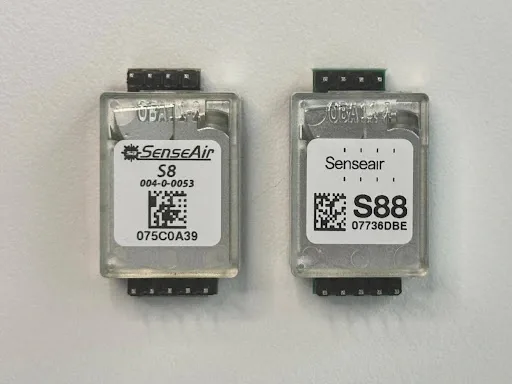

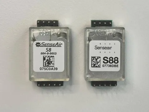

However, SenseAir recently released an updated version of the S8 which has adopted the name ‘S88’. We’ve chosen to gradually swap the sensors in our monitors over from the S8 to the newer S88 because the sensors are nearly identical in performance and SenseAir recommended that we upgrade to the S88.
S8 and S88

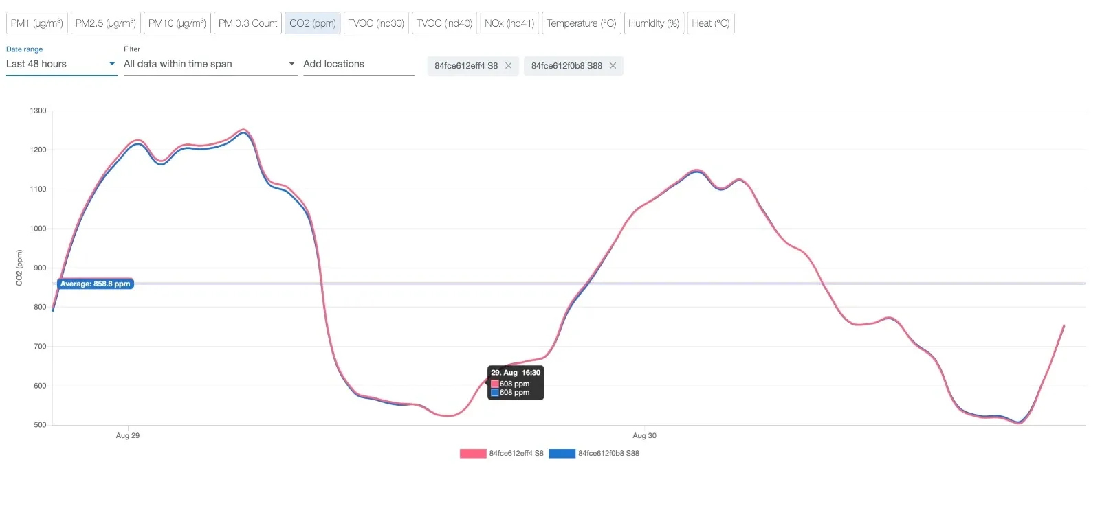

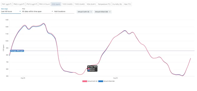

Comparison test with the S8
In this chart, you can see the S8 and S88 side by side and giving virtually the same numbers:
S8 and S88 Data Comparison Chart

The decision to move to the S88 was very simple for us because SenseAir has designed them to use the exact same form factor and firmware support. This means that the S88 is interchangeable with the S8 and will slot into our monitors exactly where the S8 used to. Over time, we will swap both the ONE and Open Air to the S88, but we will begin with the ONE before moving the Open Air to the S88 in the future.
So there will now be a transition period where your monitor might either be the S8 and S88 but due to the similarity we don’t believe this will be an issue.
