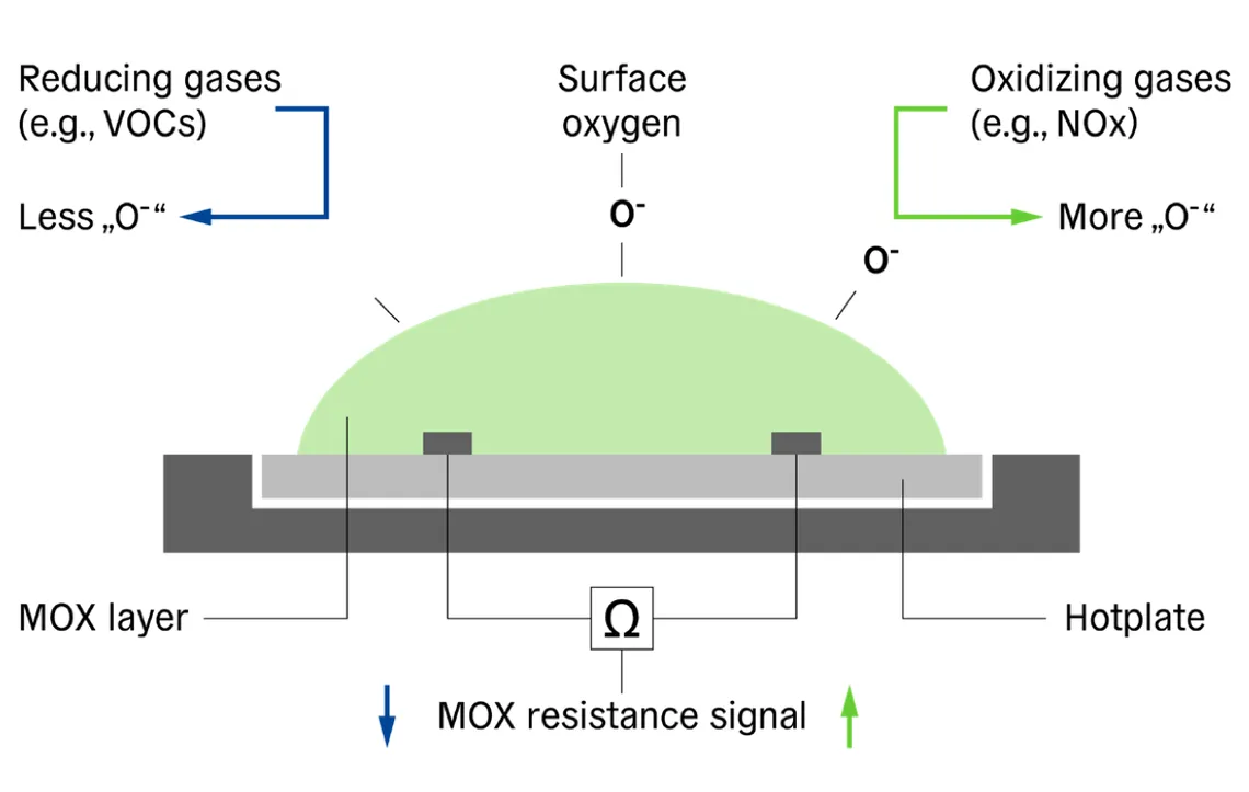

How Low-Cost VOC Sensors Actually Work (MOx Technology)
Most consumer-grade monitors use Metal-Oxide (MOx) sensors for TVOC detection. To understand their data, it is crucial to understand how they function.
A MOx sensor consists of a heated metal oxide surface that measures changes in electrical resistance as gas molecules interact with it. The sensor reacts based on the oxygen content on its surface:
From Sensirion: What is a metal oxide (MOX) sensor?
Because the sensor simply measures this change in resistance, it sees "activity," not specific compounds. Some VOCs like ethanol produce a strong response , while other VOCs like the harmful formaldehyde may produce weaker signals.
Because MOx sensors are broadband-reactive:
  • They detect patterns and spikes
  • They do not quantify VOCs
  • They do not distinguish harmful from harmless VOCs
  • They are best interpreted qualitatively

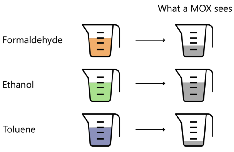

Why Measuring Absolute VOC Concentrations Using Low-Cost MOx sensors is Fundamentally Difficult
While this technology allows for affordable monitoring, it introduces four unavoidable limitations:
  1. Lack of Specificity: The sensor reacts to all detected gases at once. Seeing a high reading tells you nothing about the composition, source, or toxicity of the gas. It cannot distinguish between harmless cooking scents and harmful chemical off-gassing.
  2. Cross-Sensitivity: In the lab, these sensors are usually calibrated to a specific gas, such as ethanol. In the real world, they encounter unpredictable mixtures of acetone, isopropanol, and other chemicals. This creates signal discrepancies; for example, ethanol often produces a much stronger signal than formaldehyde, even if the formaldehyde is more dangerous.
From Sensirion: Compliance of Sensirion’s VOC Sensors with Building Standards

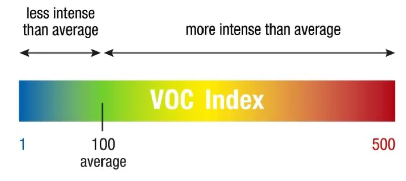

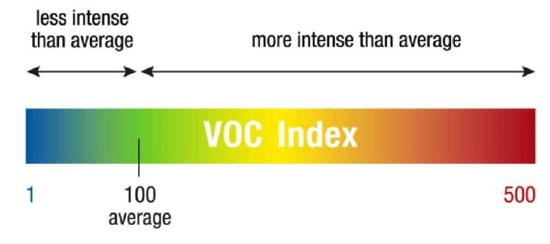

How the VOC Index Works
The sensors’ raw concentration output is processed using Sensirion’s Gas Index Algorithm. This results in an index-based measurement that focuses on relative changes, rather than absolute values.
The VOC Index describes the current status relative to the sensor’s recent history. To understand this approach, it helps to compare it to the human nose.
The "Nose" Analogy
When you walk into a room from outside, your nose uses the fresh outside air as a baseline (an offset). It immediately tells you if the room smells "stronger" or "cleaner" than that baseline. However, after you stay in the room, your nose adapts to the new smell, and it becomes your new "normal."
The VOC Index performs a similar calculation. It uses a moving average of the past 24 hours, called the "learning time", as its offset.
From Sensirion SGP41 Datasheet
  • 100 (Baseline): Represents the average VOC background of the room over the last 24 hours.
  • < 100: Indicates the air is cleaner than the recent average.
  • > 100: Indicates a rise in VOCs compared to the average.
How to Interpret the TVOC Index
RangeDescription
1 to 100A value below 100 indicates lower VOC levels compared to the past 24-hour average.
100Baseline. Represents the average VOC level over the past 24 hours. If the sensor shows 100, it means that the concentration hasn’t changed recently.
101 to 199Slight increase.
200 to 249Moderate increase.
250 to 349Significant increase.
350 to 500Severe increase.
