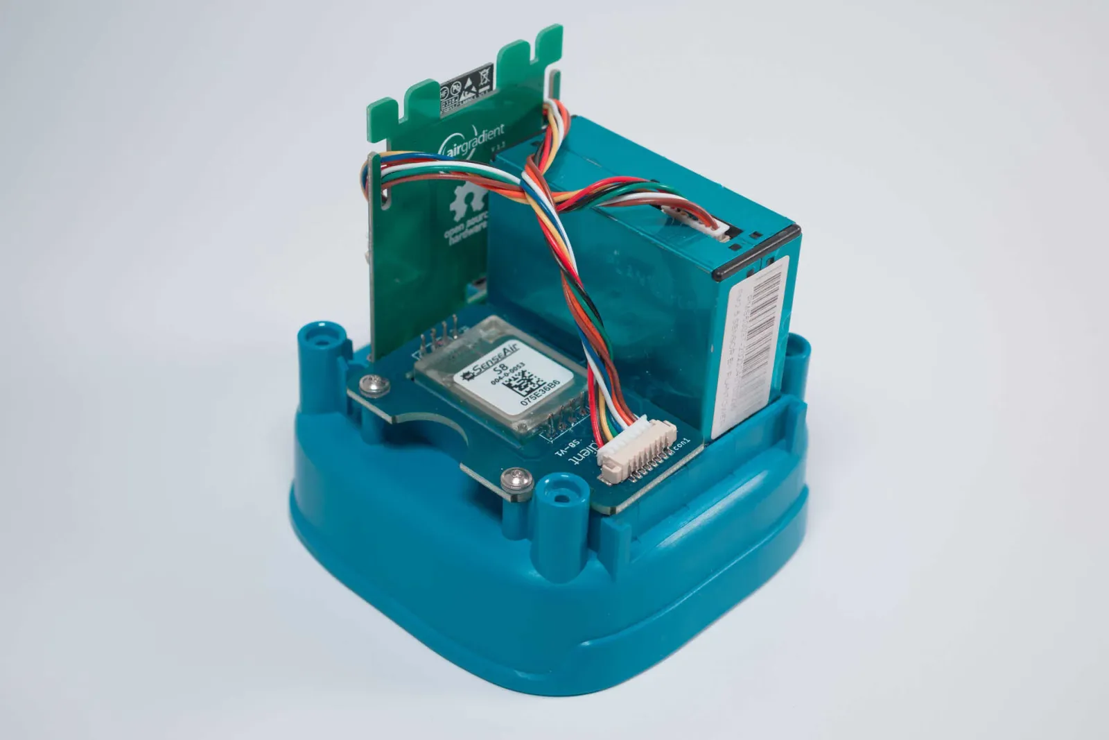

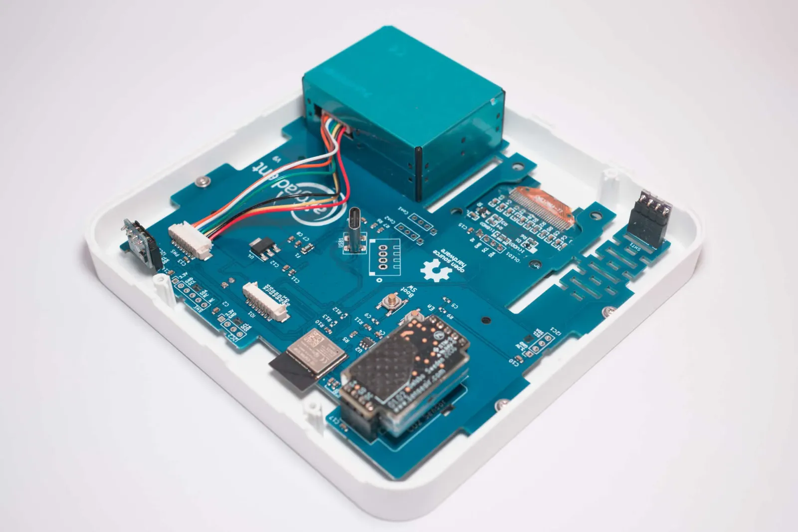

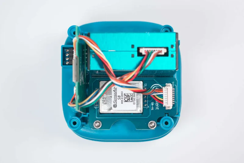

airgradient one internals mmta42v9 vq4pr5pd

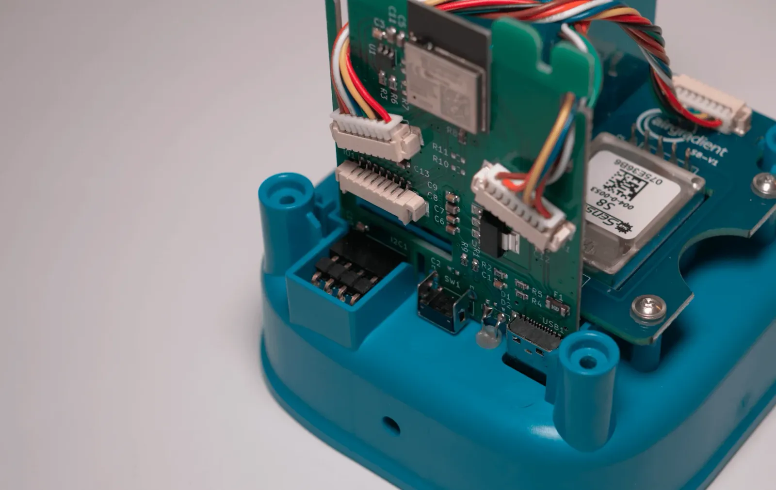

It’s important to note that air quality monitors incorporate pre-built sensors from other third-party companies in most situations. For example, our own AirGradient ONE indoor air quality monitor uses the following sensors:
PM sensor - Plantower PMS5003
CO2 sensor - Senseair S8
TVOC and NOx: Sensirion SGP41
Temperature and humidity: Sensirion SHT40
So, how do you find out which sensors a monitor uses? There are three ways. Firstly, you can contact the air quality monitor manufacturer; in most cases, the brand will readily answer the question. If a brand does not provide the sensors' models, you can research the monitor online or dismantle the monitor yourself, as these components will be labelled. If you don't want to put your monitor at risk, you can also check the brand’s name on the FCC database, which will return internal photos of the device.
It’s worth noting that many air quality monitor manufacturers use the same components, and, for example, you can find CO2 sensors from Senseair in everything from the AirGradient ONE to the Aranet4 Home. However, while the sensors may be the same, monitor manufacturers can employ different calibrations, which result in different readings. Additionally, the monitor's enclosure and internal design can impact the sensor modules' performance.

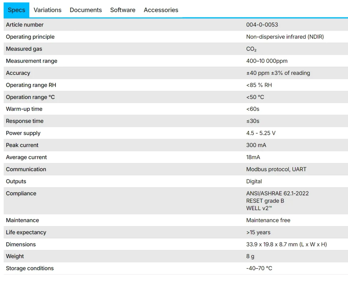

It’s important to know which sensors the monitor you are reviewing uses as a simple Google search for the term ‘sensor X accuracy’ often returns studies discussing performance against reference-grade equipment. These studies are a great way to get some background information on the sensors and are a great basis for any review.
In addition to looking at literature and studies on the sensor in question, you can also look at the sensor specifications, such as the manufacturer's stated accuracy and error. AirGradient monitors use sensors from Plantower, Senseair, and Sensirion, so you might visit these manufacturer websites and compare them to other similarly-priced options.
If searching for the sensor returns some overwhelming-looking studies, I’ve found that AI tools like ChatGPT can do a great job of summarising studies and making them more digestible. Just visit your favourite tool, give it the text and ask it to summarise the study's key findings. However, keep in mind that AI tools also make mistakes, so always verify key findings.
The South Coast Air Quality Management District (AQMD) and AIRLAB are two third-party organisations that do accuracy testing for some aspects of air quality monitors. These organisations can compare monitors to reference-grade equipment and provide public test reports on their respective websites.
Senseair S8 specifications

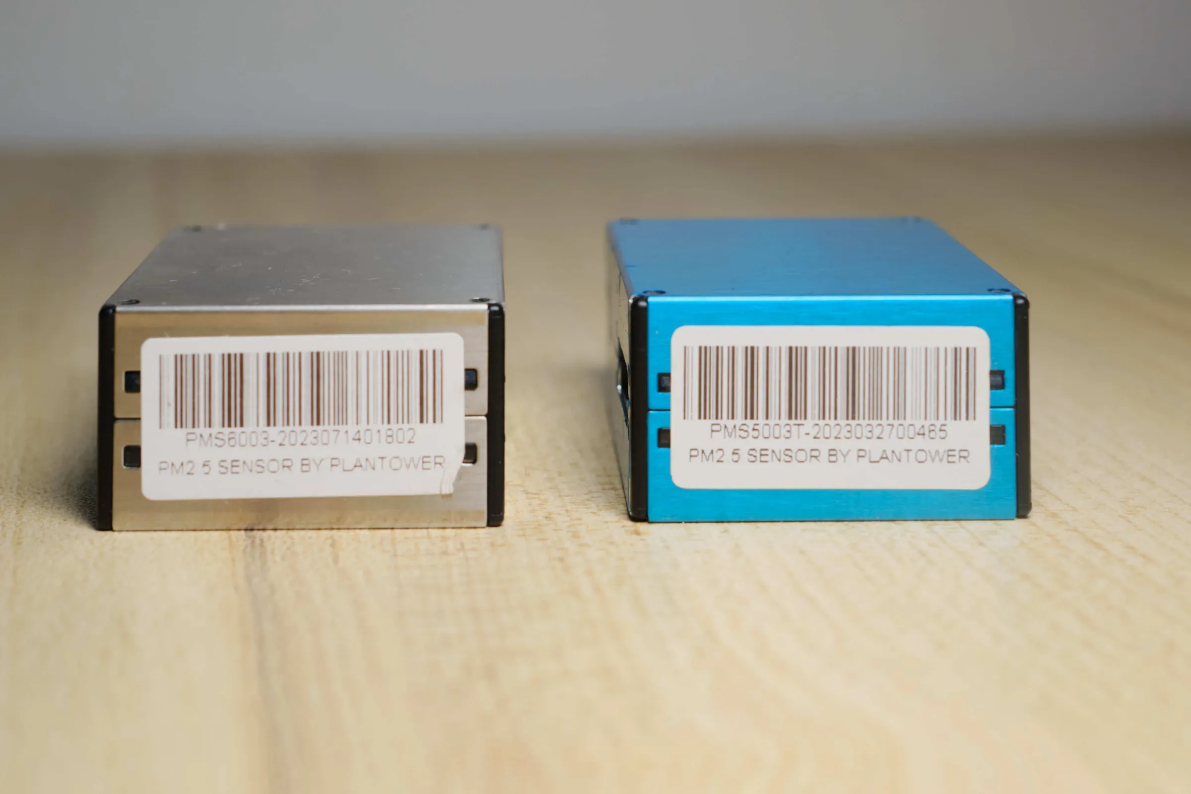

PM Sensor Guidelines
plantower sensors mmta43yy 1mhnz9se
The first sensor that you’ll want to look at is the PM sensor. Before diving into further details, it’s important to highlight one key point: The vast majority of low-cost sensors on the market only provide accurate readings for smaller particles such as PM2.5 and (in some cases) PM1.0. On the other hand, the PM10 readings from low-cost sensors often show poor to medium correlations with reference sensors.
What does this mean? Well, it leads to two key points.
  • Firstly, some readings, such as PM10 readings from low-cost sensors, are typically only useful for identifying trends, and the exact readings provided by consumer-grade air quality monitors typically have large errors.
  • Secondly, an air quality monitor uses the same sensor to provide all particulate matter (PM1.0 - PM10) readings. There are no separate sensors for each different classification of PM.

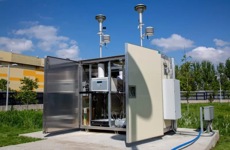

If you live in a large city or even in a smaller city in countries with good air quality monitor coverage, the chances are you have what we consider a ‘reference grade’ station relatively nearby. These air quality stations cost tens of thousands of dollars and are normally used by organisations and governments to monitor local air pollution. Typically, the data from these monitors can be accessed (downloaded) on a publicly available platform.
Reference-grade monitor. Photo from the U.S. embassy in Bishkek
For example, when I lived in Bangkok and Seoul, I could view the local air quality department’s website to see information from monitors less than 1km from my home. While any comparison with the distance involved will be imperfect due to local emission sources such as traffic exhaust or a woodburner down the road, we can use even a somewhat distant reference-grade monitor to identify ‘background pollution’.
This is pollution homogeneously distributed over a larger area and doesn’t include the short-term peaks caused by local pollution sources. To make this process easier, many reference monitors will state whether they measure background pollution, traffic, or otherwise. If possible, try to find a monitor that states it measures background pollution.
To get the best results, try to place the monitor(s) you are testing as far as possible from emission sources (away from streets, barbecues, etc) and collect data, ignoring any short-term peaks. Once you have some data from the monitor you are testing and the reference monitor, you can compare the background pollution, discounting short-term peaks.
It’s important to note that most government and organisation stations use 24-hour sampling periods, meaning they are slow to adjust as the reported concentrations are averaged over the past 24 hours. Some personal air quality monitors will also allow you to view average data over set periods such as 24 hours. You will also want to ensure you are comparing the same unit (µg/m³) and not AQI.
While readings will vary, the closer you can place your monitor to a reference-grade monitor, the better. But we also understand this is often not possible. Unfortunately, it’s hard to determine with certainty the accuracy of a particulate sensor, but comparing background pollution levels is a good step in the right direction.

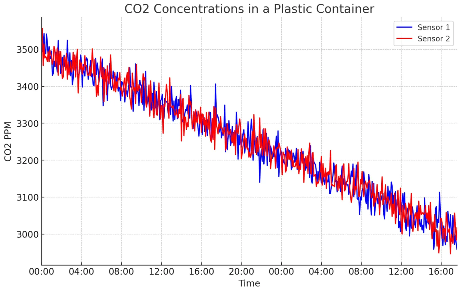

One good way to test the precision of carbon dioxide sensors is to leave the monitors you are testing in an unventilated bedroom overnight while you sleep. You should see the concentration spike during the night, which will likely be high. This will allow you to see if the inter-device precision drops at higher concentrations or remains consistent throughout.
Due to the relative uncertainty of CO2 sensors, the precision should remain similar, but accuracy will decrease at higher concentrations. For example, at 1000 ppm, we would expect to see all tested monitors with a stated accuracy of ± 30 ± 3% showing results between 940 ppm and 1060 ppm. However, at 10,000 ppm, we would expect to see results between 9670 ppm and 10,330 ppm.
Past this, or if you can’t compare the readings between multiple monitors, it’s worth researching online. Suppose the sensor comes from a major manufacturer such as Senseair, Sensirion, or Cubic. In that case, you will likely be able to find tens of studies comparing the accuracy of the monitors to reference-grade equipment and other sensors.
Accuracy
Another option is to use a known-accurate (for consumer-grade products) sensor as a baseline. Any sensor with a stated accuracy of 30 ppm ± 3% of reading should prove adequate for this task, and sensors like the Senseair S8, Senseair Sunrise and Sunset, and Sensirion SCD30 are accurate enough to be used for comparing other sensors. You can then apply the same statistical methods for the comparison as described for the PM sensors.
If you don’t have a known-accurate sensor, or if you’re curious about the performance of one of these sensors, another experiment you can try is to put the monitor(s) in an airtight container with a set CO2 concentration. Getting an exact concentration is impossible without reference gas, but you can exhale into the container to achieve a similar effect. Ideally, you’ll want to get the container to a concentration around 2000-3000ppm and then leave it sealed with the monitors inside.
This is an interesting way to test accuracy because, in theory, the CO2 concentration in the container should stay consistent until it is opened. Of course, the concentration will slowly decrease if there is even a very minor leak. Either way, since we know the concentration should remain constant or very close to it, we can see how much the sensor’s recordings deviate from that value throughout the experiment. I’ve run this experiment many times, and while some monitors will always be within 50 ppm of the expected concentration, some can deviate by 150 ppm or more.
co2 concentration graph mmta44s7 hungj03k
If you want to go deeper, you can expose your airtight container with the CO2 monitor inside to different conditions (e.g. change the temperature). Theoretically, the monitor should continue providing consistent (or near-consistent) readings if the manufacturer has accounted for these changes in conditions. However, some sensors are prone to temperature changes, so you might see differences in how the sensor performs under different conditions, which is an important consideration for accuracy.

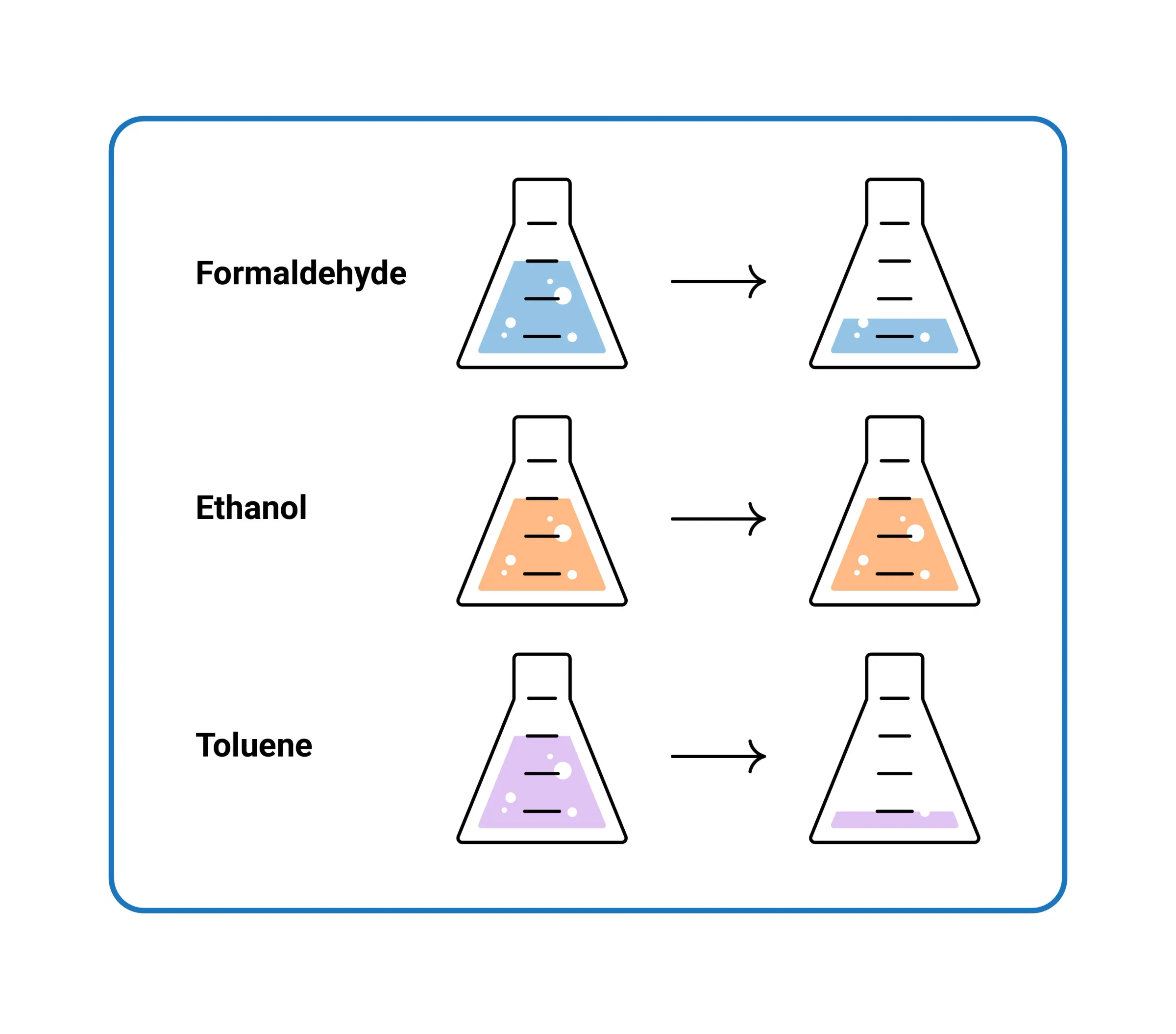

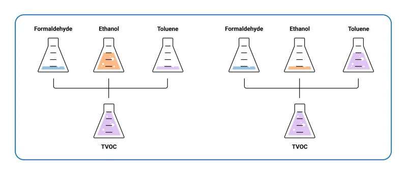

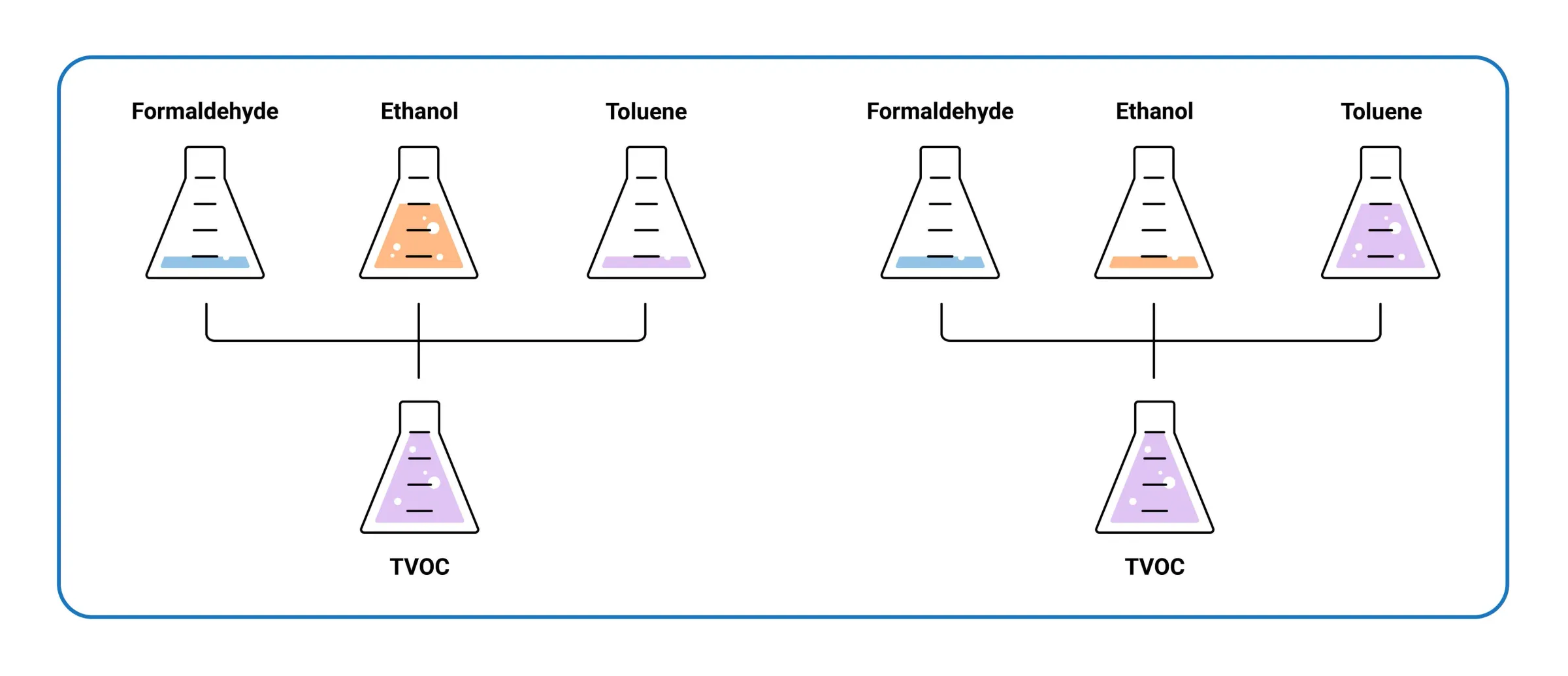

Volatile organic compound (VOC) sensors provide unique challenges as they are prone to error and are far less accurate than particle and carbon dioxide sensors. This is mostly because there are many types of VOCs, and each sensor has different sensitivities to certain gases. In other words, a VOC sensor may be more sensitive to ethanol than formaldehyde, but the latter is far more dangerous. This makes VOCs the most difficult parameter to measure in low-cost monitors, and it also makes it difficult to classify individual VOC sensors as good or bad.
On top of this, VOC sensors such as the Bosch BME688 and Sensirion SGP4X series (used in AirGradient monitors) show VOC values as an index by default and not as an absolute value (in parts per billion). This choice was made due to the issues mentioned above with absolute readings. The index features a quickly updating baseline. This means that any amount of VOCs in the room will be used as a reference (100%), and the sensor only detects changes in this amount.
In other words, the sensors that use these indexes are only useful for identifying trends in VOCs, such as increasing or decreasing levels, instead of absolute values. Even if an air quality monitor shows absolute values, it’s important to note that they shouldn’t be relied on due to the sensitivities of sensors to different VOCs (and the fact that we never know the exact composition of VOCs in our air).

While VOC sensors are inherently not very accurate (unless you know the exact composition of VOCs being measured, which is never the case unless you have very large and specific measurement equipment), there are some interesting experiments we can do to at least see if they react in the way we expect.
For one of these experiments, you will want to have some different liquid VOC sources like alcohol, acetone or paint thinner. Measure out specific amounts (start small) and then dilute these with water. Now, place the sensor(s) in a stable, enclosed container (to minimise external influences) and introduce the VOC source at a distance from the sensor. Mark this distance as you will want to keep it consistent for upcoming tests.
Record the readings to see how they react to this diluted VOC source being introduced. After the readings have settled down and remain somewhat consistent, you can change the concentration of the VOC source (ensuring it’s placed the same distance from the monitor every time and, ideally, at a relatively stable temperature) and repeat the experiment. If you double the concentration of the VOC source, we would expect the monitor to record roughly double the concentration, too - the same goes for every other concentration change you make.
When running this experiment, try to switch to absolute readings such as ppb (parts per billion) if possible. If the sensor only has an index function, you will see an increase in VOC concentration as you double the concentration of the VOC source, but it won’t double as it would in absolute readings.
You can repeat this experiment with different VOC sources to see exactly how the air quality monitor reacts to different sources and, therefore, different VOC compositions. While this experiment is very rough, it’s fascinating to see how the monitors react and provide some insight into how they perform.
It will also tell you other characteristics of the sensor, such as its response time and, in some cases, even what it is more susceptible to. That said, you can generally also find this information in the sensor's spec sheet, including what it is more and less susceptible to.
