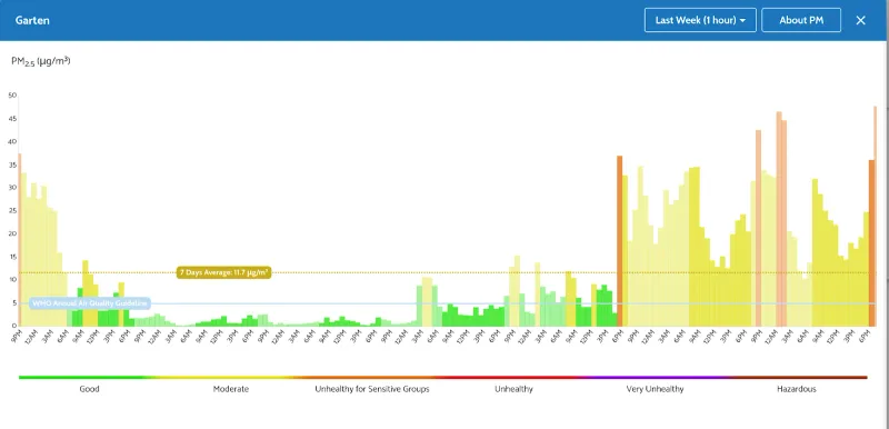

Not only because collecting metric data is fun, but also because I want meaningful data about my external ambient air, an outdoor sensor, the Airgradient Open Air, has now been put into operation. It basically delivers the same data as the indoor sensor, but it is weatherproof and, therefore, intended for continuous operation outdoors. It also has no display and, unfortunately, does not tell the user anything about the condition of the air from the immediate environment when only looking at the sensor. However, Airgradient offers a very nicely presented dashboard that prepares and graphically displays the data.
Here is a representation of the fine particles in the ambient air over the last week. It is relatively easy to see that in colder weather, people heat more strongly and, accordingly, the outside air is more polluted. In addition to the particle graphs, there are others available for the other sensors mentioned above.

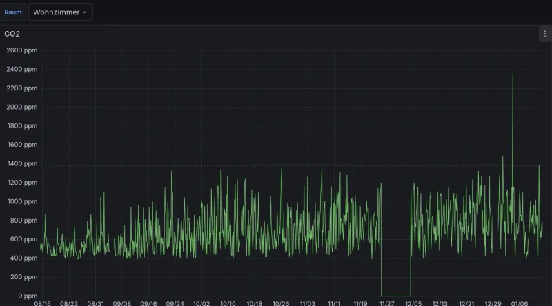

graph co2 mmt98vdi awa0ev3i
In July there was a disruption.

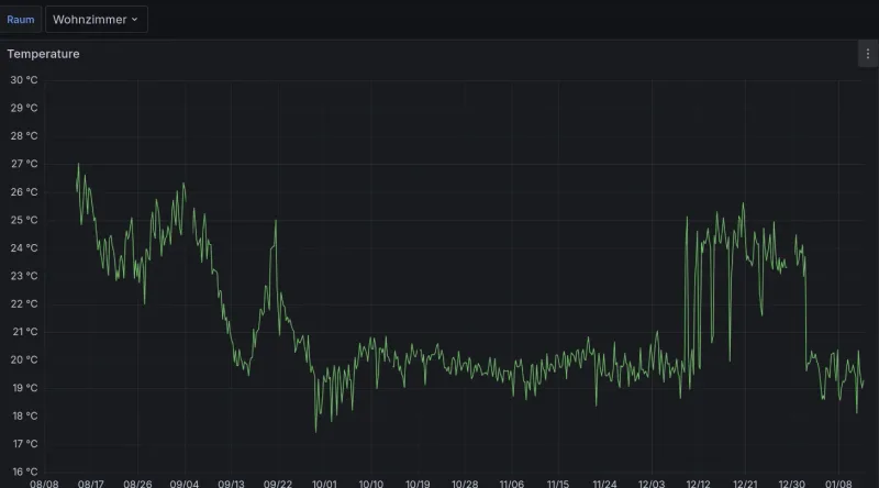

graph temperature mmt98vrb z4c1rm60

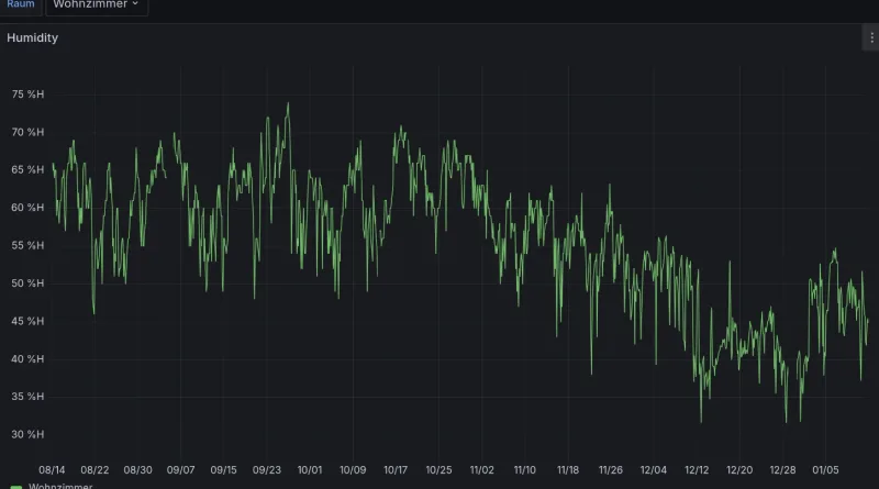

graph humidity mmt98vzk ryn7mln0

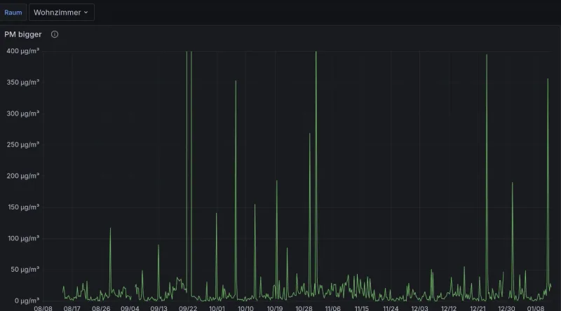

While some events such as cooking or burning candles can negatively change the fine particles in the air, the CO2 concentration fluctuates the most. This can negatively affect well-being in various ways. Concentration problems are just one of the known side effects.
All the more helpful that you can be supported by this so far very reliable sensor to ventilate more often, for example. It is clear: Without the sensor, we would have ventilated significantly less often, especially in winter. We are very satisfied with the purchase and the result.
