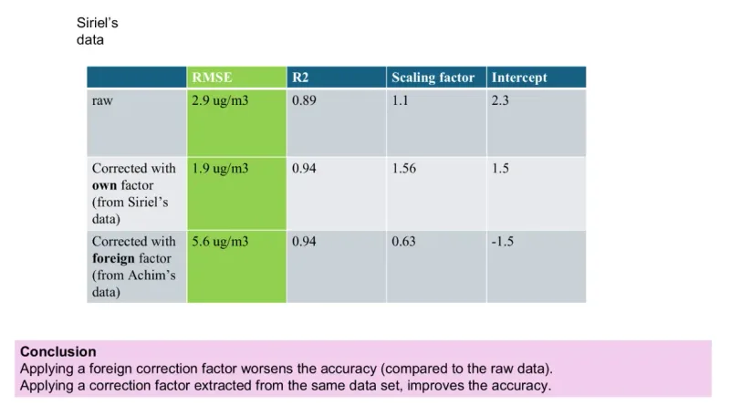

pms5003 data table mmtacv56 xmpc4kt9
A table showing raw data and the improved R-squared value with correction factors applied. For the full context and explanation behind this table, please refer to our previous article on the topic.
