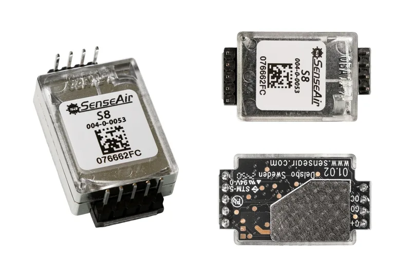

CO2 sensors rely on an internal algorithm called Automatic Baseline Correction (ABC) to maintain calibration.
How ABC Works
CO2 sensors naturally drift over time. ABC compensates for this by making a key assumption:
At some point during each cycle, the sensor will be exposed to fresh outdoor air (~400 ppm).
  • The sensor records readings over a defined period (e.g. over an 8 day period by default, this period can be changed in the dashboard, Dashboard > Locations > Admin > Edit Calibration > CO2 > Set ABC Duration)
  • It identifies the lowest reading during that period
  • That value is assumed to represent fresh air
  • The sensor adjusts its baseline so that value equals ~400 ppm
