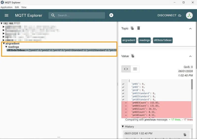

Your monitor will immediately apply the settings and begin broadcasting to your local MQTT broker (you may need to wait for a few minutes until you see the readings sent under MQTT topic airgradient/readings/serial_number.
You can check with a tool like MQTT Explorer if you'd like (not required).
