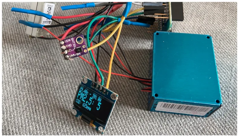

You can also get the components working without the PCB just by soldering the sensor modules with wires directly to the D1 Mini.
Monitor built without PCB
However, we strongly recommend you assemble the monitor with a PCB as it will be much easier and more robust.

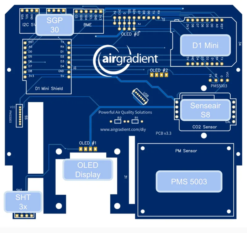

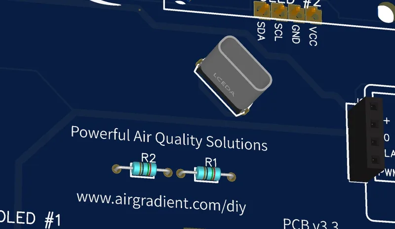

Now that you have the firmware flashed, you can solder the components onto the PCB. Make sure you solder the pins in the correct direction.
Location of the Components on the PCB

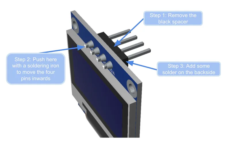

OLED Display Soldering
To fit the OLED display perfectly into the enclosure, the pins need to be adjusted because they reach out too far. Please follow these three steps:
  1. Remove the black spacer with a small screwdriver or with a small pair of pliers (see Step 1 in the figure below)
  2. Take the hot soldering iron and push the pins inwards so that they do not stand out too much anymore (see Step 2)
  3. To ensure that the pins still have strong contact with the display, add some solder on the backside around the pins (see Step 3)
Steps to adjust the Display Pins

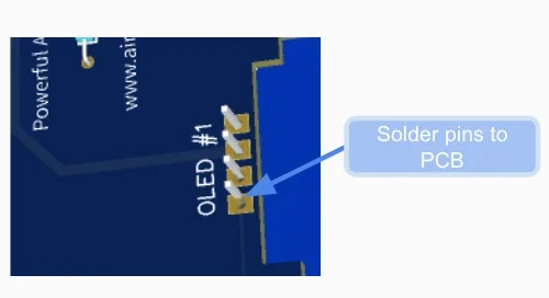

  1. Put the OLED display through the PCB and mount it into the enclosure. Make sure you tighten all four screws of the PCB. Move the OLED so that it is correctly aligned and use tape to temporarily fix it in place.
  2. From the opposite side, check that the display is properly aligned.
  3. Solder the display as quickly as possible to prevent damage to the enclosure (melting or deformation from the soldering heat). Put the soldering iron at the lowest temperature that still ensures proper contact. After the soldering is done, immediately use a fan to cool down the solder points as fast as possible.
  4. Clip off the outstanding pins and carefully remove the tape without damaging the display cable.
Soldering the OLED Display onto the PCB

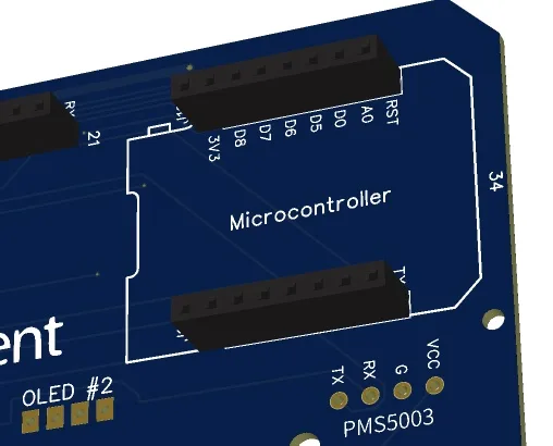

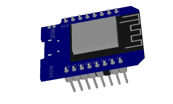

D1 Mini Soldering
We recommend to solder all components with pin sockets so that it is easier to replace components or troubleshoot if something does not work.
Important: If you solder the D1 directly on the board, leave enough space between the D1 and the PCB so that you can plug in the USB cable.
First solder the female pin headers onto the PCB where it says: "Microcontroller".
Pin Sockets on PCB
Pin Sockets on PCB
Then solder the male pins onto the D1 Mini.
D1 Mini soldering
D1 Mini soldering
Then you can put the D1 Mini onto the PCB. Make sure that the orientation is correct and that all pins go into the socket.

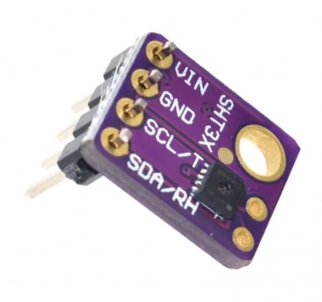

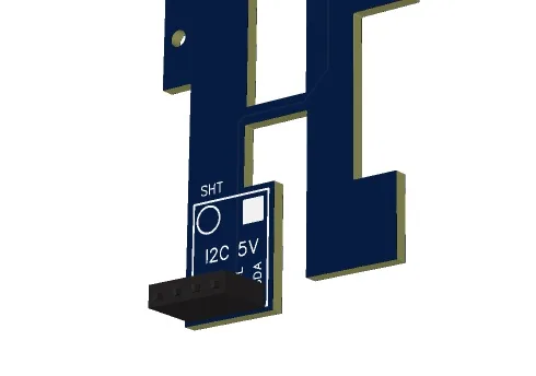

Soldering The SHT31 Module (Temperature and Humidity)
To solder the small pins onto the SHT31 module, you can use a breadboard to fix the pins into place. No need to do anything with the two pins on the top of the sensor. Only solder the four pins at the bottom of the module.
Soldering Pins onto the SHT Module
Then solder female pin headers onto the board. The SHT is located at the far isolated corner of the PCB to help ensure accurate temperature measurement.
SHT placement with pin sockets
Then put the SHT31 module onto the pin socket and make sure you have it on in the correct direction.

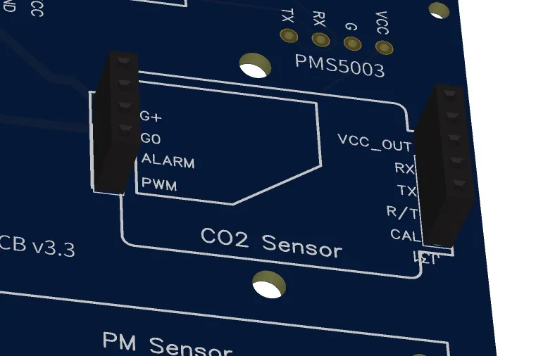

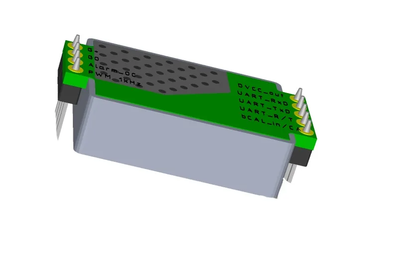

Soldering The Senseair S8 Module (CO2 Sensor)
To solder the small pins onto the S8 module, you can use a breadboard to fix the pins into place.
Make sure that the pins face upwards as can be seen on below image.
Important: Compared to the smaller DIY Basic kit, the pins here are soldered the opposite way to enhance the accuracy and airflow around the sensor.
Senseair S8 pin header soldering
Solder female pin headers onto the PCB. Then put the S8 onto the pin headers.
Female pin headers soldering for the Senseair S8

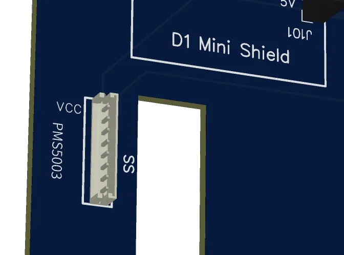

Connecting The PMS5003 (PMS Sensor) Cable
The PMS Sensor is connected with a cable to the PCB. There are two ways to connect it. If you can solder the small JST connector, then solder it on the board:
PMS JST Connector
PMS JST Connector
Make sure it is soldered in the correct way (as indicated with the silkscreen and can be seen in the image above).
