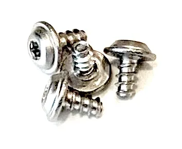

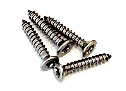

Screws for Enclosure Enclosure: M1.8x10 (Torx M6)
Screws for PCB M2*4.5 (Torx M6)
Screws for PM Sensor M2*4.5 (Torx M6). Same screws as for PCB.

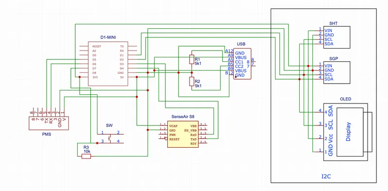

Schematics
You can use the following schematics:
The schematics of PCB v 3.7. PCB v 4.2 only change is that the push button pulls to ground and does not need a pull down resistor as the D1 has an integrated one.

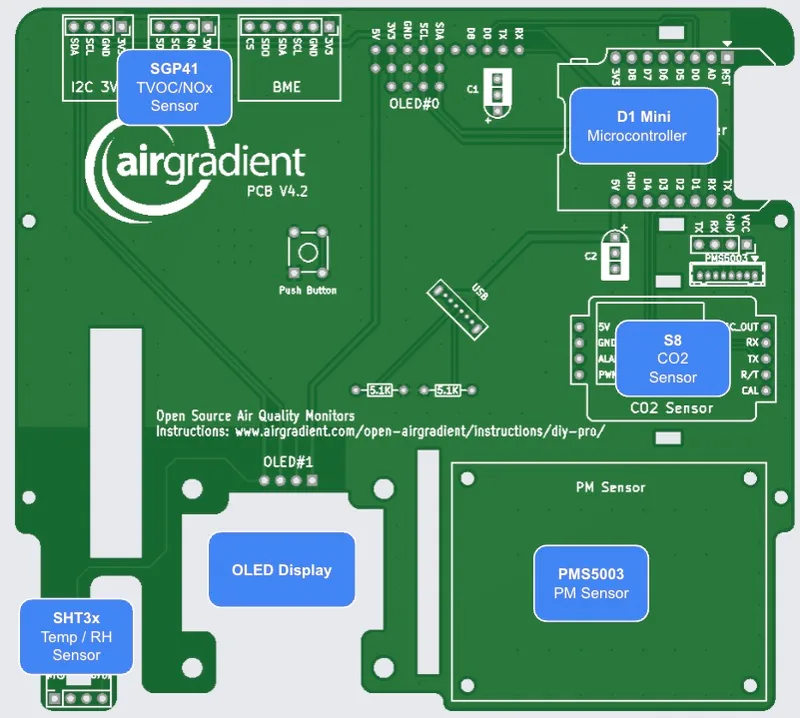

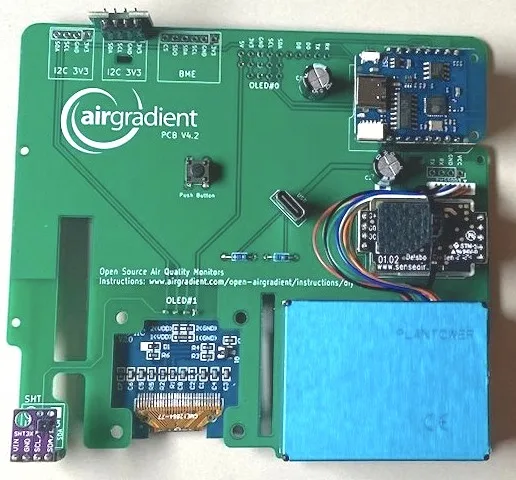

Now that you have the firmware flashed, you can solder the components onto the PCB. Make sure you solder the pins in the correct direction. The PCB might come in green or black color but are functionally identical.
Location of the Components on the PCB
Picture of fully assembled board

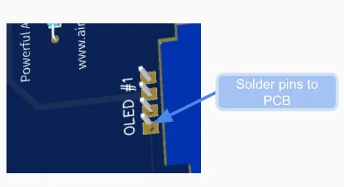

OLED Display Soldering

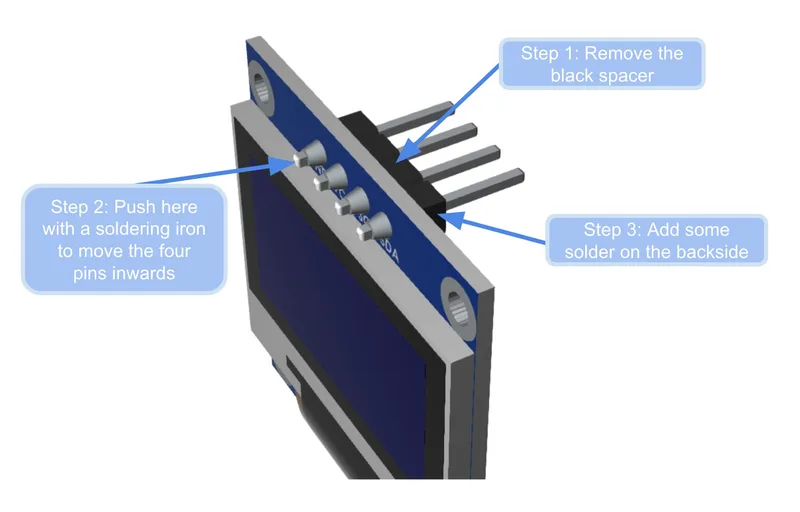

To fit the OLED display perfectly into the enclosure, the pins need to be adjusted because they reach out too far. Please follow these three steps:
  1. Remove the black spacer with a small screwdriver or with a small pair of pliers (see Step 1 in the figure below)
  2. Take the hot soldering iron and push the pins inwards so that they do not stand out too much anymore (see Step 2)
  3. To ensure that the pins still have strong contact with the display, add some solder on the backside around the pins (see Step 3)
Steps to adjust the Display Pins
  1. Put the OLED display through the PCB and mount it into the enclosure. Make sure you tighten all four screws of the PCB. Move the OLED so that it is correctly aligned and use tape to temporarily fix it in place. Most of our enclosures have the display cutout on the bottom right. Make sure you solder the OLED display into the slot called OLED #1 (in case you have an older enclosure with the cutout on the top left, then use the slot called OLED #0).
  2. From the opposite side, check that the display is properly aligned.
  3. Solder the display as quickly as possible to prevent damage to the enclosure (melting or deformation from the soldering heat). Put the soldering iron at the lowest temperature that still ensures proper contact. After the soldering is done, immediately use a fan to cool down the solder points as fast as possible.
  4. Clip off the outstanding pins and carefully remove the tape without damaging the display cable.
Soldering the OLED Display onto the PCB

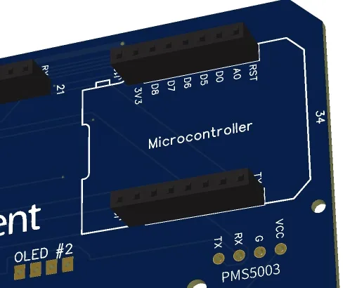

First solder the female pin headers onto the PCB where it says: "Microcontroller".
Pin Sockets on PCB
Pin Sockets on PCB

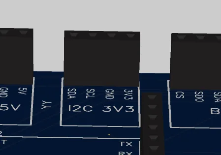

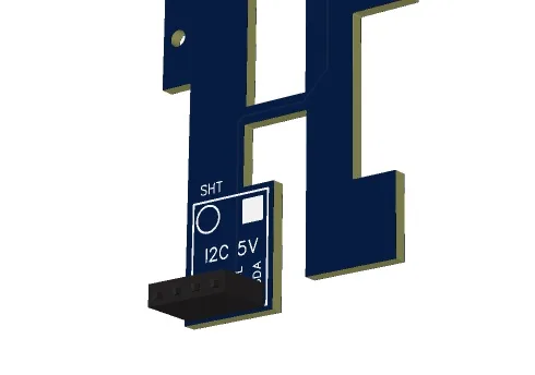

Soldering The SHT31 Module (Temperature and Humidity)
To solder the small pins onto the SHT31 module, you can use a breadboard to fix the pins into place. No need to do anything with the two pins on the top of the sensor. Only solder the four pins at the bottom of the module.
Soldering Pins onto the SHT Module
Then solder female pin headers onto the board. The SHT is located at the far isolated corner of the PCB to help ensure accurate temperature measurement.
SHT placement with pin sockets
Then put the SHT31 module onto the pin socket and make sure you have it match the form printed on the PCB. This means that the pins should align the following:
SHT PCB Label SHT Module Label
3v3 VIN
GND GND
SCL SCL
SDA SDA

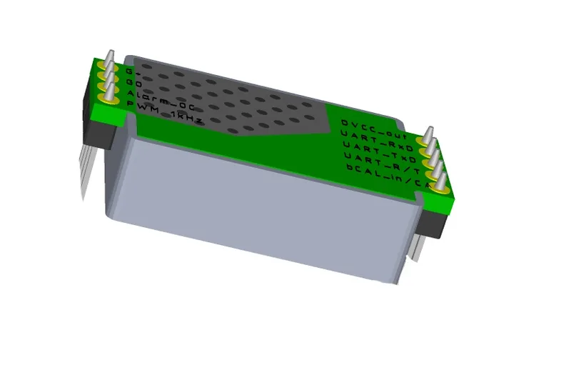

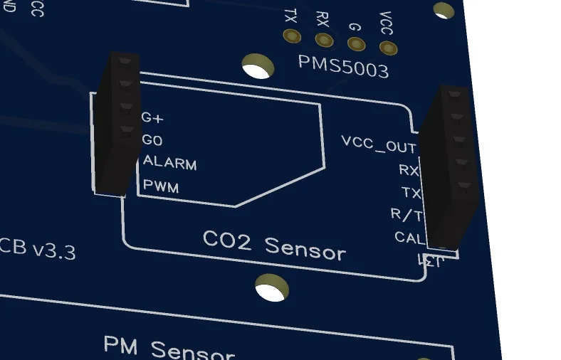

Soldering The Senseair S8 Module (CO2 Sensor)
To solder the small pins onto the S8 module, you can use a breadboard to fix the pins into place.
Make sure that the pins face upwards as can be seen on below image.
Important: Compared to the smaller DIY Basic kit, the pins here are soldered the opposite way to enhance the accuracy and airflow around the sensor.
Senseair S8 pin header soldering
Solder female pin headers onto the PCB. Then put the S8 onto the pin headers.
Female pin headers soldering for the Senseair S8

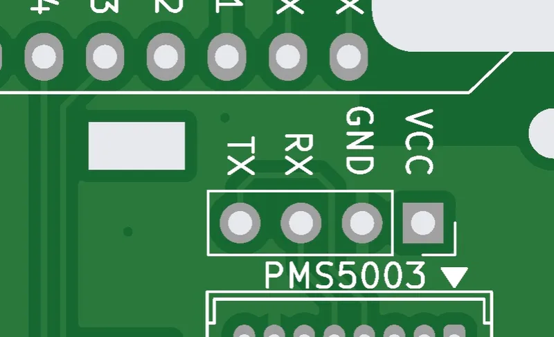

Connecting The PMS5003 (PMS Sensor) Cable
The PMS Sensor is connected with a cable to the PCB.
Please note that from PCB Version 4.2 a smaller cross-over cable is required. The red-black cable often coming with the PMS sensor is not a cross-over cable and it will not work with the JST plug. In case you have the wrong cable, you can splice it and solder it into the through holes provided (see below).
There are two ways to connect it. If you can solder the small JST connector, then solder it on the board:
PMS JST Connector
PMS JST Connector
Make sure it is soldered in the correct way (as indicated with the silkscreen and can be seen in the image above).

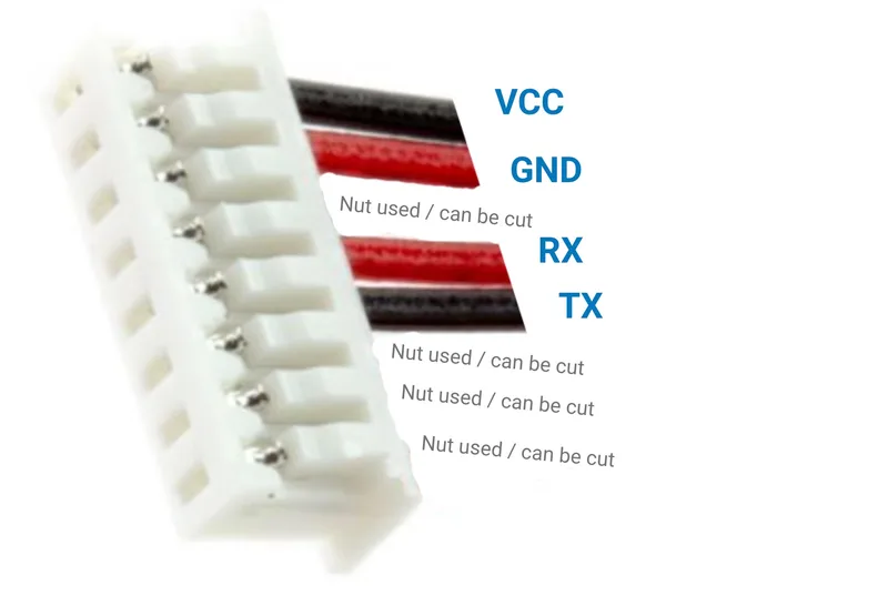

In case you cannot solder these small pins or do not have a cross-over cable, you can also cut and splice the cable and solder it directly onto the PCB.
Prepare the following four wires as per this image. Please make sure you cut the correct wires.
PMS Cable Wiring
PMS Cable Wiring
NOTE: It can be confusing that the default cable of the PMS has a black cable for VCC as normally VCC uses red color.
Solder the cable onto the PCB. Please make sure that you solder the correct cable to the correct pin.
PMS PCB Connection
PMS PCB Connection
After you have soldered the cable onto the PCB, connect the PMS5003 with the other end of the cable.
Then screw the PMS5003 onto the PCB. The PMS modules fan should face the edge of the enclosure so that it can draw in air easily from the outside.
You have two different types of screws in the kit. Use the smaller screws for the PMS sensor and also for screwing the PCB into the enclosure. The larger screws are for closing the two enclosure parts.

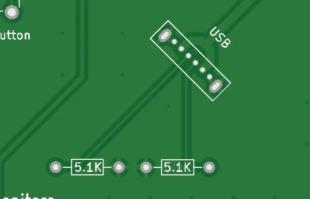

USB-C Connector
If you are confident with soldering the small pads, you can solder the USB-C connector onto the board.
USB C Connector and Resistors
Note that you cannot flash the device through this USB-C port. It only provides power. To flash the D1, you need to connect the cable directly to the MCU.
If you want to use the monitor with smart power adapters (e.g. ones providing a range of voltages), you need to also solder two 5.1k resistors onto the board. If you just want to use a normal 5V power adapter you do not need to do this.
Alternatively, you can use the bigger hole on the back of the enclosure to feed the cable in and connect it directly to the D1. Then you do not need to solder the USB-C connector. Please note that only a straight USB-C cable fits through the hole. So if you get the 90-degree cable from our kit but do NOT want to solder the USB-C connector, you either need to make the hole larger or get a straight USB-C cable.

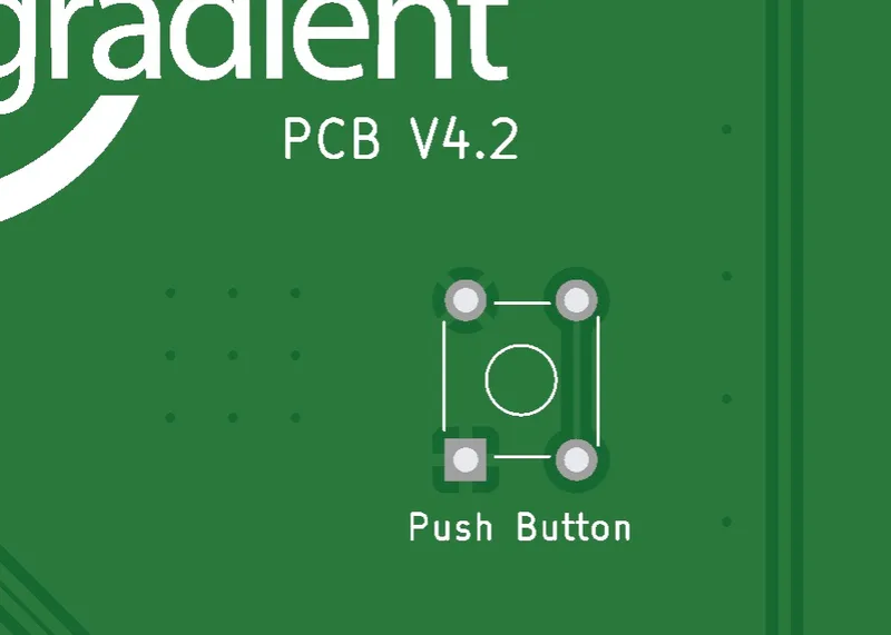

Button
It is important that you solder the button so that you can use our software and are able to switch different configurations (e.g. Fahrenheit, Celcius etc.).
Push Button
Push Button

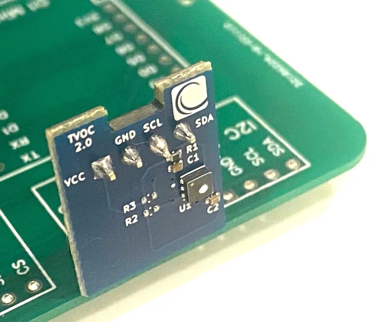

Optional SGP41 AirGradient TVOC / NOx Module
If you purchased the AirGradient TVOC / NOx module, you can solder female pin headers onto one of the top I2C slots and plug the module in there.
Slot for AirGradient TVOC / NOx Module
Please make sure you mount the module in the correct orientation. The sensor needs to face outwards.
Please note that if you want to use some 3rd party TVOC modules, you might need to remove the pull-up resistors as the I2C bus already has the SHT and OLED module which both already have pull ups. We strongly recommend you use the AirGradient module which does not have pull-up resistors.

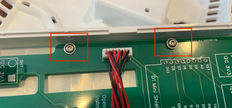

If everything works, you can screw the PCB into the top cover of the enclosure and close the enclosure.
Screws for PCB
Screws for PCB
Then screw them on both sides (each 2 screws).

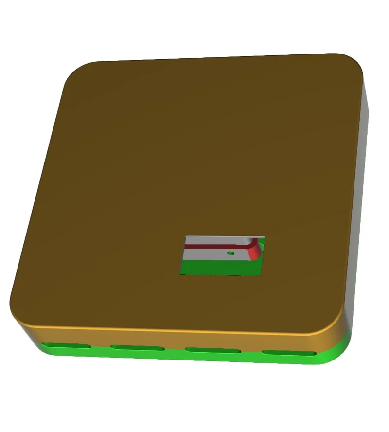

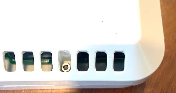

Once the PCB is firmly screwed on the top part of the enclosure, you can close the enclosure with the longer screws.
Screws for enclosure
The enclosure screws are going on the four sides into the ventilation vents:
Location for enclosure screws

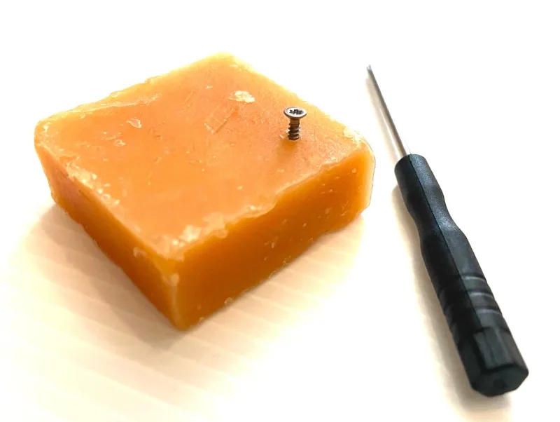

Please note that the mini screwdriver enclosed with the kit might not have enough torque to screw these screws in. In that case, please use a larger T6 screwdriver, or you can also put some oil/soap on the screws to make them go in easier.
Soap helps getting the screws into the enclosure in case you use the mini screwdriver

3D Enclosure
You can download STL 3D printer files to print an enclosure that exactly fits the PCB. The 3D enclosure consists of three parts: a top, a bottom and a back cable connection part. The ZIP file also contains the STEP file so that you can make adjustments.
Download Enclosure STL Files
If you do not want to print, our DIY PRO Kit includes a high-quality UV-resistant injection molded plastic enclosure.
3D printable PRO enclosure
