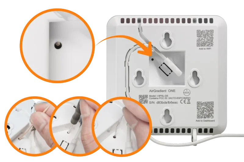

You can perform a factory reset by pressing and holding the BOOT button on the back of the device for about 10 seconds.

Alt text
A countdown will show up on the screen.
Alt text
Alt text
