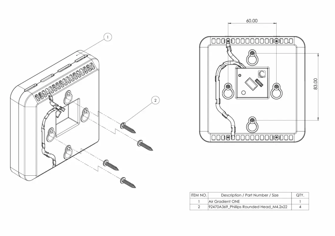

The AirGradient ONE comes with multiple mounting and cable-management options, making it a flexible air quality monitor that can be mounted on a wall or sat on a desk (using the included feet).
The four holes located on the top, bottom, left and right of the device allow it to be mounted on a wall via a M4 screw or screws. These holes align with U.S. and EU junction boxes. While the device will be secure with just one screw at the top of the monitor, it can easily be tilted or turned off-axis, so we recommend using the left and right mounting holes if possible, preventing any movement of the device.

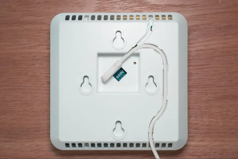

If you want a temporary installation or prefer to have the monitor on a desk or shelf, we also include two plastic feet that can be slid into the vents at the bottom of the device. These feet allow you to stand the monitor on any flat surface easily.
While it depends on the installation, we generally recommend routing the cable downwards through the channel on the back of the device if using the included feet. If mounted on a wall, you can either use the top or bottom channel, depending on your setup.
It’s important to note that while any USB Type-C cable can be used with this device, only the included 2-metre 90-degree Type-C cable allows it to sit flush with a wall or any other surface it’s mounted on. Also, please note that the AirGradient ONE does not come with a USB adapter. You will need a USB A 2A 5v adapter to power this device.
