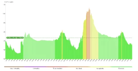

  • This will show you your data for the different air quality measurements, you can click on any of them to see historical data like this:
chart

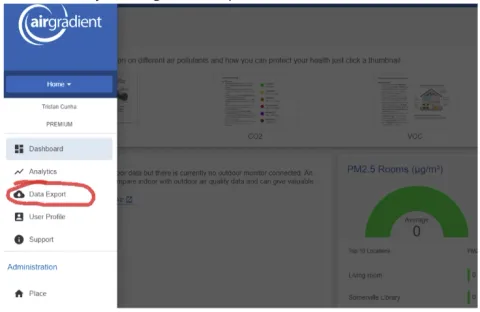

  • If you want to download your data before returning the air quality monitor to the library, you can access it from the menu in the top left of the dashboard by clicking “Data export”
export

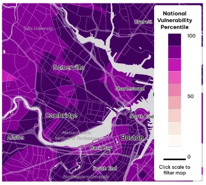

According to the Environmental Defense Fund’s (EDF) Climate Vulnerability Index, many of Somerville’s communities are exposed to high levels of air pollution that harm our bodies. Figure 1 maps the exposure and risk intensity, notice that much of the intense exposure and risk areas occur by the highway. This is important to note for Sommerville communities because it is estimated that approximately 10% of pediatric asthma cases are attributable to road traffic pollution.
somerville aq
