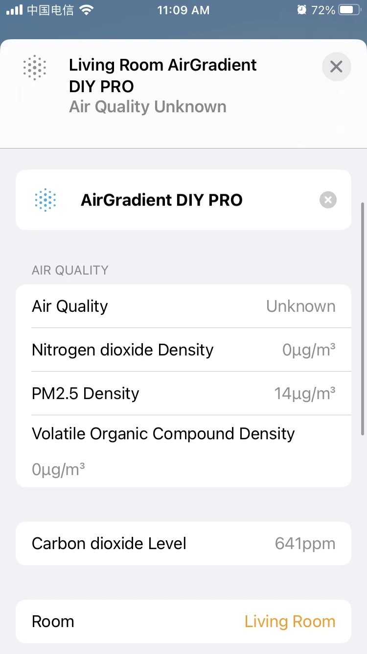

Gottfried Haider made a great integration to HomeKit that allows AirGradient monitors to send data directly to Homekit. We tested it and can confirm that the version works great on the PCB v 3.7.

At the moment the example sketch in the repository only supports the older pro diy version 3.7. But it should be relatively easy to copy the specific sections to the newer versions as well.
Supported Features
It supports all five air quality parameters that the DIY Pro gives you. PM, CO2, TVOCs, NOx, Temperature and Humidity.
