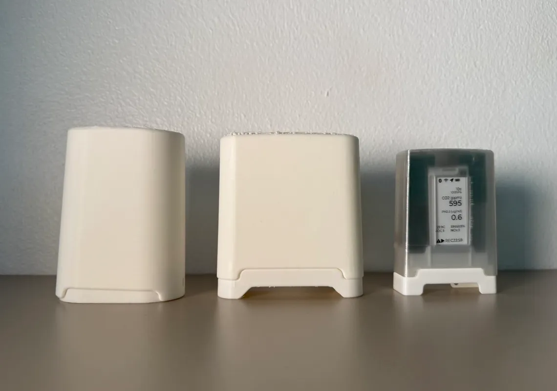

Size constraints - sensors decide the geometry
Iterataions of the AirGradient Go enclosure
You can’t design the enclosure first and then “fit the sensors in later” - the sensors are the enclosure.

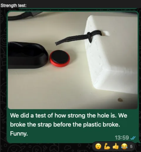

Whatever result we were expecting, it wasn't that the strap would break before the mounting hole!
I always underestimate how much time the “small stuff” takes. Then I build hardware again and remember.
Here are a few details that became surprisingly important:

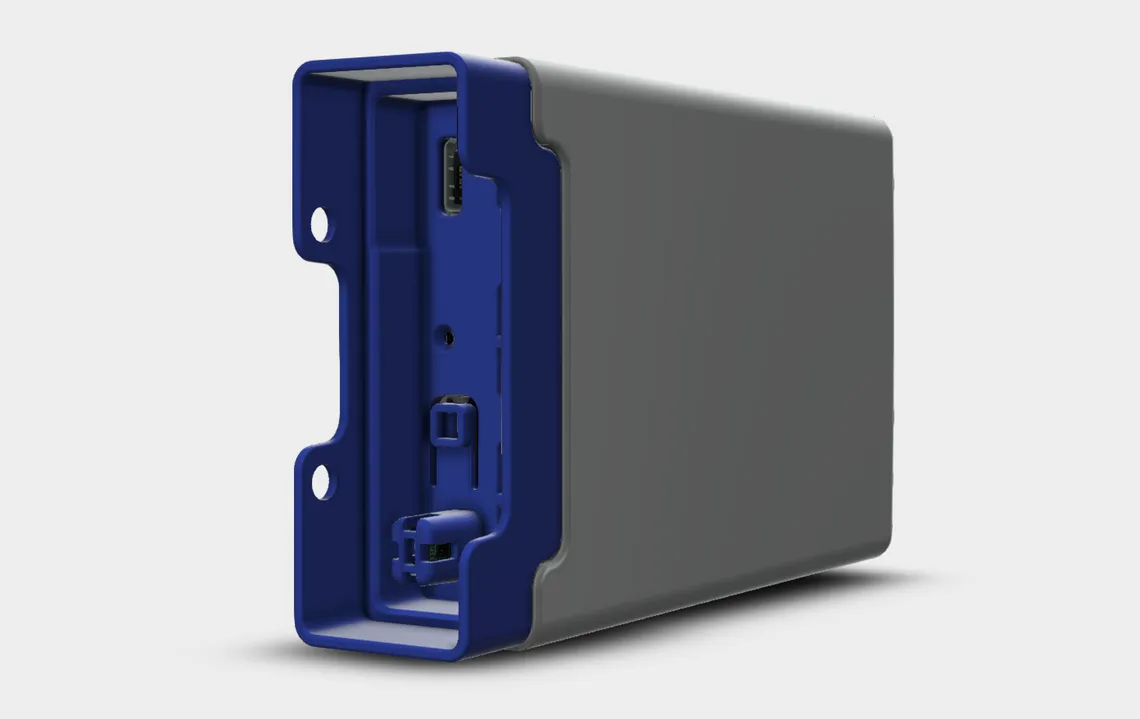

  • USB clearance: not every USB-C plug is the same size. If you don’t leave enough space, some cables will not fit.
  • Strength around the hanging hole: a backpack mount point needs to survive real stress, not just look good in CAD. The material thickness and reinforcement around that hole matters.

Outer enclosure
The enclosure we’re building and that is currently with the mold maker is the product of dozens of micro-decisions, each with a reason behind it.
It’s weatherproof because it has to be used outside. It’s autonomous because we want the device to stand on its own. It’s multi-mode because “portable” is not one lifestyle. And it’s the size it is because physics - and reliable sensing - demands it.
