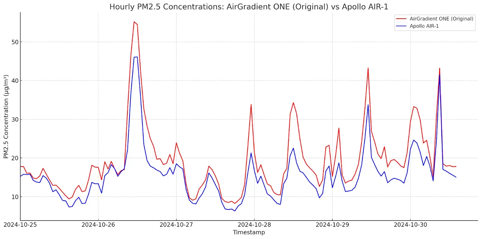

Both the AirGradient and Apollo devices use PM and CO2 sensors from reputable brands. In the case of AirGradient, we use the Plantower PMS5003 for PM and the Senseair S8 for CO2. Apollo instead opts to use Sensirion sensors for both PM and CO2, the SEN55 for PM and the SCD41 for CO2.
Beginning with particulate matter, both sensors are commonly used in air quality monitors but the PMS5003 has appeared in more studies due to it being on the market for longer. The PMS5003 is generally considered to be accurate, but it does overreport particle concentrations (especially in the case of smoke), which is why the EPA developed an algorithm to improve the accuracy of these sensors for its AirNow map. We allow users to apply the EPA correction on their dashboard for better accuracy.
Below is a graph comparing the readings from the two monitors (in one-hour intervals) with no corrections applied.
chart pm25 original

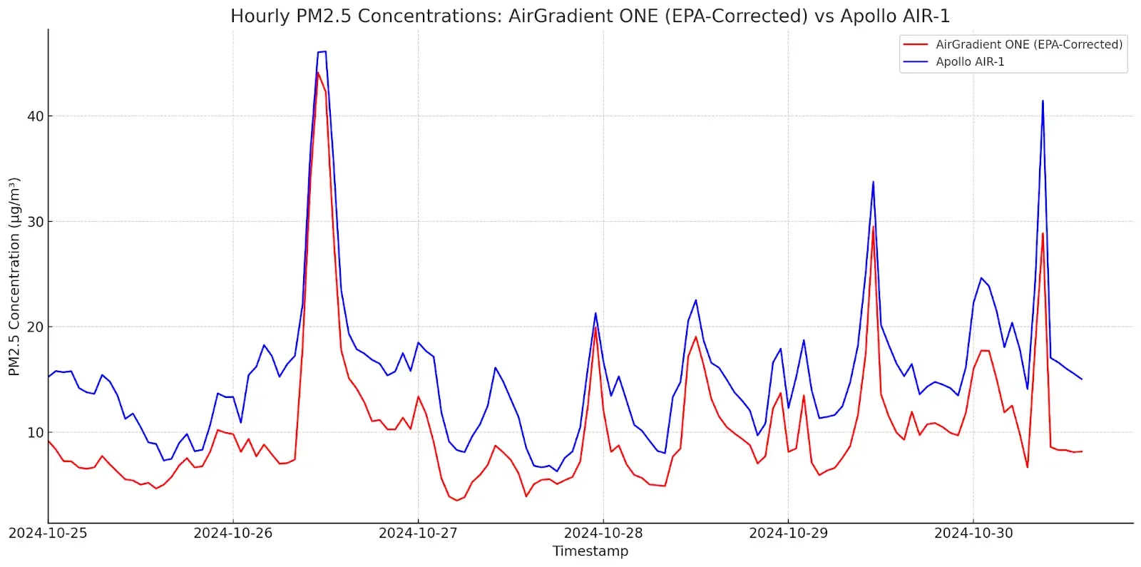

Below is another graph over the same time period, but with the EPA correction applied to the AirGradient data. As you can see, it impacts the data significantly, but both monitors show very similar trends and are within their manufacturer-specified stated accuracies. Both also consistently follow the same trends and perform well.
chart pm25 epa corrected

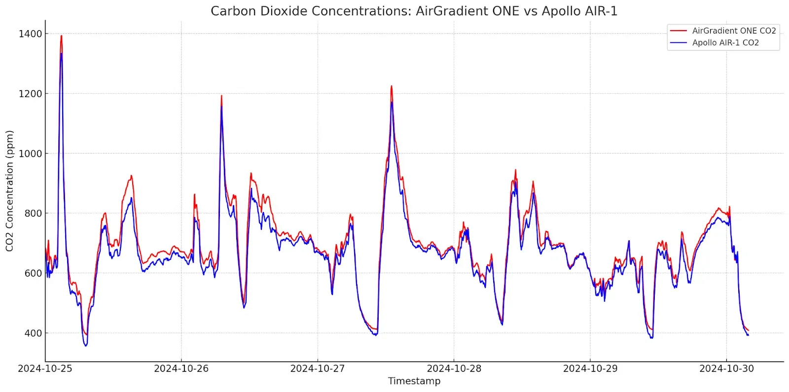

When it comes to carbon dioxide, we see very similar results from both monitors, highlighting the accuracy of the sensors in both monitors. While the monitors use different sensing technologies (transmissive NDIR compared to photoacoustic NDIR), both provide similar results and are accurate. With that said, the Apollo AIR-1 features an air pressure sensor that feeds data to the carbon dioxide sensor, making it more accurate at higher altitudes. While this won’t impact most people, it does make it a better choice for those living at high altitudes.
We will soon be upgrading from the SenseAir S8 to the S88, and this sensor features pressure compensation. However, even once we’ve implemented this change, the user will have to manually feed the information to the sensor, as we don’t include a pressure sensor to automatically account for this.
chart carbon dioxide

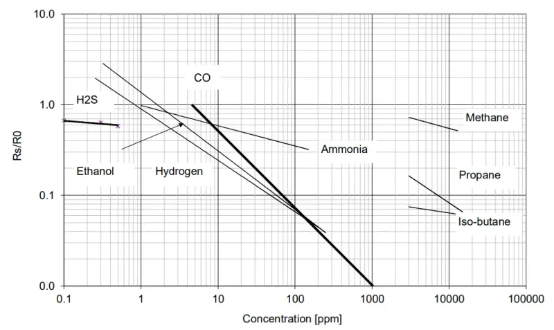

SGX, the manufacturer of the sensor provides the below graph in its documentation of the sensor. Since this is a metal oxide sensor (MOS), it uses increasing resistance to identify gas concentrations. However, as per their own documentation, a resistance of 0.5 could be around 0.5 ppm of hydrogen sulfide, 1.1 ppm of ammonia, 1.25 ppm of ethanol, 8 ppm of carbon monoxide, or 6000 ppm of methane.
This causes an issue because the sensor can’t differentiate between these gases. This resistance could be harmless (ammonia, ethanol, and even hydrogen sulfide are not dangerous at such low concentrations - especially for short-term exposures) or require immediate attention (methane levels this high aren’t toxic, but they can indicate a build-up that needs ventilation immediately).
apollos gas sensor

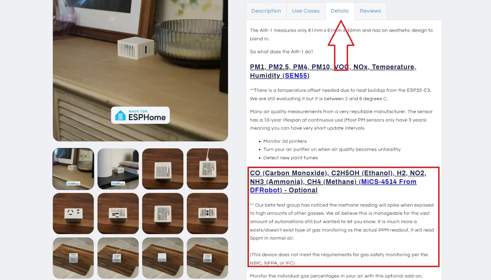

apollos gas sensor details
Apollo does mention some caveats about this sensor, but they’re only mentioned under the ‘details’ tab and aren’t immediately obvious. Furthermore, they don’t highlight the key issues with the sensor and instead highlight it as an exists/does not exist sensor (either there is a gas present or not - the ppm readings should not be relied upon), but even this is generous as we’ve seen the sensor can be very cross-sensitive, and an ammonia reading could mean ammonia, methane, ethanol, hydrogen sulfide, propane, or another gas altogether is present.
Apollo has also defended the decision to include this sensor, which has been requested by users and can be used for automation that doesn’t require high accuracy. For some customers, this sensor will have added value for this reason.
However, we think the warnings for this sensor need to be much clearer and more detailed - if the sensor is kept at all. The AIR-1 is a great device overall, but we believe this sensor has no place in the monitor because it’s inaccurate to the point of being entirely misleading.

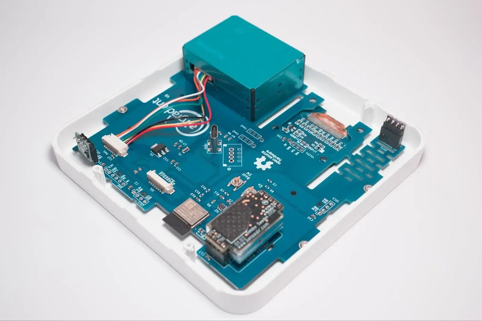

On the other hand, the AirGradient ONE is a much larger device that features a small OLED screen and a row of LEDs representing the current air quality. While the screen makes it best paired with the AirGradient dashboard or Home Assistant, it can also be used as a standalone device.
The design of the AirGradient device also means that sensors sensitive to interference by other components (such as the temperature sensor, which is influenced by heat generated by the other components) can be placed further away. While this can be overcome with offsets (as with the Apollo AIR-1), this is an important note to remember.
