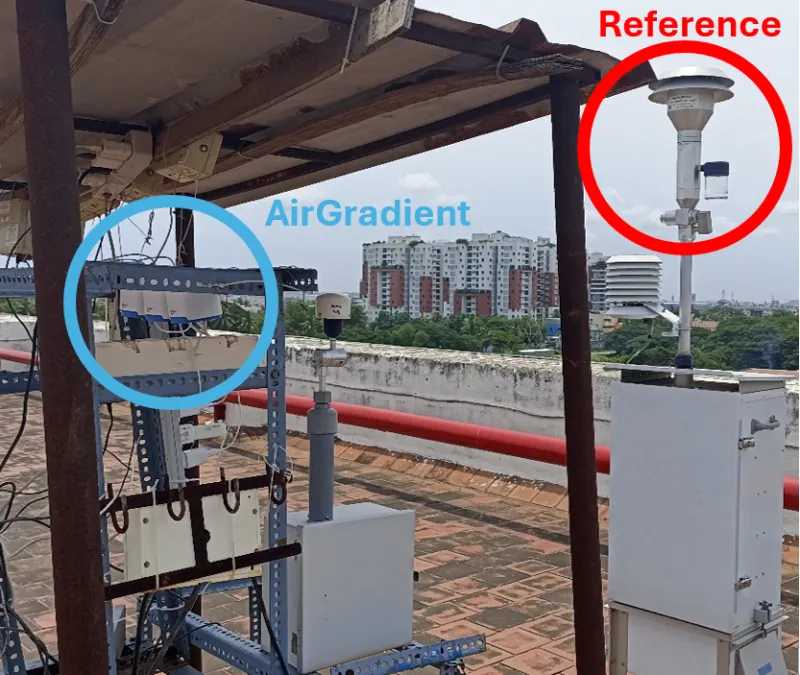

Below are two images. The picture on the left illustrates three of our monitors that are co-located with a reference station in Chennai, India. The map on the right indicates other sites in our co-location project.

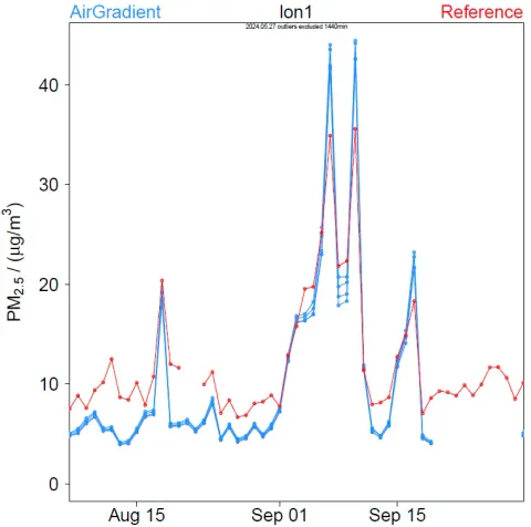

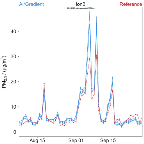

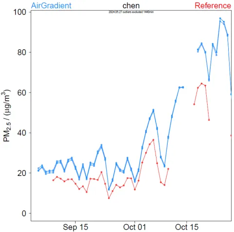

How accurate are our Open Air PM2.5 readings?

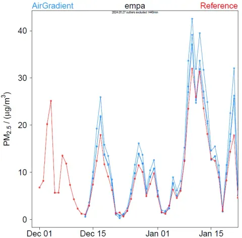

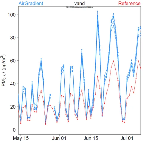

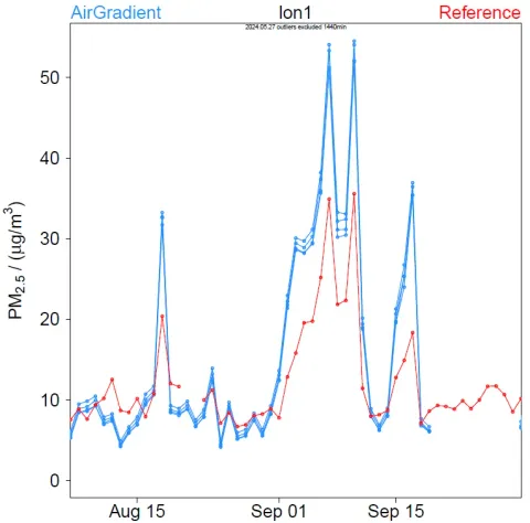

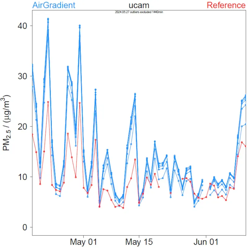

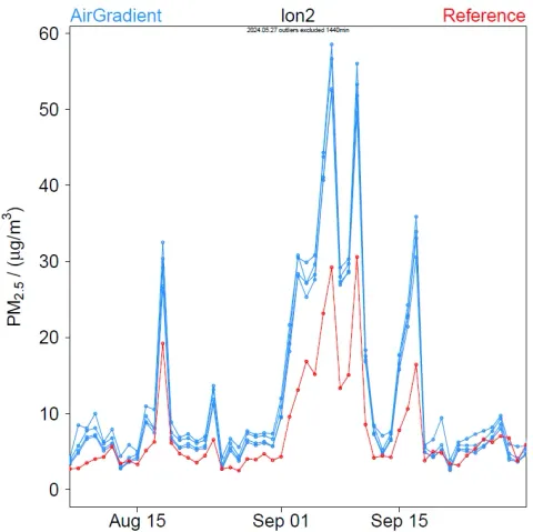

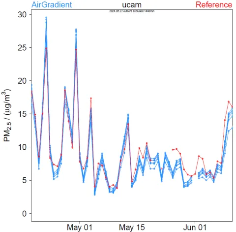

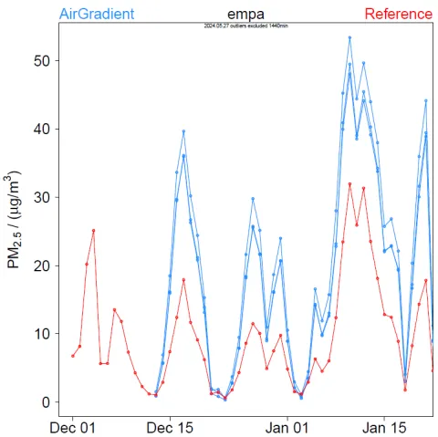

Before talking about correction, let’s talk about the raw readings. How accurate are they? The blue timelines in the plots below show the raw readings for PM2.5 from our Open Air monitors in 10 locations over a time period of 50 days. The red lines refer to the readings from the reference monitors, which can be considered of the highest accuracy. For comparison, some plots also include purple lines, which refer to raw data from low-cost outdoor monitors from PurpleAir. Most plots include multiple blue lines, as multiple Open Air monitors are available per location. All data points are daily averages.

Based on the plots above, it seems that different Open Air monitors at the same location report similar results, implying relatively high reproducibility. Additionally, it seems that the Open Air monitors overestimate PM2.5 in a systematic manner during periods with elevated PM2.5 concentrations. In contrast, they report rather low concentrations when PM2.5 pollution is very low. A similar behaviour is observed for the monitors from PurpleAir. This finding is unsurprising as both AirGradient and PurpleAir rely on optical particle counters from Plantower as a PM sensor. The exact reason for the inaccurate PM readings is unknown to us. However, given that Plantower’s PMS5003 is based on light scattering, it would be surprising if no systematic deviations were observed. Note that instruments based on light scattering measure PM2.5 with respect to optical diameters, whereas PM2.5 is generally defined as aerodynamic diameter. These are two different concepts that can only be directly compared upon conversion with shape factor, density and refractive index, which are generally unknown for ambient PM. Alternatively, one can be converted into another using an empirically derived correction algorithm, which will be the topic of the next section of this article.

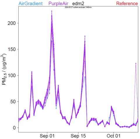

There is an already existing PM2.5 correction algorithm developed by scientists from the United States Environmental Protection Agency (EPA) based on outdoor monitors from PurpleAir in the context of wildfires. EPA uses this algorithm to correct raw PurpleAir data for the AirNow Fire and Smoke Map. The previous section of this blog revealed that the PM readings from AirGradient and PurpleAir are similar, hence, the question arises as to whether the algorithm from EPA is also applicable to AirGradient? As this algorithm is based on raw humidity readings from the low-cost monitor, we first need to understand if the humidity readings from AirGradient and PurpleAir are comparable. The plots below show daily averages of raw relative humidity data from AirGradient in blue, PurpleAir in purple and the reference in red.

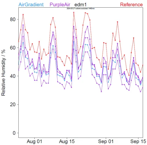

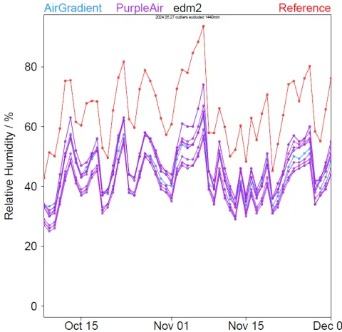

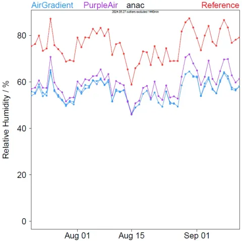

Based on the plots above, it appears that a potential systematic difference in humidity between AirGradient and PurpleAir is minor in comparison to the deviation within a set of PurpleAir monitors. In other words, there is no systematic difference between the humidity readings from AirGradient and PurpleAir based on the currently available data. In this case, let’s look at the correction algorithm from EPA, which can be found here (Eq. 4). It uses different corrections for different raw PM concentrations (PAcfatm). The variable ‘RHraw’ stands for raw relative humidity readings from the low-cost monitor. The formulas below were taken from the EPA PDF.

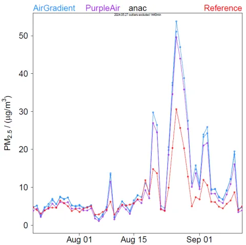

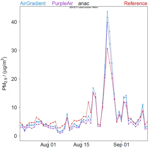

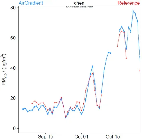

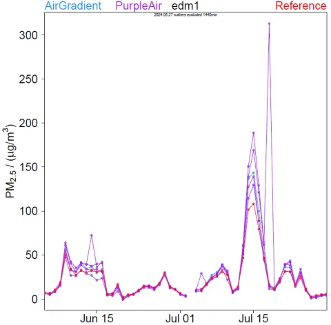

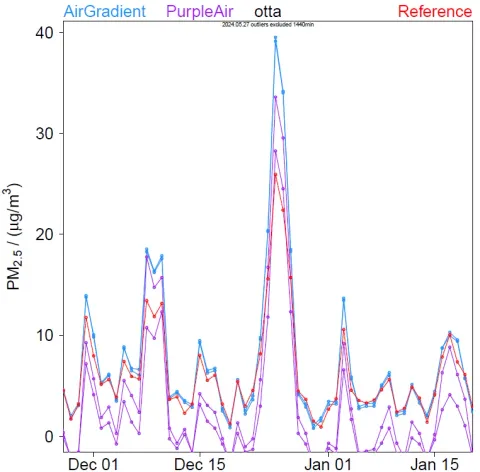

According to EPA, this algorithm accounts for ‘bias and relative humidity at low concentration and the nonlinearity of PurpleAir response at higher concentration’. Let’s see how it performs with our AirGradient data. The plots below are a repetition of the previous plots, but this time, the AirGradient and PurpleAir time points are corrected with EPA’s algorithm.

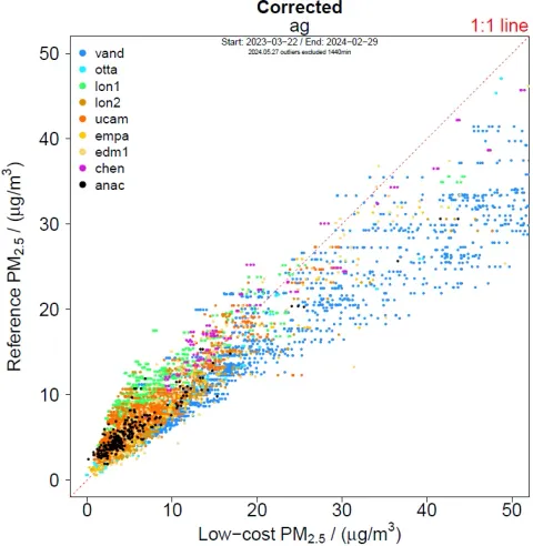

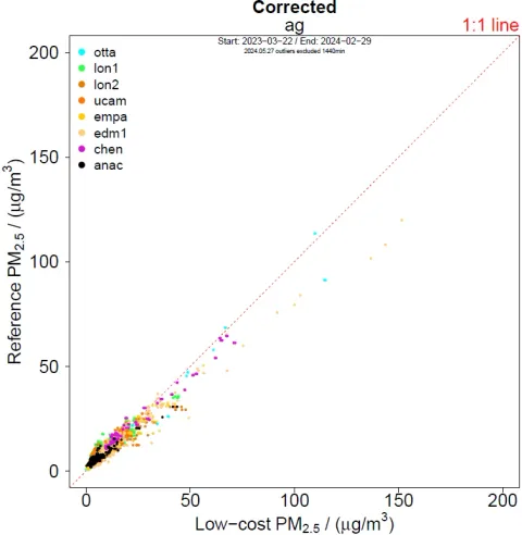

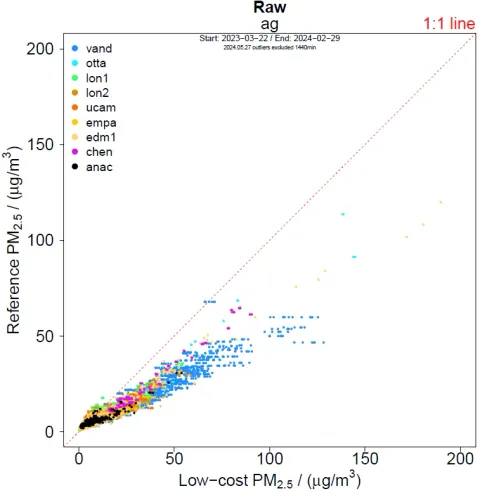

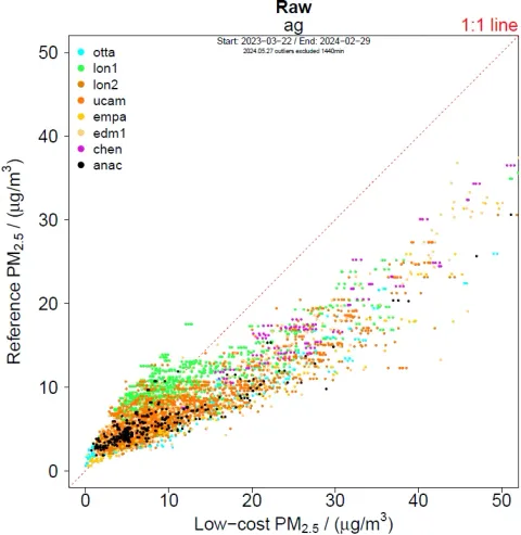

At first glance, the accuracy of both AirGradient and PurpleAir improves when the correction algorithm from EPA is applied. It makes sense to run some scatter plots to better determine the error of the sensors. The plots in the appendix show AirGradient data from individual locations in comparison to the reference (scatterplots, raw and corrected). A summary of the daily PM2.5 raw (left) and corrected data (right) from all locations is shown below, once with full scale and once with a subset from 0 to 50 µg/m³. The reference is situated on the y- and AirGradient Open Air on the x-axis.
Air Gradient monitor
Co-locations map
Co-locations map

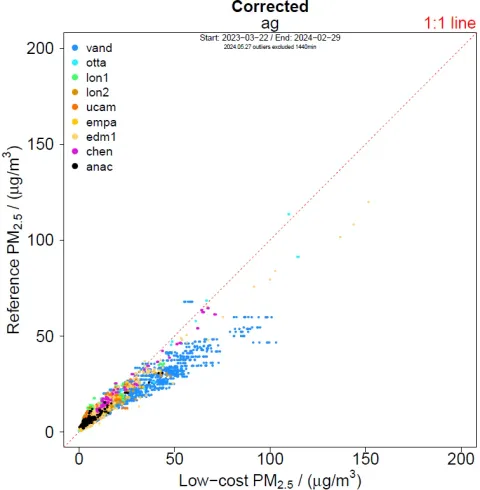

The readings of all locations seem to get closer to the 1:1 line when applying the correction, which is encouraging. When looking carefully, we see that not all locations improve to the same extent. The correction seems to be less accurate in Vanderbijlpark, South Africa (denoted as ‘vand’). Let's repeat the previous 4 scatter plots, but this time leave out this location to make the other locations more visible. We come back to Vanderbijlpark later in this blog article.

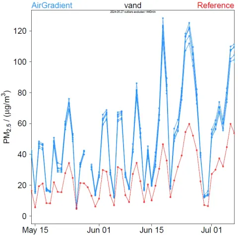

Why does the data from Vanderbijlpark look different to the other locations?
As previously noted, the correction algorithm seems to be less effective in Vanderbijlpark (vand), South Africa. Readings for elevated PM2.5 levels of > 20 µg/m³ seem further away from the 1:1 line compared to other locations such as Chennai (chen), Ottawa (otta) or Edmonton (edm1), even when applying correction. This could be the result of different physical PM2.5 properties in that location. It could also be related to the reference instrument. Note that different reference instruments may use different measuring principles and may be calibrated differently. More data is currently being acquired to further investigate. Despite this phenomenon, the nRMSE in Vanderbijlpark also improves significantly when the correction algorithm is applied.

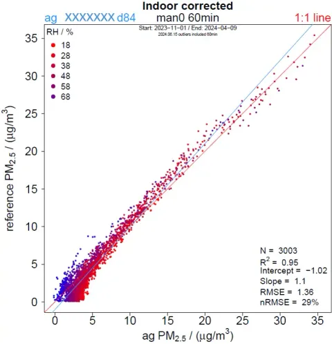

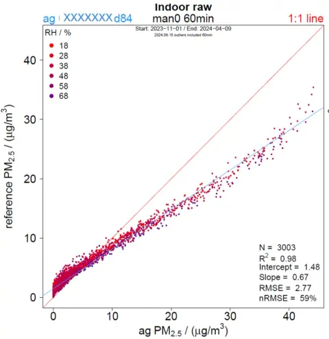

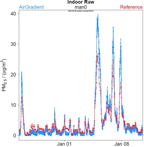

Although the co-location project focuses on outdoor data, we also have some hourly indoor data from multiple AirGradient ONE’s that are co-located with a MODULAIR monitor from QuantAQ in Manchester, England. Note that this reference monitor is neither a Federal Reference Method (FRM) nor a Federal Equivalent Method (FEM). However, co-location of a MODULAIR monitor with research and/or regulatory-grade instruments has shown high correlation coefficients (R2 = 0.936) and low mean absolute errors (MAE = 1.2 µg/m³) for hourly PM2.5 data according to QuantAQ. The normalized MAE is unknown to us.
Timelines and scatter plots for the co-location of AirGradient One with QuantAQ MODULAIR are shown here:
Co-locations map
Co-locations map
Based on the available data and nRMSE as a metric, it seems that the correction algorithm also improves the accuracy of the AirGradient indoor monitors (nRMSE improved from 59 % to 29 %).
