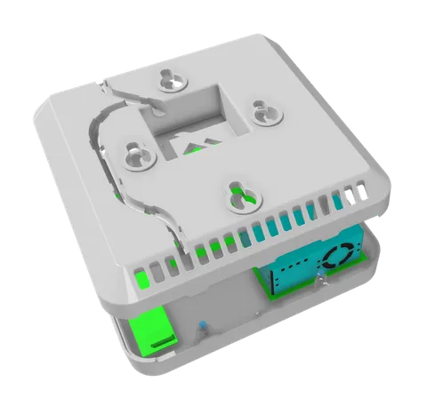

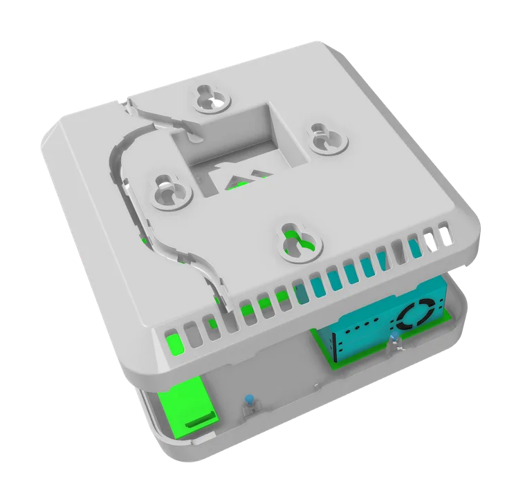

For our indoor air quality monitor, we were able to make a very nice design of the enclosure with a very simple mold design that did not need any sliders or lifters and was a family mold.
Here is how the enclosure looks like (from the back side):
The AirGradient Indoor Air Quality Monitor

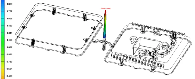

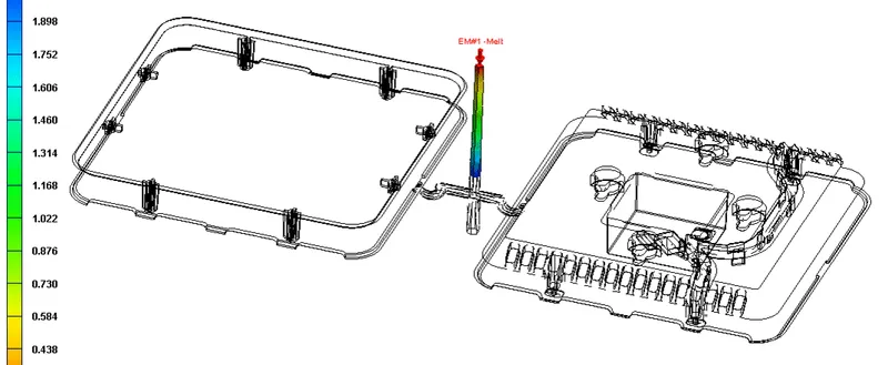

The mold maker will analyze the design (typically the STEP file) and make recommendations for improvements, e.g. changing some thickness, adding draft angles, definition of the parting line etc. It is also recommended that they do a mold flow analysis and identify certain problem areas, e.g. warpage.
Here is a picture of a mold flow simulation of the enclosure of our indoor air quality monitor:
Mold Flow Simulation

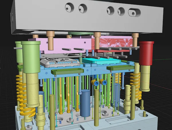

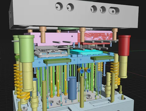

Creating the Mold 3D
Once you have approved the changes, the mold maker will create a 3D drawing of the complete mold. This includes all parts, including cooling lines, ejector pins etc. It is super important that you review in depth this mold 3D with your own expert as sometimes mold makers try to do shortcuts that save them money but could create problems later on. Once you approve the mold 3D it is often very difficult and expensive to make even simple changes. So spend time and resources on this mold 3D approval.
The Complete Mold Design
So even though the plastic part is very simple, the mold looks already quite complex.
