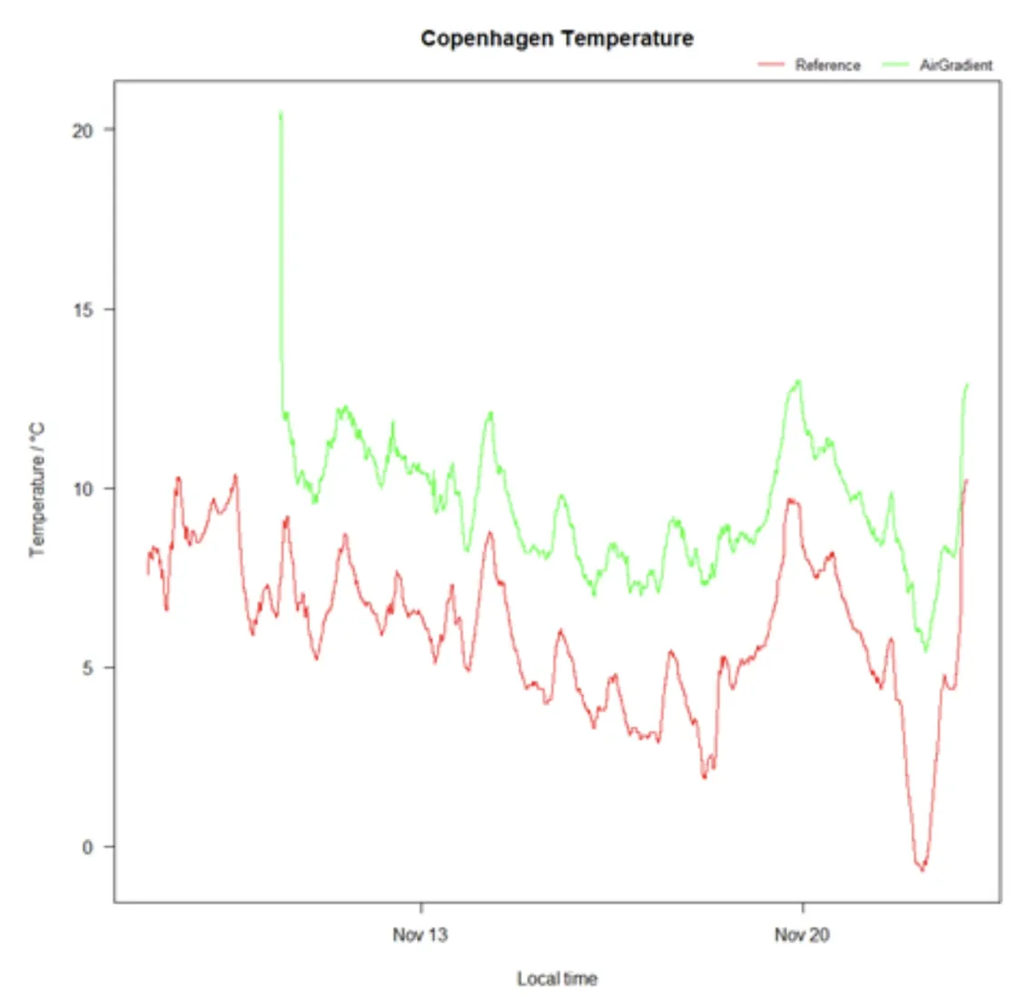

Recently, one of our customers in Denmark approached us and emphasized that our OpenAir monitors overestimate temperature in cold environments – a systematic deviation, which we have seen in other locations too. We are aware of that inaccuracy and we currently collect data from more locations and seasons to develop appropriate correction algorithms. The reason for this deviation is that the electronic components inside the PM sensor heat up the air that is flowing through it. So, let’s develop a simple linear correction model based on the data from Denmark. First, let’s take a look at the raw data from Denmark to understand the problem:
The figure above shows temperature over time reported by the OpenAir monitor in green and the reference monitor in red. Don't worry about the first few data points on the green line, as the OpenAir was probably first indoors before being set up outdoors. In consequence, the green and the red line should perfectly align as they both are the result from temperature measurements at the same location.
However, they do not align. The green line is systematically higher than the red one, on average roughly 3 °C. The temperature from the reference should be accurate enough to be considered as the true temperature, so there is only one reasonable explanation for what’s going on here: the temperatures measured by OpenAir monitors are approximately 3 °C higher than the true temperature – at least within the data set presented here.

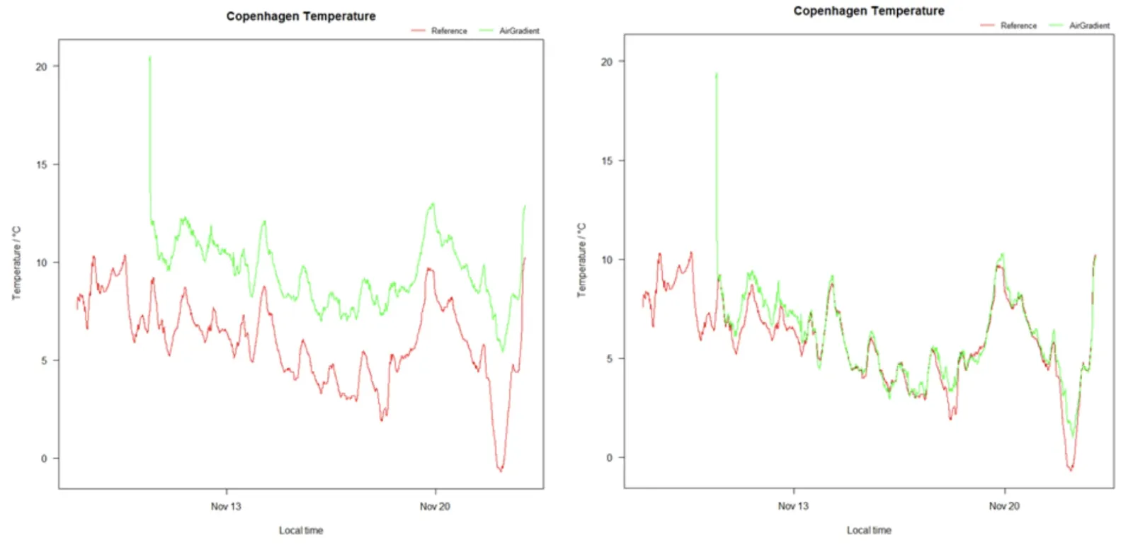

And that’s it, the equation above is the linear correction model for the OpenAir temperature! We simply take the OpenAir reading, subtract 4.55 °C and divide by 0.83. Theoretically, this should give us fairly accurate temperatures within the temperature range of the Cambridge data. Let’s try to verify our model using the Denmark data.
The two figures above show the measured temperatures by OpenAir (green) and reference (red) in Denmark. The OpenAir data on the left is raw, whereas the OpenAir data on the right has been corrected using the linear algorithm described in this post.
As you can see, the alignment between red and green improved significantly, supporting the validity of our model. Now, OpenAir’s temperature accuracy is almost the same as the one from the reference. However, to properly verify this model we would have to consider other temperature ranges and locations too. We can do that for the location in Denmark once more data is available. Generally: the more data available, the more accurate correction algorithms can be developed and the more profound verifications can be undertaken.
