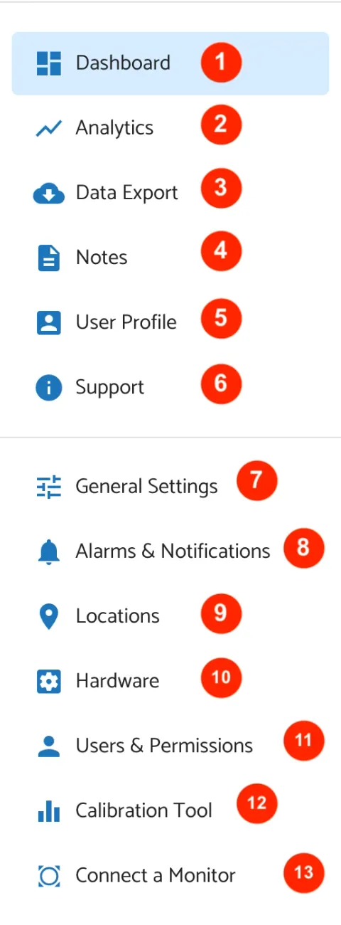

By pressing the three-line menu on the top left, you access the side navigation menu. This menu is where you will navigate between pages on the AirGradient dashboard and it’s under this menu that you will find most of the settings for your monitor.
Figure 1: The three-line menu icon (in the top-left corner)
Once you click on this menu, you will be presented with a list of all the pages on the dashboard you can navigate to. Below is an image with explainers for the basic functionality of each page.
Please note: If you can’t see all of these pages or the sub-pages (which we will discuss soon), it’s likely that you don’t have the permissions required to access them. If this is the case, please contact your dashboard administrator to update your permissions.
Figure 2: Navigation menu items.
What does the navigation panel include?
Here’s a short description of each section in the AirGradient Dashboard side navigation panel:
  1. Dashboard – The main overview of air quality data, showing key metrics like PM2.5, CO2, temperature, and humidity. This is the home page of the dashboard, and likely the page you are already on.
  2. Analytics – Provides deeper insights and trends over time for different air quality parameters.
  3. Data Export – Allows users to download air quality data for further analysis.
  4. Notes – table of notes related to air quality monitoring created by you.
  5. User Profile – Personal settings, preferences, and account management options.
  6. Support – Access to help articles, troubleshooting guides, and customer support.
  7. General Settings – Configuration options for customizing the platform’s behaviour and preferences.
  8. Alarms & Notifications – Set up and manage alerts for specific air quality thresholds.
  9. Locations – Manage different monitoring locations and view their air quality data.
  10. Hardware – Displays information about connected sensors and devices.
  11. Users & Permissions – Manage user roles, permissions, and access control.
  12. Calibration Tool - Calibrate your monitor for further accuracy.
  13. Connect a Monitor – Add new air quality monitoring devices to the platform.

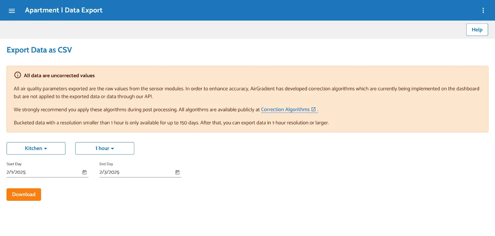

1.3 Export Data Page
Figure 5: Data Export page.
Link: https://app.airgradient.com/dashboard/export
This page lets you export data in table format (excel format) for a specific period and measure.
To export data, you will need to select the location (monitor) that you want to export data from, the bucket (the averaging period) and the start and end date of the exported data. Please note that raw data is only kept for 10 days.
Once you click ‘Download’ a CSV file will be generated and downloaded through your browser. Please allow this download, and save it in a location that is easy to relocate.

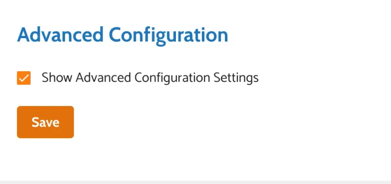

Additionally, you can enable Advanced Configuration, which adds two extra tabs:
Figure 12: Advanced Configuration Section
  • Calibration – Configure calibration parameters for such measures as PM2.5, Relative Humidity and temperature.
  • LED & Display – Adjust LED lights and display settings, such as brightness and day/night modes. This applies to the AirGradient ONE (indoor air quality monitor) and doesn’t need to be used if you are only relying on outdoor air quality monitors.
Figure 13: Tab section when ‘Advanced Settings’ is activated
Most of the time, you won’t need this. However, if you want to create a default configuration that serves as a standard for each monitor in your place, you should enable Advanced Configuration.

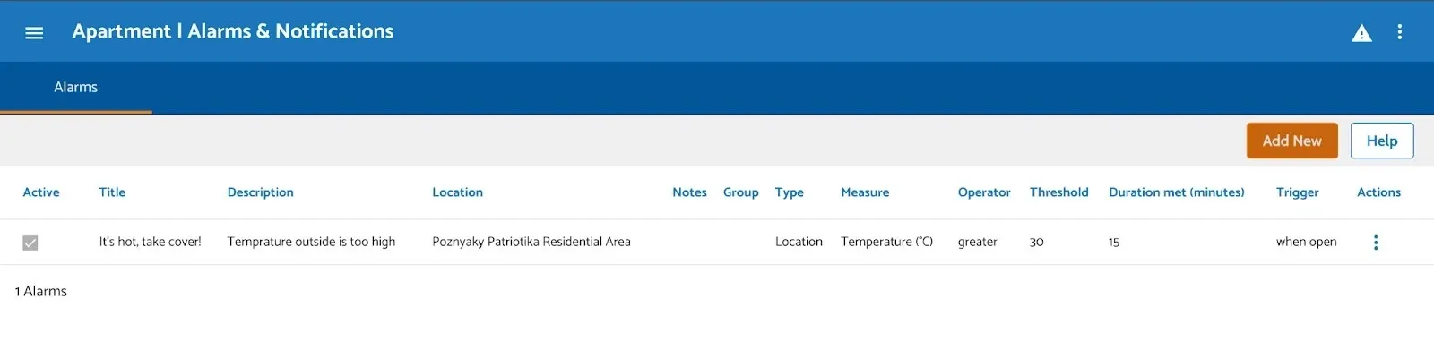

1.8 Alarms & Notifications
Figure 14: Alarms & Notifications Page
Alarms on the AirGradient Dashboard are alerts or notifications triggered when air quality measurements exceed predefined thresholds or meet specific conditions. They help users monitor and respond to significant changes in air quality, such as:
  • High levels of pollutants (e.g., PM2.5, PM10, CO2, VOCs)
  • Temperature or humidity beyond comfortable ranges
  • Custom-defined alerts based on user settings for specific air quality metrics.
These alarms can be configured to display prominently on the dashboard and may also send notifications via email or other channels, depending on the system setup. Their purpose is to ensure prompt action when air quality reaches unhealthy or concerning levels.

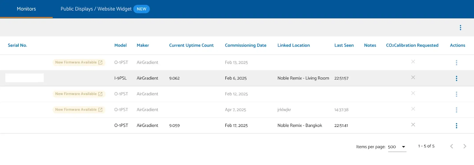

1.10 Hardware
Figure 16: Hardware Page
Hardware refers to the section where users can manage, configure, and monitor their air quality hardware devices. This feature helps ensure that the connected sensors and monitoring devices function correctly and are efficiently organized. Here you can see all monitors assigned to your location, including third-party monitors. The existing monitors can be edited or deleted here.
Under the Public Displays/Website Widget tab on the hardware page, you are also able to create displays that can be seen or shared through a unique URL. You can select which monitors to show data from, and which parameters you want to display, and you can also customize exactly how the display appears. Once completed, you will be given a URL that can be visited or seen by the public. This is a great way to share the current air quality without giving users access to your dashboard.

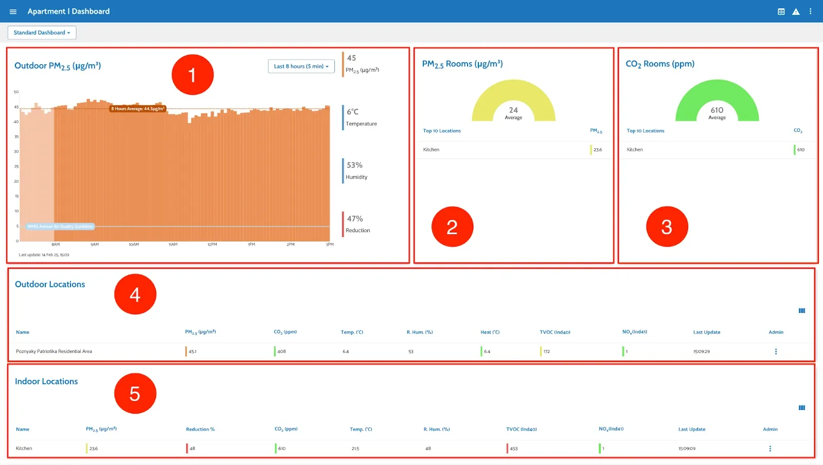

3.1 Standard Dashboard View
Figure 19: Standard Dashboard
Here’s a quick overview of what we have on the AirGradient dashboard based on the image and general information about AirGradient's platform:
Outdoor PM2.5 (µg/m3) Graph
This section provides a detailed real-time graph of outdoor PM2.5 levels over time. It includes:
  • A trendline showing the concentration of PM2.5.
  • An average value for the selected time period.
  • Temperature, humidity, and reduction percentage indicators to help assess air quality trends.
  • A WHO guideline indicator for reference.
PM2.5 Rooms (µg/m3) Overview
This section displays the indoor PM2.5 levels, showing:
  • A gauge with the current average PM2.5 value.
  • A list of the top indoor locations with their respective PM2.5 measurements.
CO2 Rooms (ppm) Overview
This section provides a similar gauge but for CO2 levels indoors, showing:
  • The current average CO2 concentration.
  • A list of indoor locations with their CO2 readings.

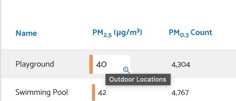

Outdoor Locations Data Table
This section presents a table summarizing the air quality measurements from outdoor monitoring locations. It includes:
  • PM2.5, CO2, temperature, humidity, heat index, TVOC and NO2 values.
  • The last update timestamp.
  • Admin options for further management.
Indoor Locations Data Table
Similar to the outdoor table, this section displays key air quality metrics for indoor locations, including:
  • PM2.5 levels and reduction percentages.
  • CO2 concentration, temperature, humidity, TVOC, and NO2 values.
  • The last update time and admin options.
This dashboard provides a comprehensive overview of air quality, helping you to monitor and improve indoor and outdoor environments.

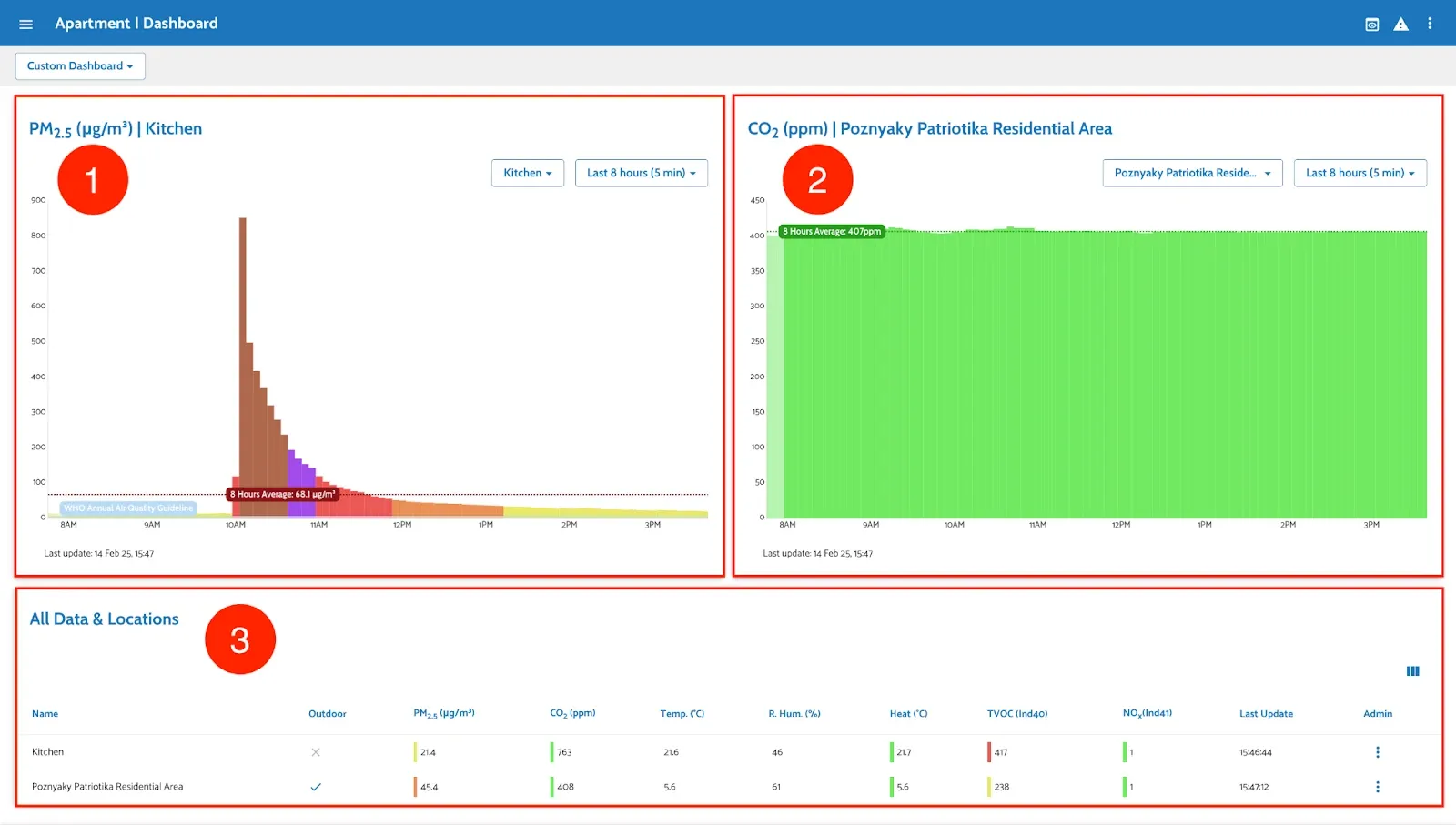

3.2 Custom Dashboard View
Figure 20: Custom Dashboard
Here’s a quick overview of what we have on the Custom Dashboard based on the image and AirGradient's functionality:
PM2.5 (µg/m3) | Selected Location
  • A detailed graph showing PM2.5 levels over time for the selected location.
  • The user can choose a different location and select a date range to analyze air quality trends.
  • The graph includes data for the chosen period of time and the WHO Air Quality Guideline for comparison.
CO2 (ppm) | Selected Location
  • A real-time graph tracking CO2 levels for the selected location.
  • Users can adjust the location and time range to analyze trends.
  • The data for the chosen period of time is displayed to provide context for air quality assessment.
All Data & Locations Table

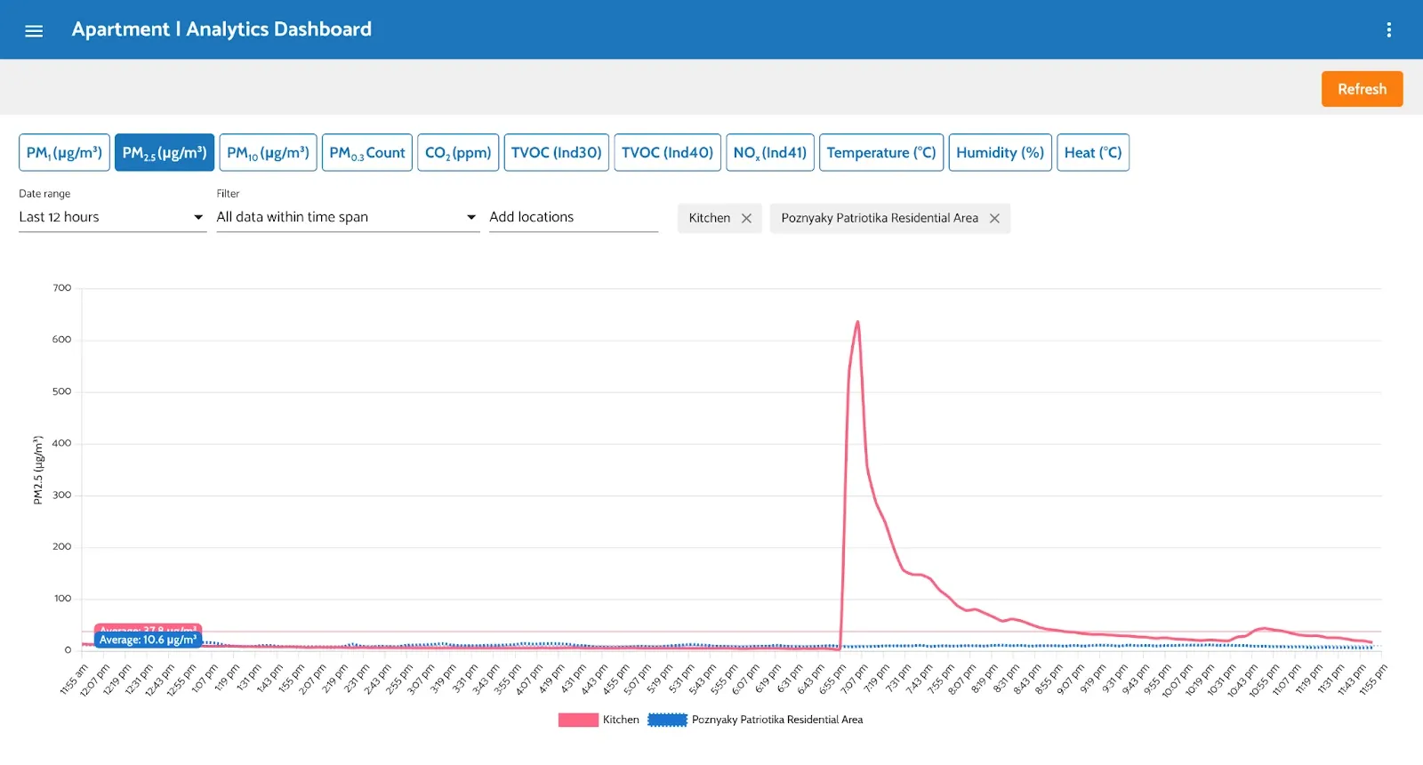

By pressing on the measurement value of your interest, you’ll be taken to the chart:
Figure 22: Chart of measured values for a specific time range.

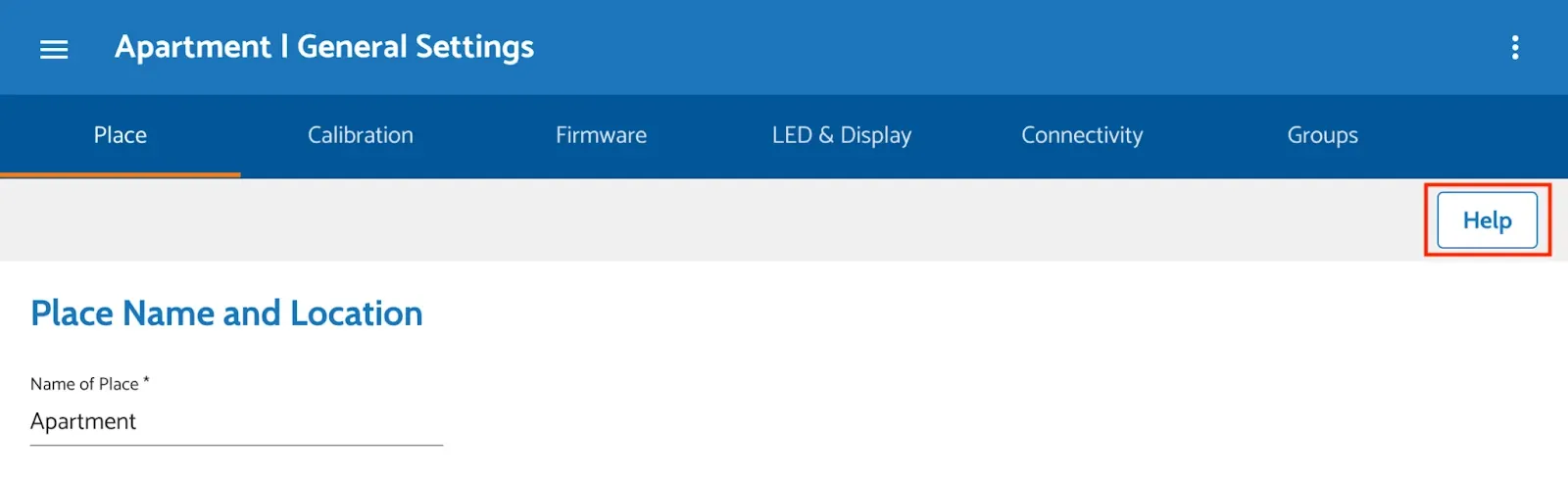

4. Help
On each page, tab or modal window you have a hand of help in case you want lo learn more - help functionality - that is a quick guide on what you see on the screen!
Figure 23: Help button
Or
Figure 24: Help button

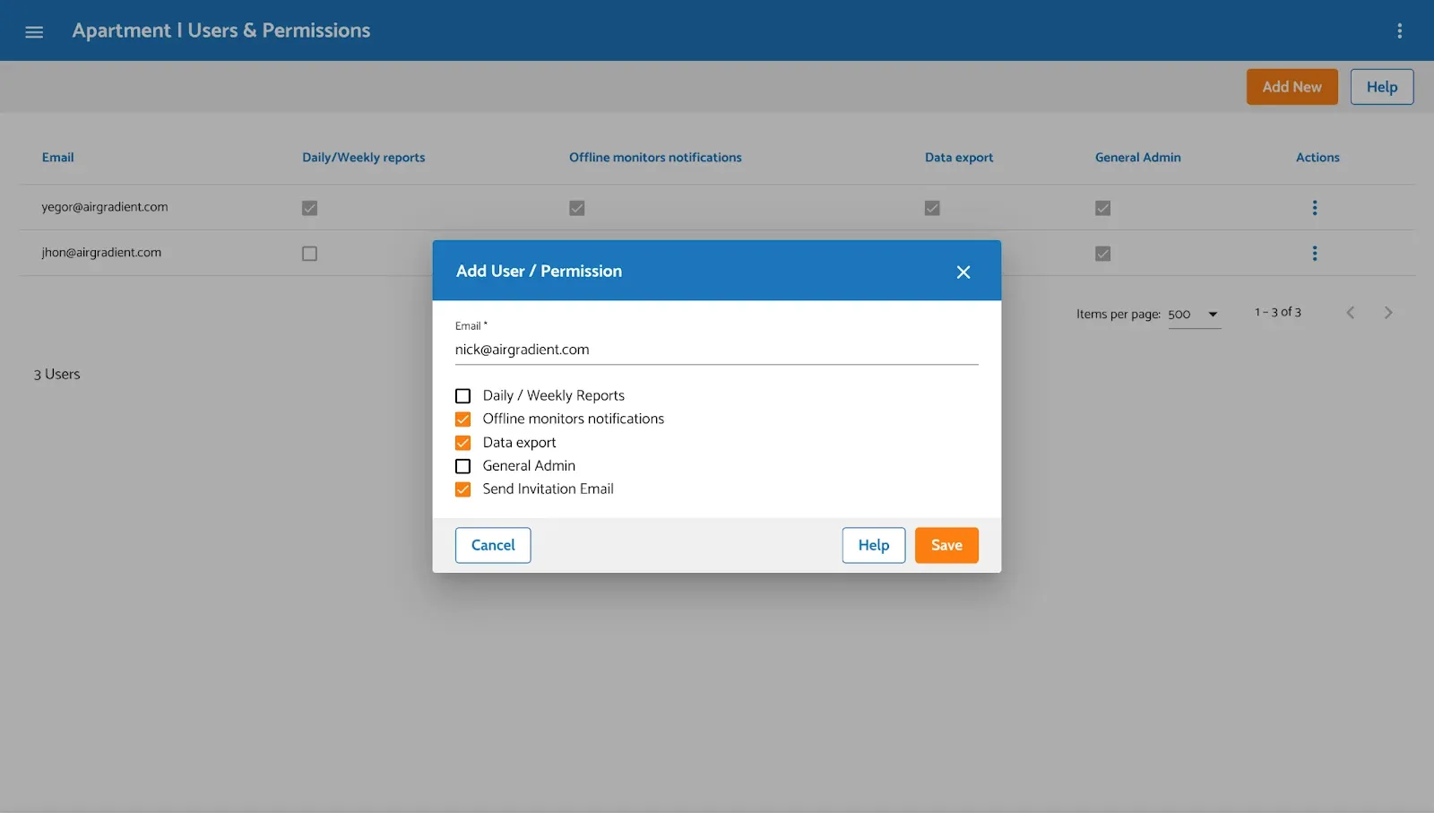

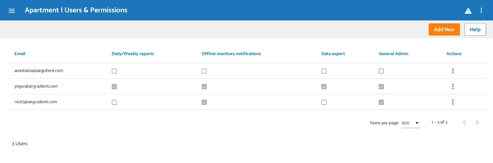

How can I add my friends to a place?
By going to ‘Users and Permissions’ and pressing the ‘Add New’ button, you will be prompted to enter your friend's email address and select the permissions to grant them.
Figure 26: ‘Add User/Permission’ window
