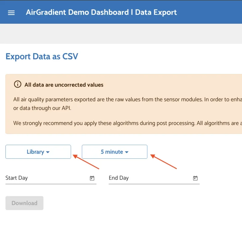

Access the Export Page: In the dashboard, go to the Data Export page. You will find this inside the side navigation menu.
Select Location and Bucket Size: Start by choosing the location (monitor) from which you want to export data. Along with selecting the location, you'll need to choose the bucket size. If you prefer raw data, select the “raw” option instead of a bucket size. For bucketed data, pick the desired bucket size (e.g., 5 min, 10 min).
Select Date Range: After selecting the location and bucket size (or raw data), choose the date range for which you want to export data. You can select a custom range based on your needs.
Export the Data: Once you've made your selections, click on the "Download" button to generate and download the data file. Your data will be prepared in CSV format and the download will start automatically.

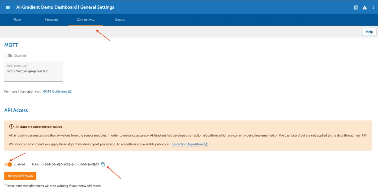

Obtain an API Token: In your AirGradient dashboard, go to the General Settings page under the Connectivity tab. Enable API access, and once successful, you will receive a unique API token.

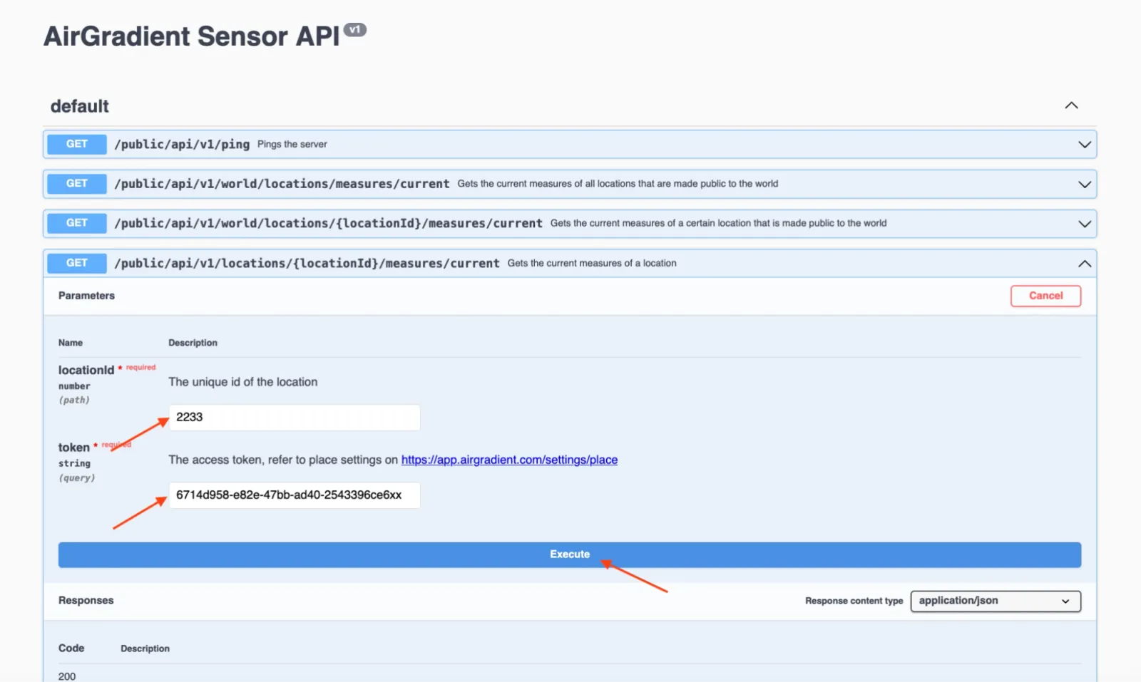

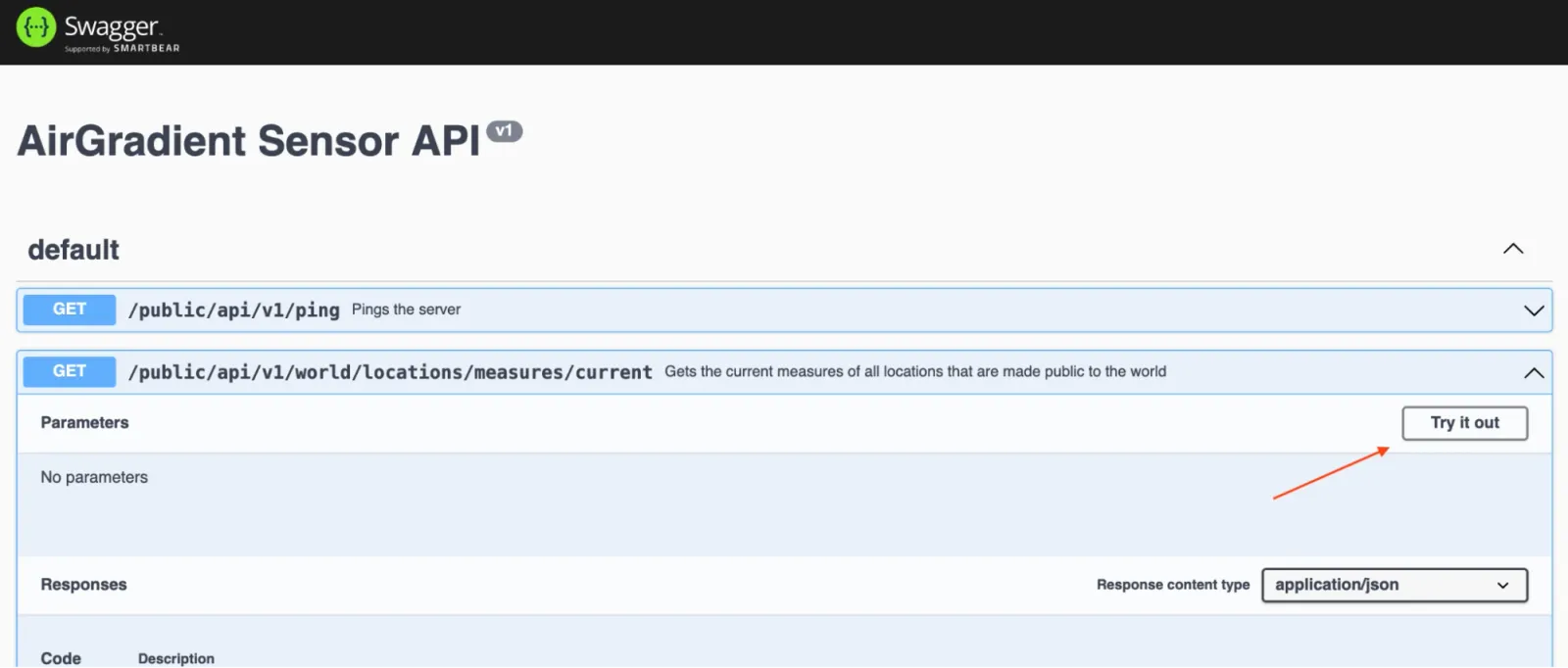

Explore the Public API Endpoints: You can find all available public API endpoints in the Swagger Documentation. This page allows you to try out the necessary endpoints and provides descriptions for each, including the required parameters.

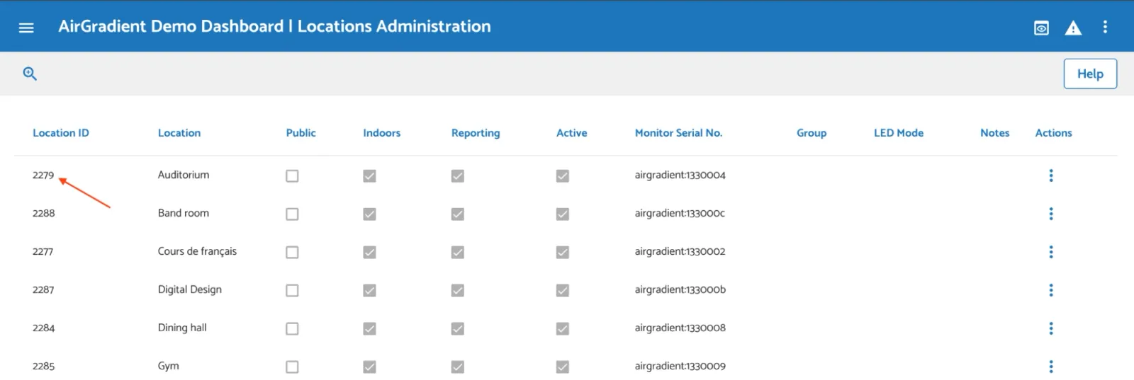

Identify the Location ID: Some of the endpoints require location ID. It refers to the unique ID of the location that your monitor is linked to. It is not the name of the location. To find it, go to your dashboard’s Locations Administration page. In the table of all locations, identify the desired location, and the location ID will be displayed in the first column.
Include Your API Token and Location ID: When making a request, include the API token and location ID (if applicable) that you retrieved from your dashboard in the relevant fields.

How do I get the location ID for API requests?
To find the location ID, go to the Locations Administration page in your dashboard. The location ID is listed in the first column of the table that shows all of your locations.
How do I get an API token for the AirGradient API?
To obtain an API token, you need to enable API access on the General Settings page of your AirGradient dashboard under the Connectivity tab. Once enabled, you will receive a unique API token that you can use for making API requests.
Do I need to re-enable API access every time?
No, once API access is enabled and you have your API token, you can use it for future API requests without re-enabling.
