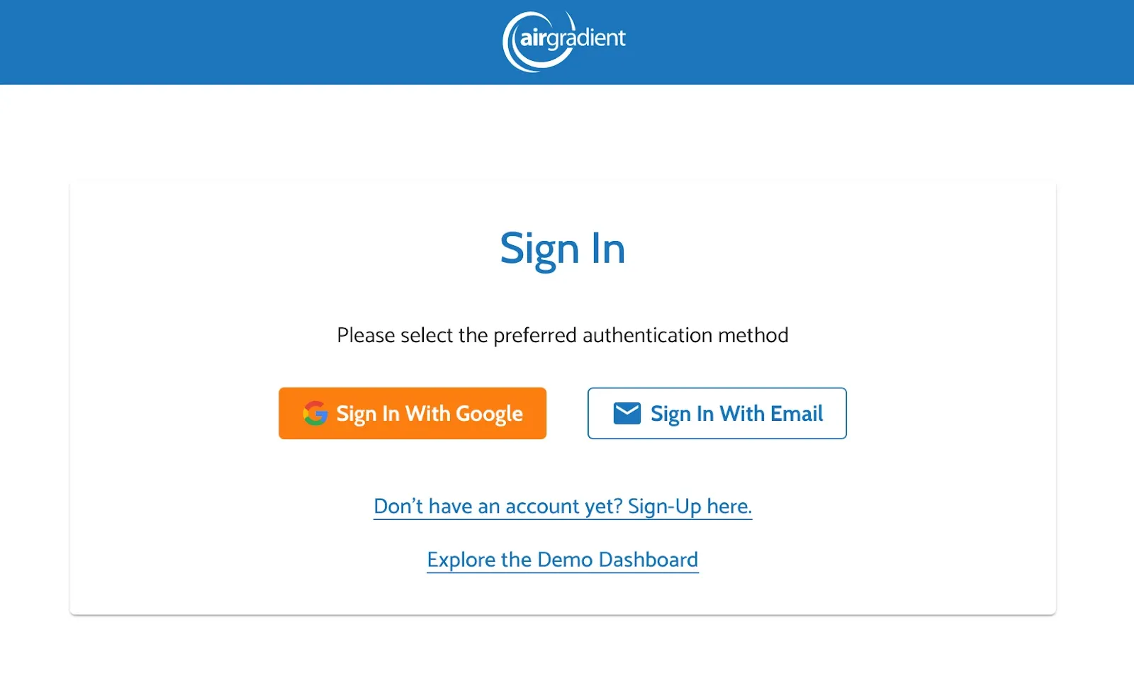

  3. Create or Sign In to an Account
    • Upon accessing the Onboarding Wizard, click "Next" to proceed. You will then be prompted to either sign in to an existing AirGradient Dashboard account or create a new one. If you already have an account, simply sign in using your credentials, and the new monitor will be added to your existing account.
    • If you do not have an account, you can create one using either a Gmail sign-in or another email address. During the account creation process, you will be asked to agree to the AirGradient Terms and Conditions and Privacy Policy.

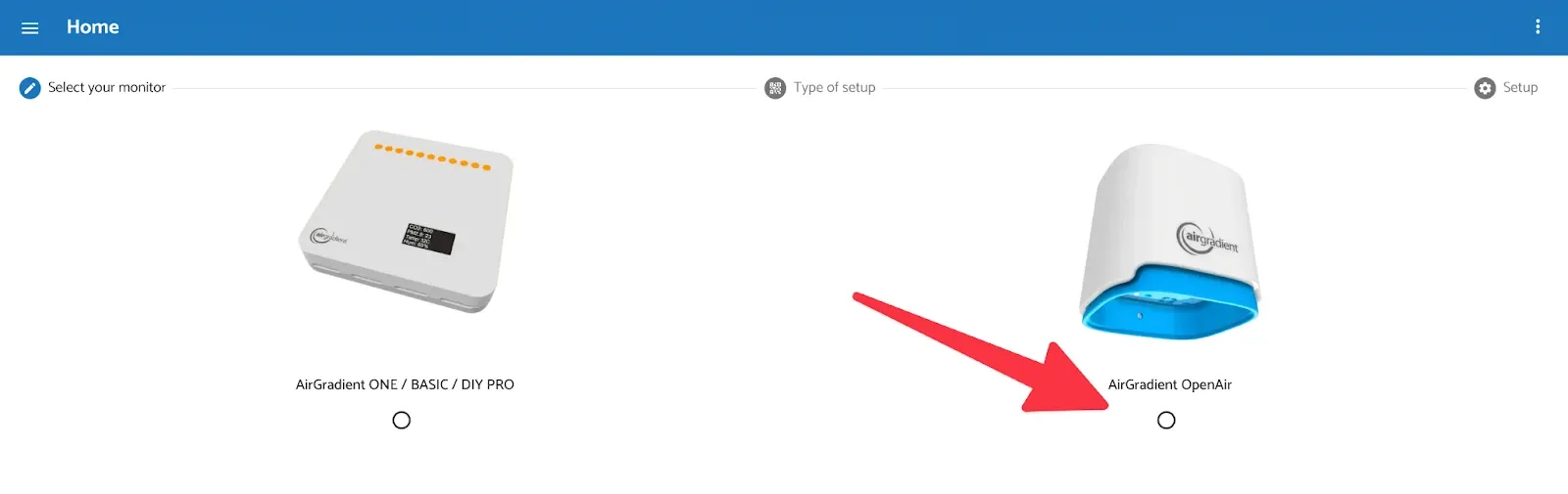

  4. Select “AirGradient Open Air OR Open Air Max”
    • You will be prompted to select the monitor you are setting up. In this case, you should select either the Open Air or Open Air Max depending on which monitor you are setting up.

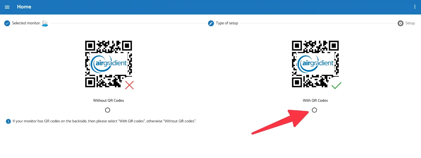

  5. Select "With QR Codes"
    • In the setup wizard, you will be prompted to select whether your monitor has a QR code. All fully assembled AirGradient Open Air monitors come with QR codes. Therefore, select the option "With QR Codes" to proceed.

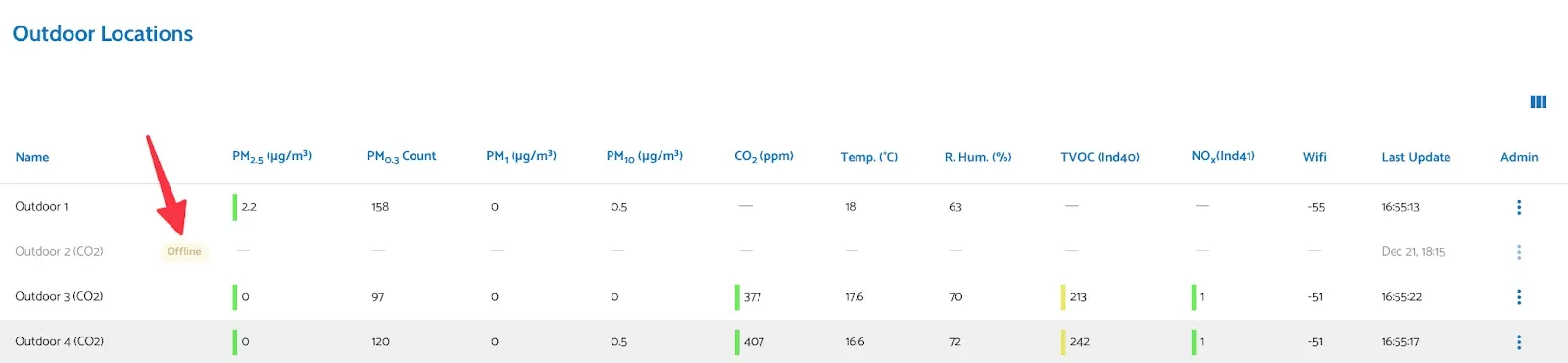

Locations Table
As you can see in the image above, one monitor is not correctly connected (as shown by the ‘offline’ status).
