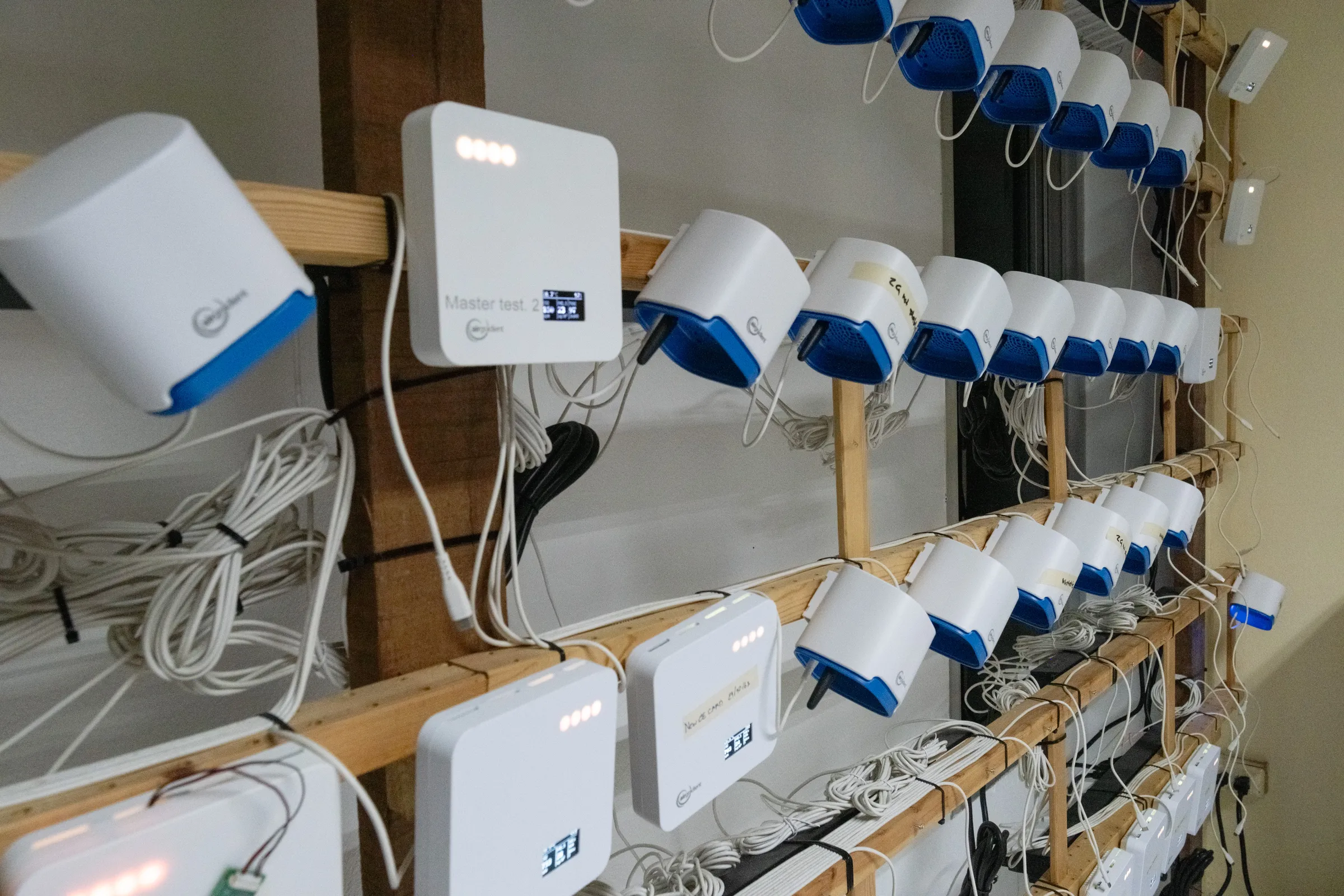

AirGradient monitors on the test wall
The unfortunate truth is that many (I might even go so far as to say ‘most’) low-cost air quality monitors are barely tested at all. Many brands imply (or outright claim) that every device is calibrated, validated, or “lab tested” before shipping. In reality, the vast majority of consumer-grade monitors are assembled, powered on long enough to confirm that the screen lights up, and then packaged. There is rarely any meaningful sensor verification or other more advanced testing.
Part of the issue is structural, as most manufacturers rely on fully pre-calibrated modules from companies like Plantower, Cubic, or Sensirion and assume the sensor manufacturer’s internal calibration is “good enough.” The problem is that these modules are essentially black boxes - their calibration methods, reference instruments, correction curves, and environmental assumptions are almost never disclosed. We don’t know what aerosol they were calibrated with, how the particle size distribution was chosen, how humidity was handled, or what smoothing or filtering sits inside their firmware. Without that transparency, it’s impossible to know how well the “factory calibration” will hold up outside the controlled conditions it was tested in.
An even bigger issue is how many devices are subcontracted. A large portion of consumer air quality monitors aren’t built (or even assembled) by the companies selling them. Instead, they’re produced by OEM factories that offer a “ready-made” design, meaning the brand themselves often have little involvement in how the device actually works. In these cases, the company selling the monitor never touches calibration equipment, never performs validation, and may not even know the details of the algorithms inside the firmware.
This is why companies that take a more rigorous approach to both transparency and accuracy tend to stand out. In our own work, we’ve seen how essential it is to actually validate sensors ourselves, by comparing particle concentrations against a reference instrument, and individually calibrating each sensor. It’s a very different mindset from the common “assemble and ship” approach, and it gives us a fundamental understanding of exactly how the sensors we use work.

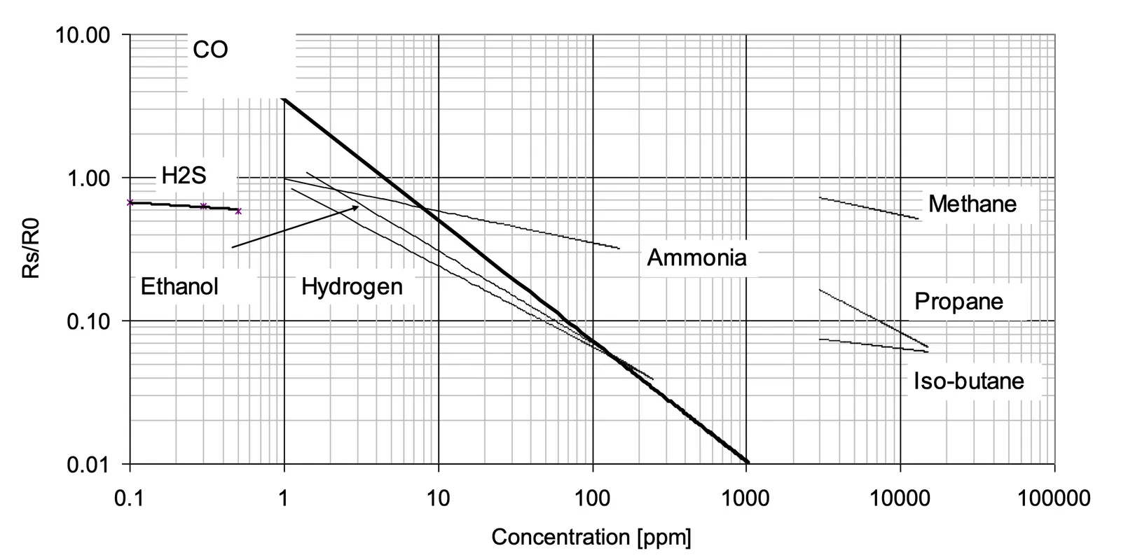

An image showing cross sensitivities of a gas sensor
A list of cross sensitivities for a gas sensor.
Now that we’ve covered how calibration depends heavily on particle type (and how PM₂.₅ itself is a wildly diverse category) it’s worth looking at another assumption that causes a lot of confusion: the idea that sensors measure only the pollutant written on the label. It would make perfect sense for a CO₂ sensor to measure CO₂ and for a VOC sensor to measure VOCs accurately and consistently. But in reality, many low-cost sensors respond to far more than their intended target pollutant. This behaviour is known as cross-sensitivity, and it’s far more common than most people realise.
Metal–oxide sensors (MOS) are the most notorious example. These are the little “VOC” sensors found in most affordable indoor monitors, and while they’re often marketed as detecting “chemicals,” “formaldehyde,” or just general “air quality,” what they actually measure is broad chemical reactivity. Ethanol from hand sanitiser, perfume, lotion, cooking fumes, sweat, cleaning sprays, air fresheners, even humidity fluctuations - all of these can trigger a spike. Even a ripe banana can set off a “poor air quality” warning on many inexpensive VOC monitors just as easily as a solvent.
The same issue appears, sometimes even more dramatically, in cheap “CO₂” monitors that don’t measure CO₂ at all. Instead, they report eCO₂ (equivalent CO₂), inferring levels from VOC reactivity. Walk into a room wearing perfume or spray an air freshener, and the “CO₂” reading can jump by hundreds or even thousands of ppm. These monitors aren’t malfunctioning, but rather, they’re doing exactly what their underlying sensor is designed to do. The problem is that many consumers don’t know the difference between true NDIR CO₂ sensors and eCO₂ algorithms, and manufacturers rarely make this distinction clear (especially if they're selling a device with an eCO₂ output) .
Even the other sensor families aren’t completely immune to cross sensitivities. NDIR CO₂ sensors can be affected by humidity and temperature. PM sensors can show false spikes from fog, steam, or high humidity. MOS sensors drift as their reactive layer ages. No sensor is perfectly isolated.

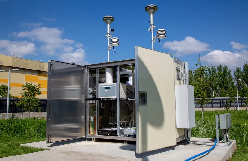

A reference-grade monitor
After looking at consumer monitors, it’s natural to assume that at least reference monitors - the large, expensive, regulatory-grade instruments used by governments and research institutions - must represent the “true” concentration in the air. These devices are often used as the benchmark in studies comparing low-cost sensors, and they typically cost anywhere from $20,000 to $100,000. Because of this, many people understandably see them as infallible and assume their readings are the ultimate ground truth.
However, the reality is more nuanced. First, “reference monitor” is not a single category. There are Federal Reference Method (FRM) instruments and Federal Equivalent Method (FEM) instruments, and they rely on very different measurement principles. For example, beta attenuation monitors (BAMs) measure particle mass by detecting changes in radiation absorption on a filter, while regulatory-grade optical counters use laser scattering to infer mass from light interactions. These instruments behave differently under different conditions: BAMs often show more noise at low concentrations, while optical methods can struggle with high concentrations or particle types that absorb light strongly, such as soot.
Complicating things further, reference instruments still depend on calibration choices, aerosol type, and assumptions about particle density and refractive index - the very same limitations that affect low-cost sensors. A BAM calibrated on one aerosol type may behave differently when the ambient particle mix changes. Optical FEMs can shift noticeably depending on humidity or aerosol composition. Even things like maintenance intervals also influence accuracy.
When two reference instruments sit side by side, it’s not uncommon to see 10–30% differences between them, even though both are performing within specification. This isn’t a sign of failure but instead it’s a reflection of the fact that no instrument measures “true PM₂.₅.” They each measure PM₂.₅ according to their approved method, but each method still has its own strengths and blind spots.
So yes, reference monitors are the closest thing we have to a trusted standard. They are well-characterised, stable, and proven in regulatory environments. But even they operate within a world of assumptions, calibration decisions, and environmental constraints. Instead of thinking of reference monitors as perfectly accurate, it’s more accurate to treat them as the most reliable starting point, not an absolute truth.

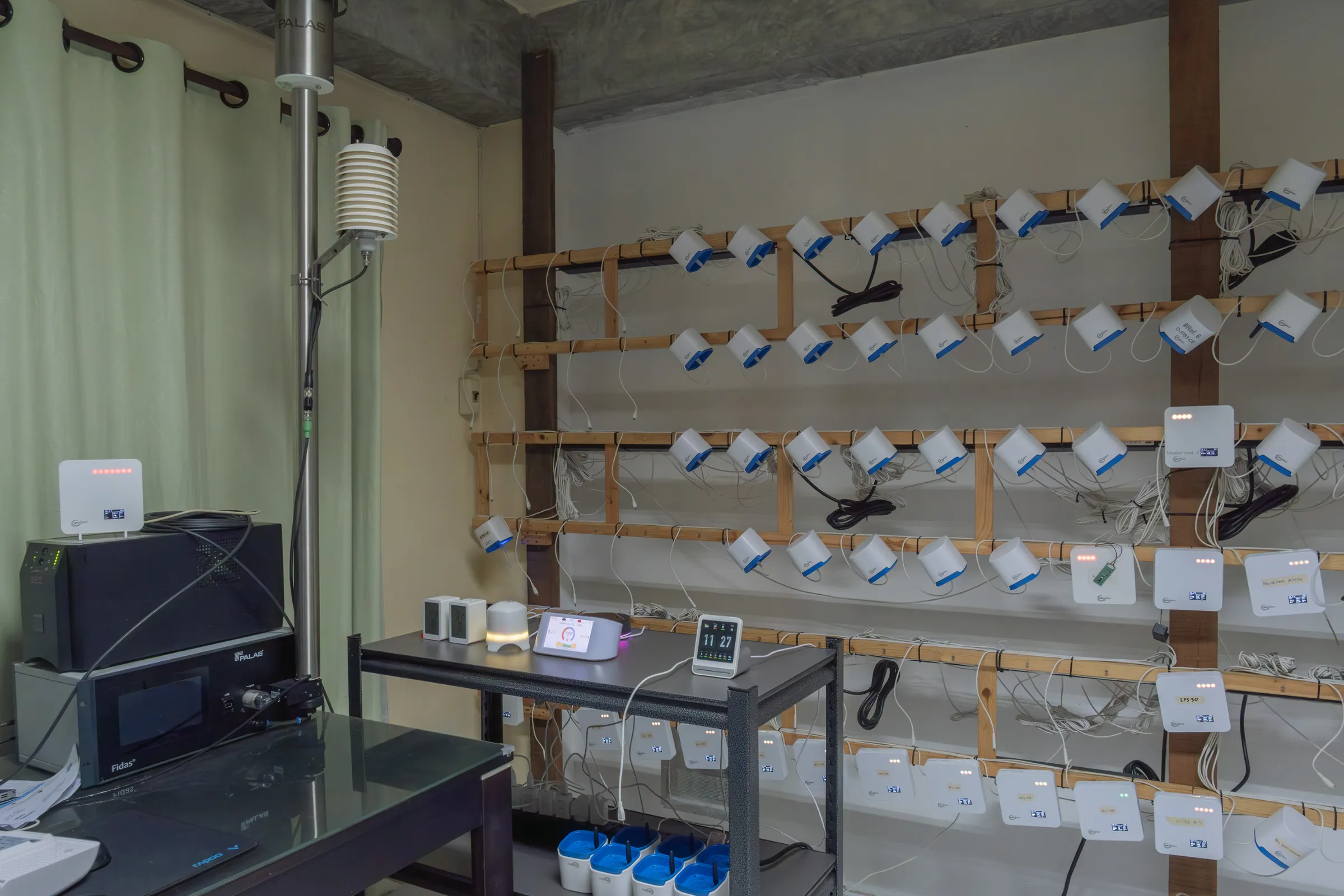

Testing air quality monitors against a reference
If this article makes air quality monitoring sound complicated, that’s because it is complicated. Each myth on its own might seem harmless, but when you combine them and they compound, they can seriously reduce how useful a monitor is in practice. The devices themselves aren’t the problem; it’s the layers of misunderstanding that build up around them.
These issues are exactly why we’ve chosen to approach things differently. We design and build our monitors ourselves, test every sensor, document our calibration procedures, and work closely with researchers who help us validate and continually improve our methods. Our hardware and firmware are open source because transparency is the only way users can truly know what their device is doing and where its limitations lie. And importantly, we focus exclusively on air quality monitors. We know how much work it takes to make these devices accurate and trustworthy, and splitting our attention across unrelated products would compromise that.
