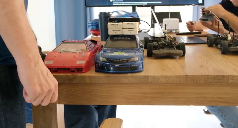

To explore this further, we mounted multiple sensors that we were considering using in the Go inside our first enclosures and attached them to a small RC car. By driving the rig through tunnels with very different particle concentrations (including transitions from clean air into heavy smoke) we simulated real-world scenarios where a portable monitor might encounter abrupt environmental changes. All sensors were logged simultaneously at high frequency, allowing us to compare their response characteristics side-by-side.

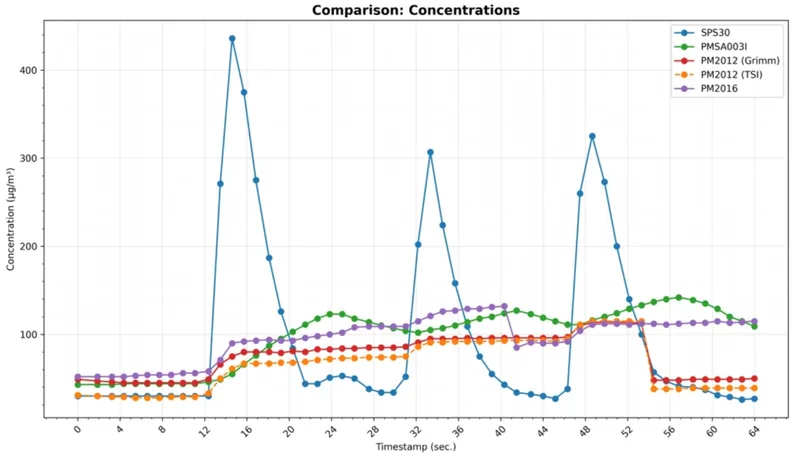

A second test which involved driving the car through a high-concentration tunnel followed by a low-concentration tunnel as quickly as possible. This was repeated three times.
When rapidly entering and exiting tunnels, the Sensirion sensor was the only sensor that identified the spikes and reacted as we would expect. When passing through the clean air tunnel, it was also the only sensor that identified the lower concentration zone.
The Cubic sensors again recognised the increase in concentration, but at this higher speed they didn’t react at the level we would expect and only showed a minor jump in concentration. Again, the Plantower sensor showed a very delayed response and it was clear that some kind of averaging was happening here as there were peaks, but they were quite delayed and occurred when the sensor should have been showing cleaner air instead.

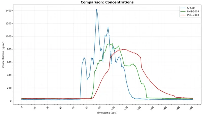

As mentioned, we also tested the PMS5003 and PMS7003 from Plantower as well. Above is a run where we parked the car in the high-concentration tunnel for 30 seconds before driving it into cleaner air again. As you can see, the PMS7003 had the same behaviour as the PMSA003I, and the PMS5003 appeared to have some similar averaging but to a lesser extent as it was better able to show peaks - just at a slower response rate than the SPS30.

To conduct our next test, we let the RC sit at idle before driving it around inside a warehouse. In this area, we expected relatively consistent PM concentrations as there was minimal airflow. In this test, we were looking purely at how the sensors reacted when in motion, so no tunnels were involved.
For this test, we faced the vents backwards off the car similarly to how we would recommend this device be mounted on a bike or other moving object.

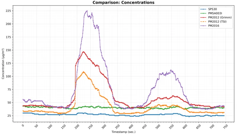

In the test above, we kept the RC car stationary for two minutes, then drove continuously for two minutes, before stopping it again for two minutes. We repeated this test twice. It is important to note that we're unsure to what extent particles kicked up by the RC cars' wheels may have had an impact here, but we ran the test multiple times with sensors in different locations on the test rig.

The Cubic sensors exhibited the worst performance by far. Both sensors (and the PM2012 with both calibrations applied) showed very significant spikes when the car started moving. The magnitude of the spike was consistent with the speed of the car.

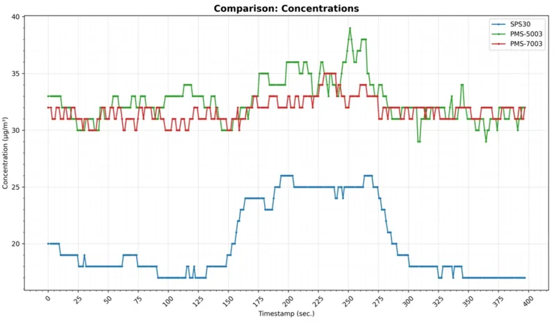

Interestingly, when we ran this test again with the other Plantower sensors, the SPS30 did show that it was impacted either by speed or the vibrations:

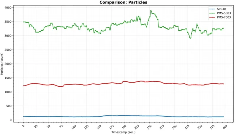

However, when we looked at the particle count from the sensors as opposed to the concentration, the SPS30 was the most consistent:
Although it's very hard to see due to the scale of the graph, there was a jump in particle counts recorded by the Sensirion SPS30 between 150 seconds and 300 seconds.
Overall, both the Plantower sensors and SPS30 performed well in this test, but we will need to investigate further why the SPS30 had the most stable particle count, but seemingly the most impacted particle concentration.
