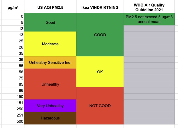

The manual describes the cut-off values for the traffic light as following:
LED indicators for air quality (PM 2.5):
Green: 0-35 /Good + Low
Amber: 36-85/OK + Medium
Red: 86- /Not good + High
Which is very unclear because it does not mention the metric of PM2.5 used. Typically, PM2.5 is either measured in μg/m³ or US AQI. After some research and experimentation, it turns out that it actually measures the air quality in μg/m³.
And this is a problem!

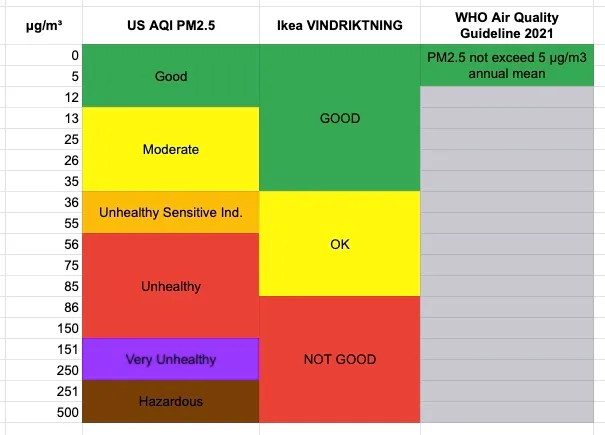

The world health organisation recently updated its air quality guideline and does not recommend that the annual exposure to PM2.5 exceeds 5 μg/m³. However, the Vindriktning shows you a green light until 35 μg/m³ which is SEVEN TIMES the WHO air quality guideline. It is also around 3 times what the US AQI regards as Good.
When the Vindriktning starts to turn yellow (and describes this in its manual as "OK" air quality), we are already in the "Unhealthy" territory as per US AQI.
It turns red at > 85 μg/m³ and describes it in the manual as "Not Good". At this point we are 17 TIMES above the WHO annual recommendations for PM2.5.

In my opinion this is a BIG ISSUE. A green light should indicate healthy air but the Ikea Vindriktning often shows green when in fact the air could already be multiple times outside safe limits defined by the WHO or US AQI. This problem is even more severe because the sensor does not have a numeric display that could show the measured value. Thus a good PM2.5 of 3 μg/m³ has the same green light as a moderate/unhealthy 32 μg/m³ with the customer seeing no difference between the two. This can lead to a false sense of safety and give the impression that the air is good when in fact it is several times outside international standards.
I also think that labelling the yellow light is highly misleading. As per the Vindriktning manual, the sensor shows a yellow light at 84 μg/m³ and Ikea labels that air quality as "OK". New Delhi, being one of the worst polluted capital cities in the world, had an average air quality of 84.1 μg/m³ in 2020. Exactly this air quality would still show as yellow or "OK" on the Vindriktning! Greenpeace India estimated that during 2020, 57.000 premature deaths could be attributed to air pollution in Delhi alone. For me, labelling this air pollution as “OK” is not Ok!
To be fair, the Ikea Vindriktning manual does not make any claim that it measures annual exposures with its color bands and could very well be used as a smoke indicator within the kitchen where you normally have a more short term exposure. However, it could also be used by people permanently and leading them to switch off their air purifier at 35 μg/m³ (when the Vindriktning would show GREEN) with the false believe that the air quality is good when in fact it would still be seven times above WHO recommendations.

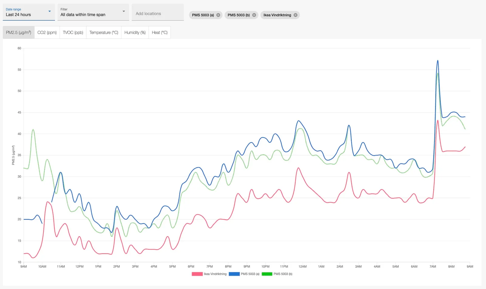

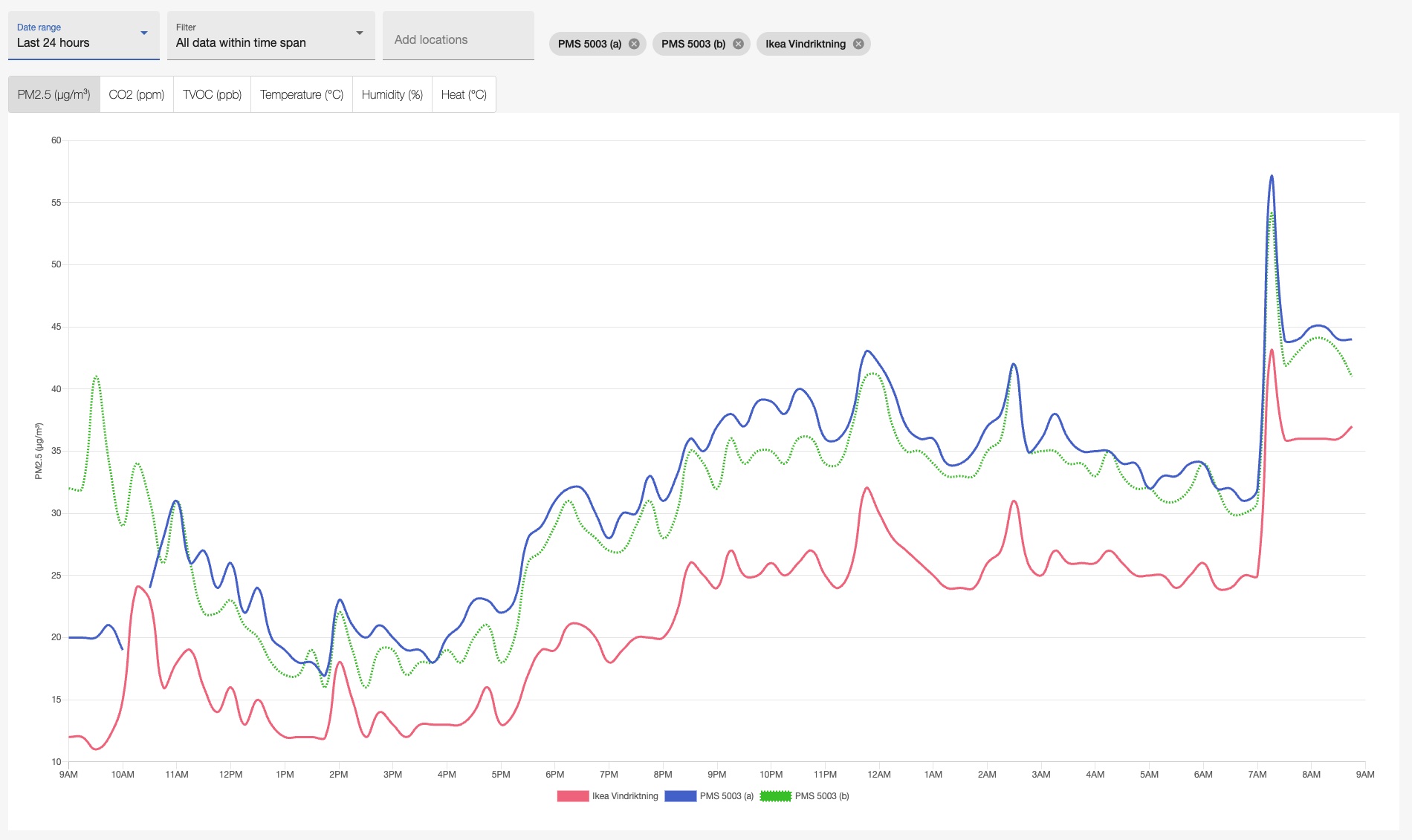

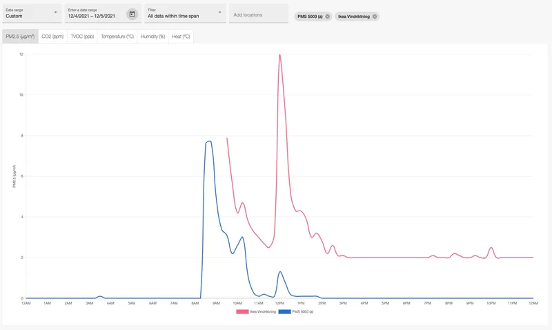

It is easily possible to add a Wemos D1 mini to the Vindriktning and thus enable it to send data to a cloud backend. So I was able to get a constant stream of data from it and was able to compare it to our AirGradient standard sensor which is the Plantower PMS5003 sensor.
The Plantower PMS5003 is one of the best low cost PM2.5 sensors using the laser-scattering method and has been proven to have a good correlation and accuracy compared to reference instruments.
Below is a chart with the Ikea Vindriktning (red) versus two Plantower PMS5003 sensors (green and blue):
pms vs vindriktning mmta4ewi hbwuhkgk
It can be seen that all three sensors correlate very well but that the Vindriktning only shows about 65% of the PM2.5 values of the other two sensors and thus seems to considerably understates the air pollution.

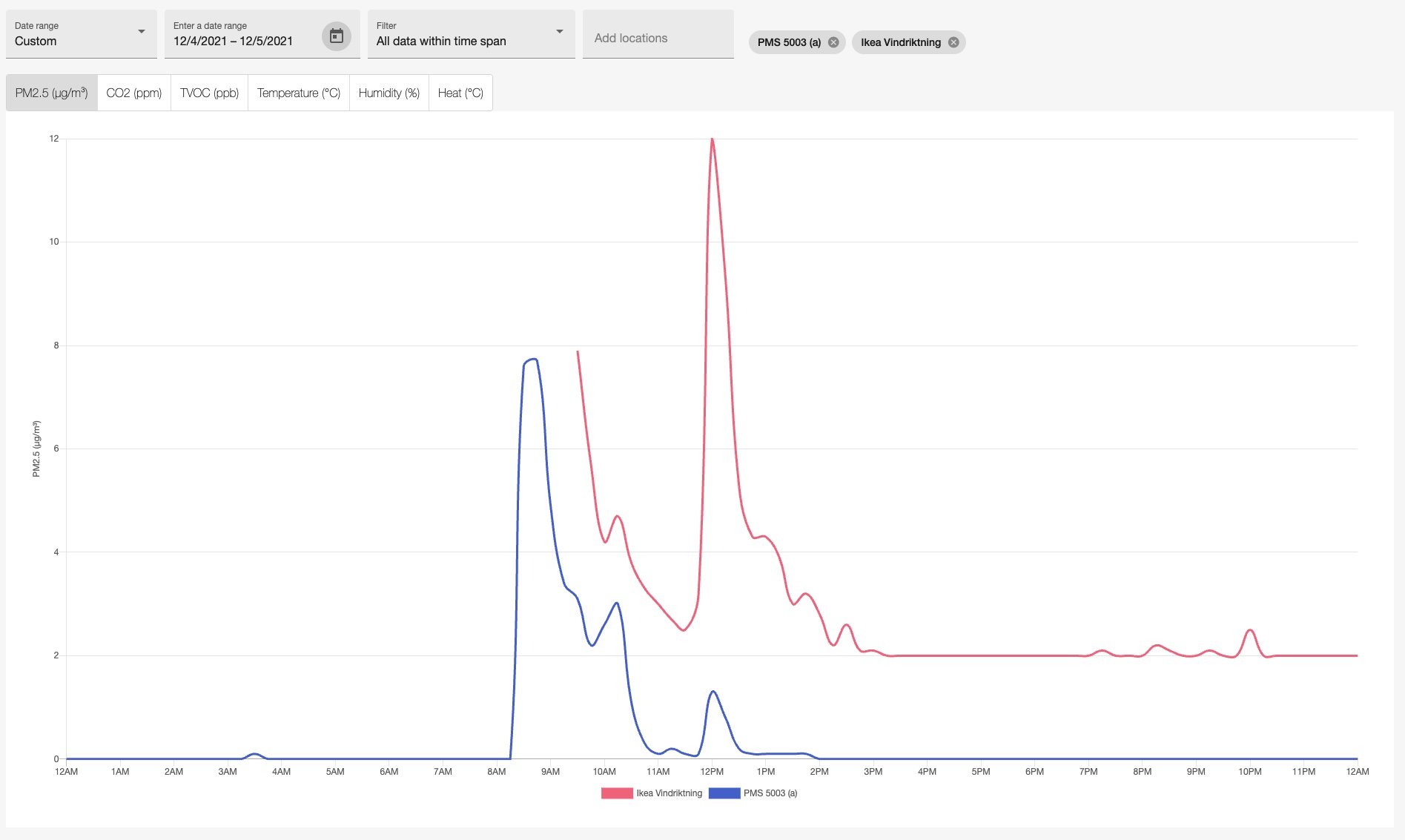

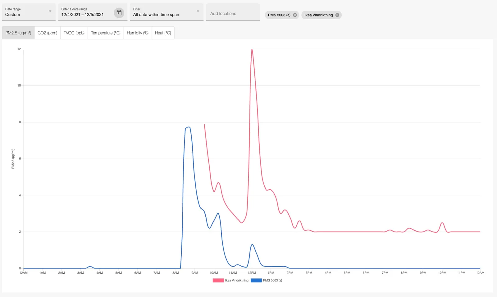

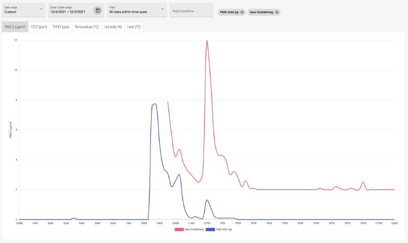

The second test was indoors in an environment where I can reach zero PM2.5 through a professional positive pressure filtration system. Interestingly here we can see the opposite, that the Vindriktning is not able to reach zero readings and is consistently higher than the PMS 5003.
pms vs vindriktning indoors mmta4f64 7y2ibtcf
As per official spec sheet of the PM1006K, the sensor has an accuracy ±20μg/m³ or ±20% of reading and thus -even with the deviations to the Plantower- is still within its specified accuracy.
