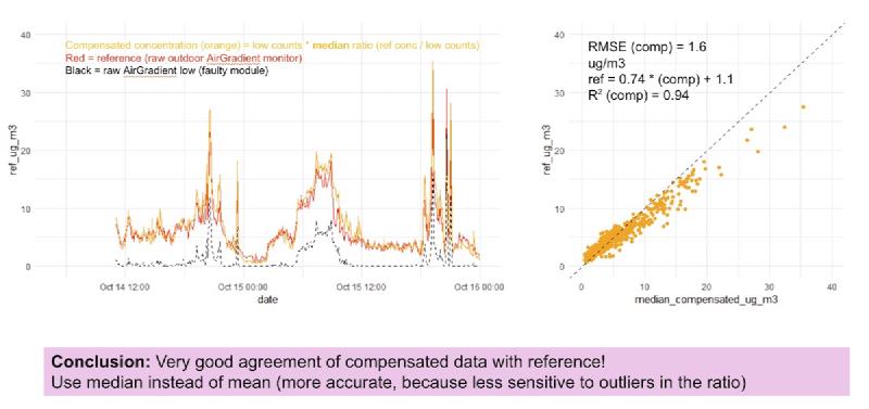

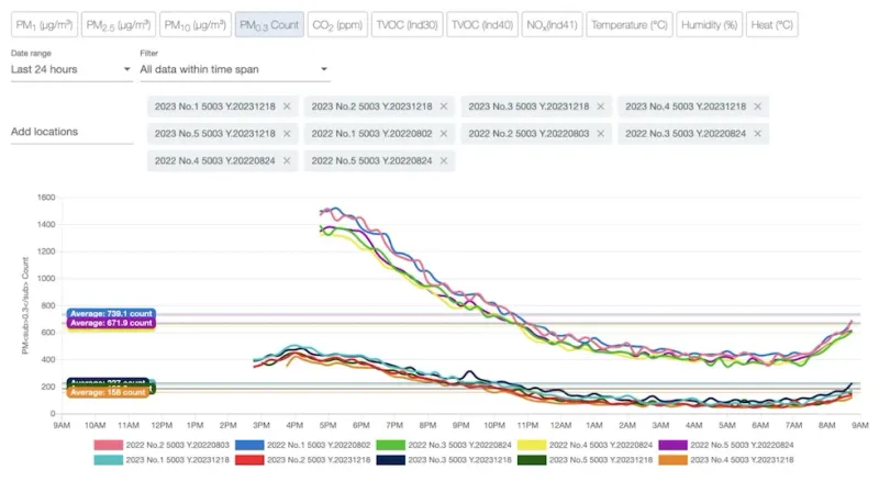

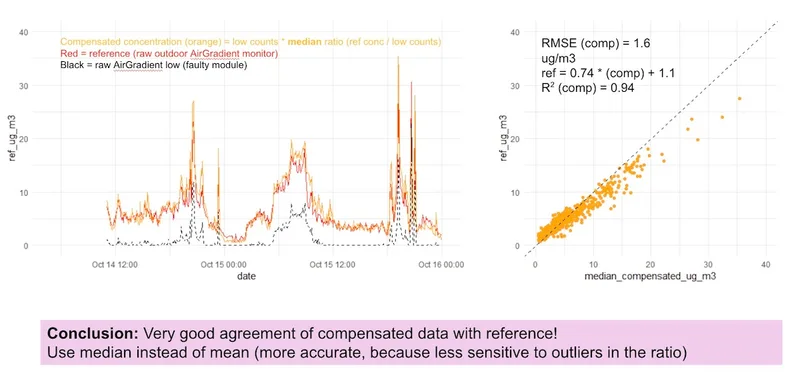

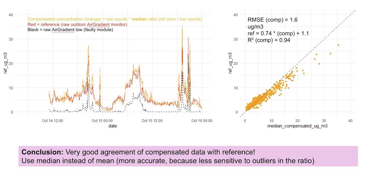

Above is a graph showing one of the problem monitors (in black), a working monitor (in red), and a problem monitor with our compensation applied (in yellow).
With our very limited datasets, we found that the PM0.3 count (which is still shown on these sensors, albeit at far lower counts than usual) can have a correction factor applied to obtain very similar results to a working PMS5003. Anika and Siriel from our science team have worked hard to get these correction factors worked out, and we believe we are now on the right track.
While most people are acquainted with PM2.5 concentration, we needed to use the PM0.3 count for this correction factor. The issue is that many of the problem monitors show a particle concentration of 0ug/m3. With such a low concentration, no matter what correction factor is applied, the end result will still be 0. On the other hand, we still see PM0.3 counts, albeit very low ones, with these monitors.
With this correction factor applied, we see an R² value of 0.94, which shows a very high correlation between the working and corrected monitors. In fact, the R² is so high that it’s very similar to what we see on our monitors that are working as intended. As such, we believe this correction factor works very well.

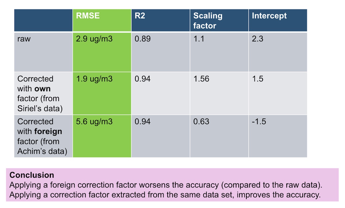

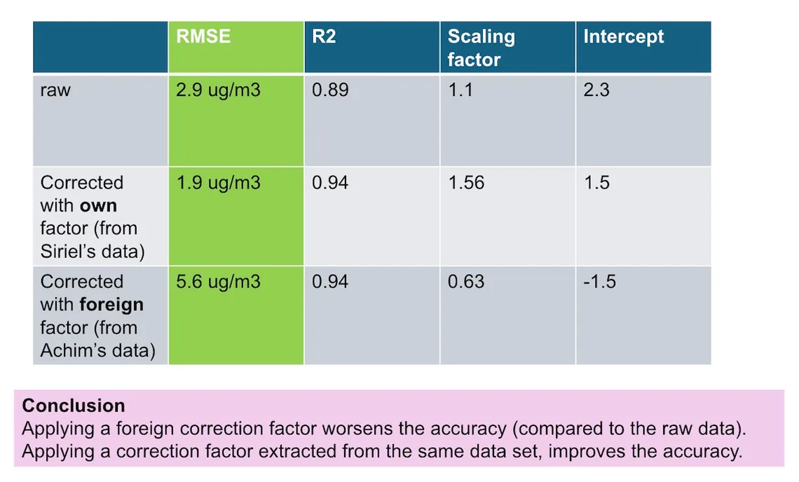

This concept works across different monitors, but the correction factor is inconsistent. In a second case (shown below), Siriel has two monitors colocated - a (working as intended) Open Air monitor and a (miscalibrated) ONE. When we apply the correction factor from the previous data set, we get a greater RMSE (Root Mean Squared Error) than we do with the raw data. However, if we apply a correction factor extracted from the same dataset, we get a significantly improved RMSE. We believe the correction factors may be based on the shipment the sensor came from.
pms overview
Again, please note that these findings are preliminary, and we currently have very limited datasets to work with. If you happen to have an AirGradient ONE with a problem sensor and either an Open Air or a working AirGradient ONE and want to help us identify the issue and improve our correction factors, please feel free to colocate them and reach out to our customer support team with the monitor’s serial numbers so we can investigate the issue further. Any help we can get would be greatly appreciated!

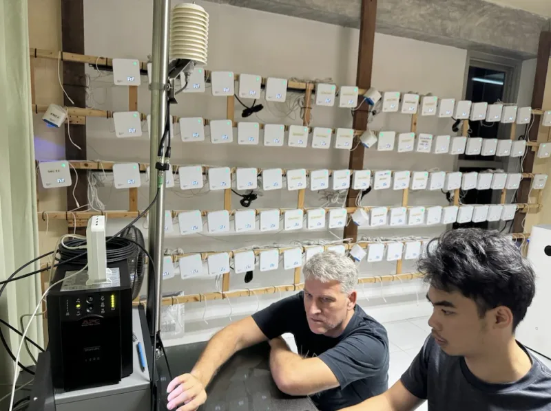

Below, you can see an image of Nick and Guide in our testing facility in Chiang Mai calibrating the Palas Fidas. The wall behind them shows monitors we are currently testing

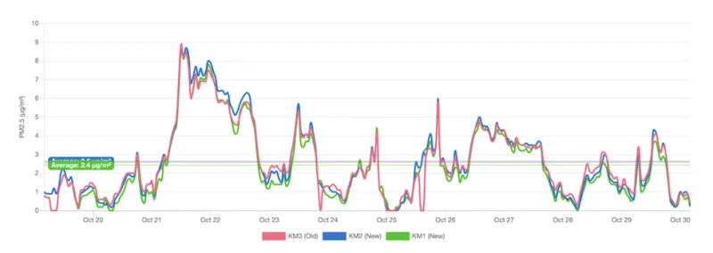

To further test that this formula and values work correctly, we’ve been testing some monitors from different batches. Below, you can see how the application of above algorithms aligns the different batches. As you can see, the formula corrects the errors very well and these results show precision similar to what we would expect between two sensors working as intended.

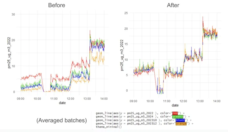

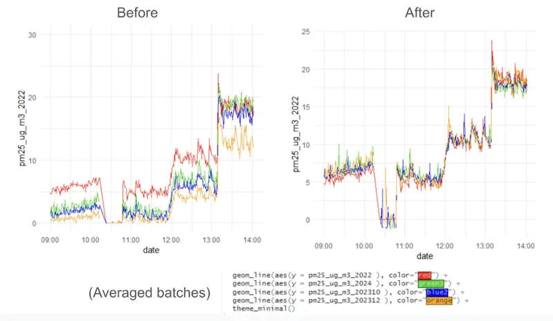

Below you can see the differences these updated corrections have had. The red line represents a working-as-inteded monitor, while the other two lines are monitors with sensors from the 20231218 and 20231030 batch.
Before:
before31pm
After:
after31pm
As you can see, after these correction formulae changes were applied, the data fits much more closely with the reference data.

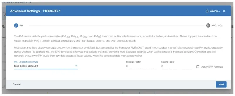

We have released a dashboard update for all users and you can now select the correction factor if you have an affected sensor.
Here are the instructions on how to identify and fix this issue.
