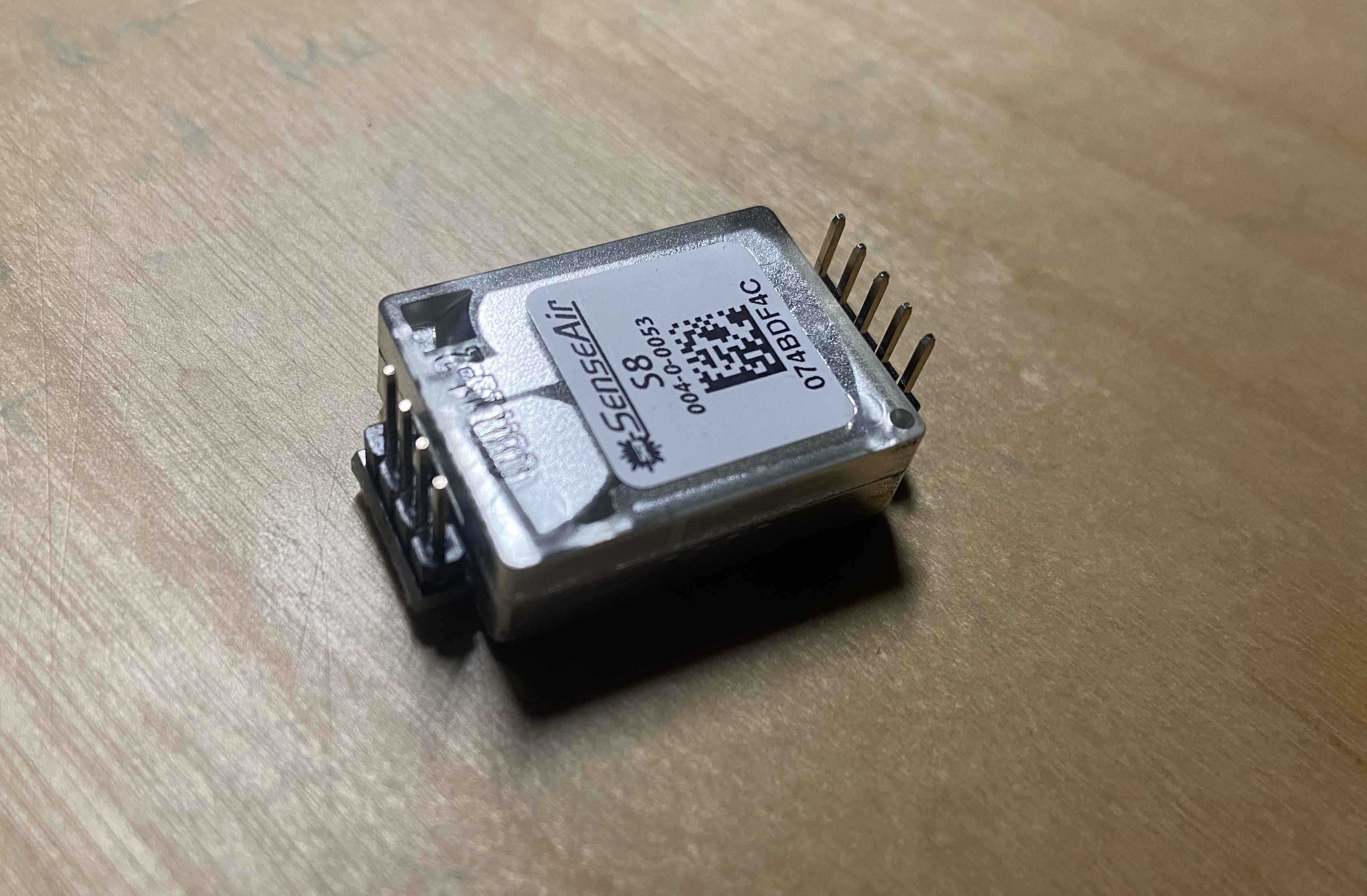

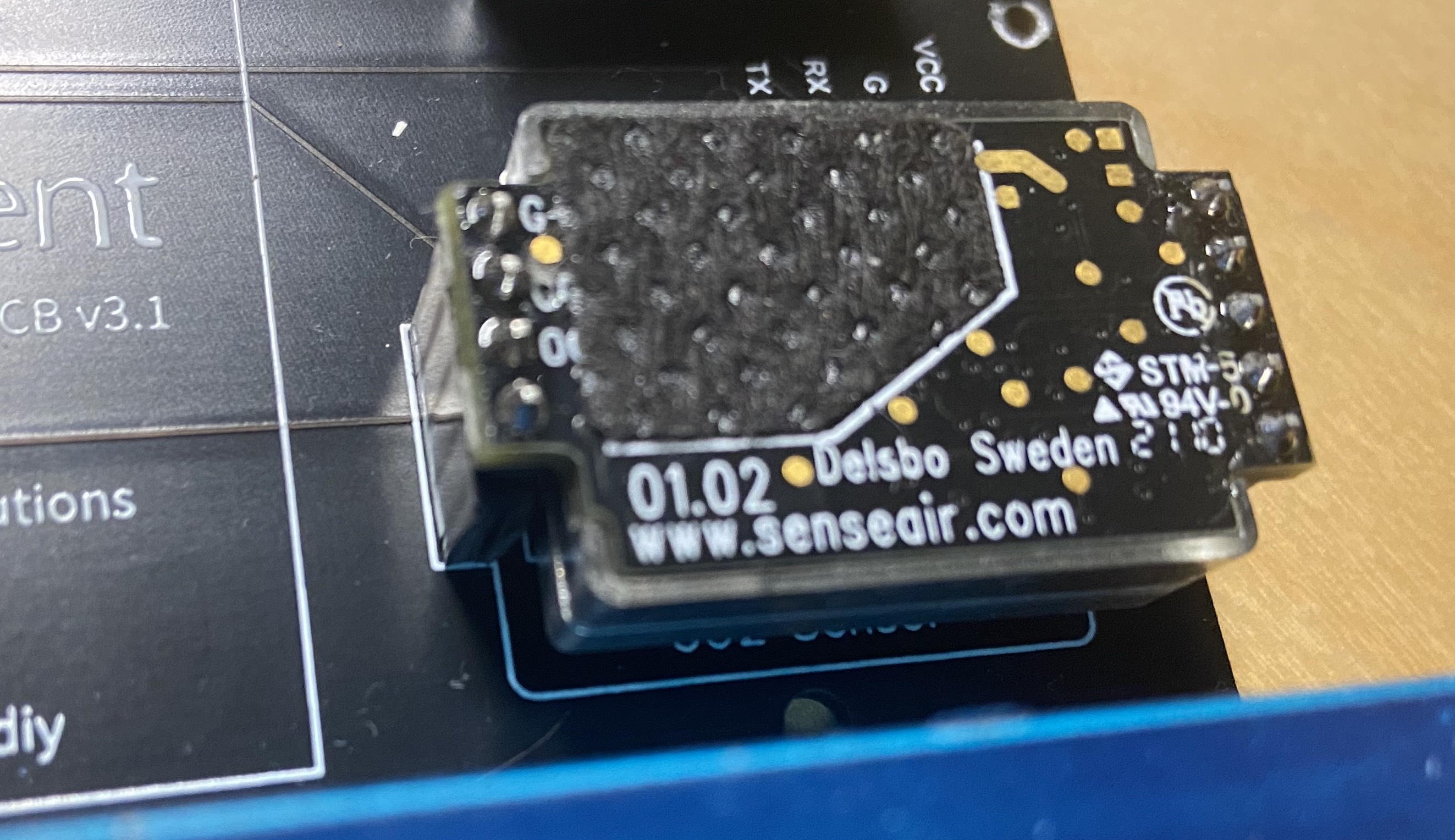

IMPORTANT: CO2 Pins are opposite now:
To comply with the official mounting instructions of the Senseair S8, we have changed the assembly orientation compared to the old DIY kit. So if you use the conversion kit and want to reuse the old S8 module, you need to re-solder the male pins on the opposite side.
It should look like this for the new kit:
S8 module
s8new mm4ewe18 w3rae2jb
S8 module assembled on female pin headers on the new PCB.
s8onpro mm4eweol rb29pkjv
Use female pin headers:
I would recommend that you use female pin headers for all sensors and the Wemos D1 mini. Thus way you can easily remove sensors and components and troubleshoot or repair your sensor much easier. Please also note that with the new pin orientation on the S8 sensor, you can only mount it with the female pin headers.

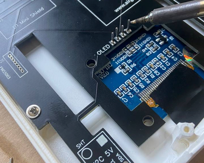

Soldering in the OLED display:
To solder in the OLED display please follow these steps:

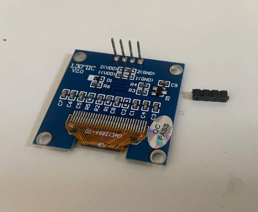

  1. remove the black spacer
1 mm4ewf55 xuiml8fj

  1. To make good contact, solder on the opposite side
5 mm4ewfix 0deye59v

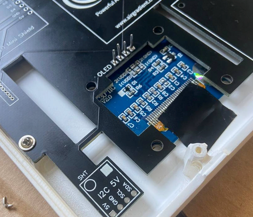

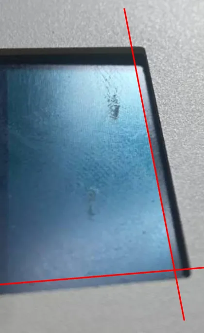

  1. Put the OLED display through the PCB and mount it into the enclosure. Always use the same enclosure top for the soldering jobs as the soldering might create heat points on the enclosure. Make sure you tight all four screws of the PCB. Move the OLED so that it is correctly aliged and fix it temporarily with a tape
6 mm4ewfkm q1qvnq9j
  1. Check that the display is aligned from the opposite side
7 mm4ewfrj 8rc1n178
