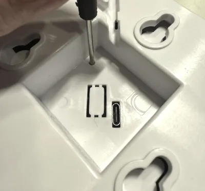

Please follow these steps for flashing:
  1. Push the reset button and keep it pushed. The button can be pressed with a small screwdriver through the small hole at the back of the monitor.
  2. press flash button
  3. Plug in the USB C cable into this computer
  4. Release the button. If you do not do this, the board will not get into the flash mode.
