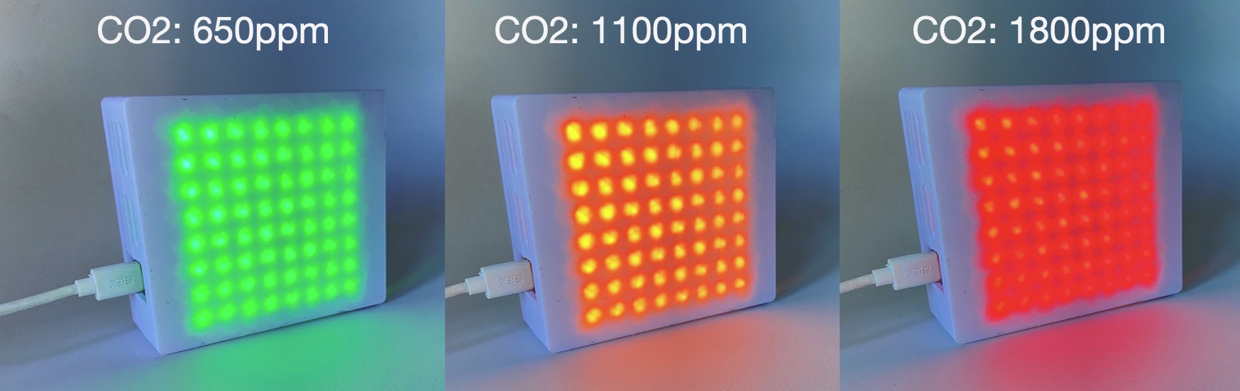

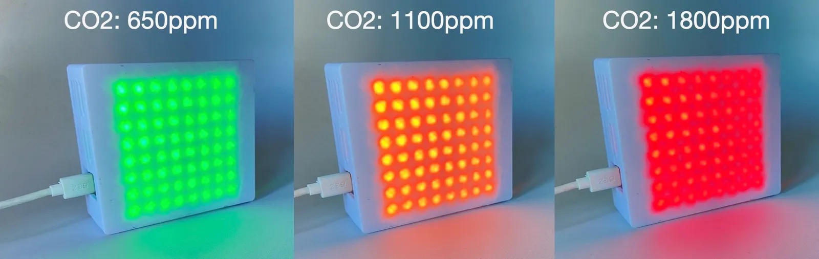

Adjusting the CO2 traffic light color bands
You can easily adjust at what levels of CO2, which color should be displayed. Just adjust the values in the code block that looks like below.
if (CO2 > 1200) {
showColor("red");
} else if (CO2 > 800) {
showColor("orange");
} else {
showColor("green");
The default is green <=800ppm CO2, yellow between 800 and 1200 ppm and red above 1200.

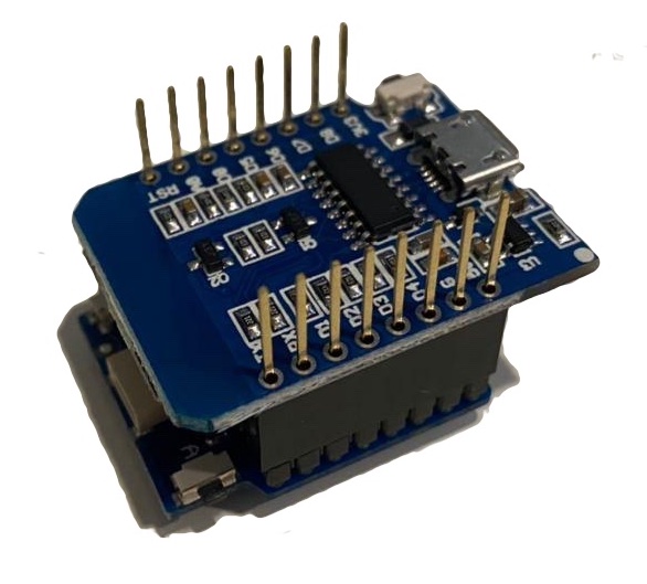

Wemos D1 Mini Soldering

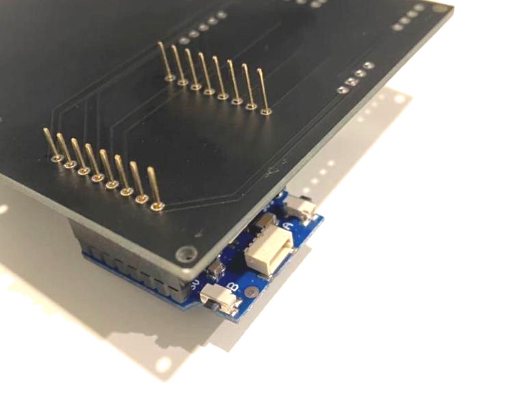

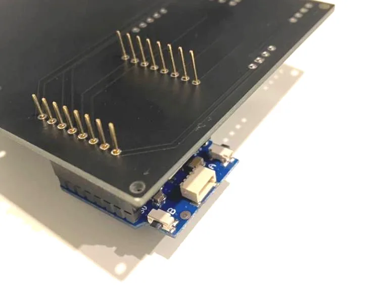

Put the long female and male pins through the D1 Mini. Make sure that the female parts are on top of the D1 Mini as shown on this image:
Wemos D1 Mini Soldering onto PCB
The next step is to solder the D1 Mini onto the PCB. Please make sure you solder it the correct way. The micro USB port needs to face outwards. You can also compare the PIN labels on the PCB with the ones on the D1 Mini.
You can either solder the D1 Mini directly onto the PCB or use the pin headers as a socket. If you solder it directly, please leave a small gap between the PCB and the D1 Mini to make sure the plug is accessible.
Important. If you use the display or RGB led shield, you need to solder the D1 Mini directly on the PCB without the pin headers as a socket as otherwise it becomes too high and does not fit the enclosure.

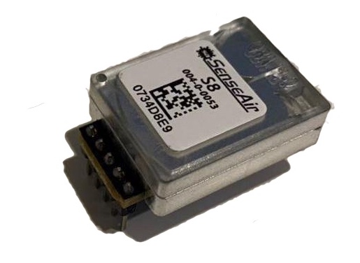

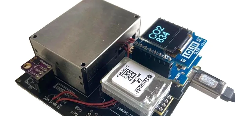

Soldering the Sensirion S8 Module (CO2 Sensor)
To solder the small pins onto the S8 module, you can use a breadboard again to fix it into place.
Please make sure that the PINS face downwards as can be seen on this image.
Then solder the CO2 sensor onto the PCB. It is important that the bottom side of the CO2 has enough air flow. So make sure the gap is sufficient. It might be a good idea to put it on a female pin socket but you can also solder it directly. You can use the pin that came with the D1 Mini but you need to cut them off to the required length.

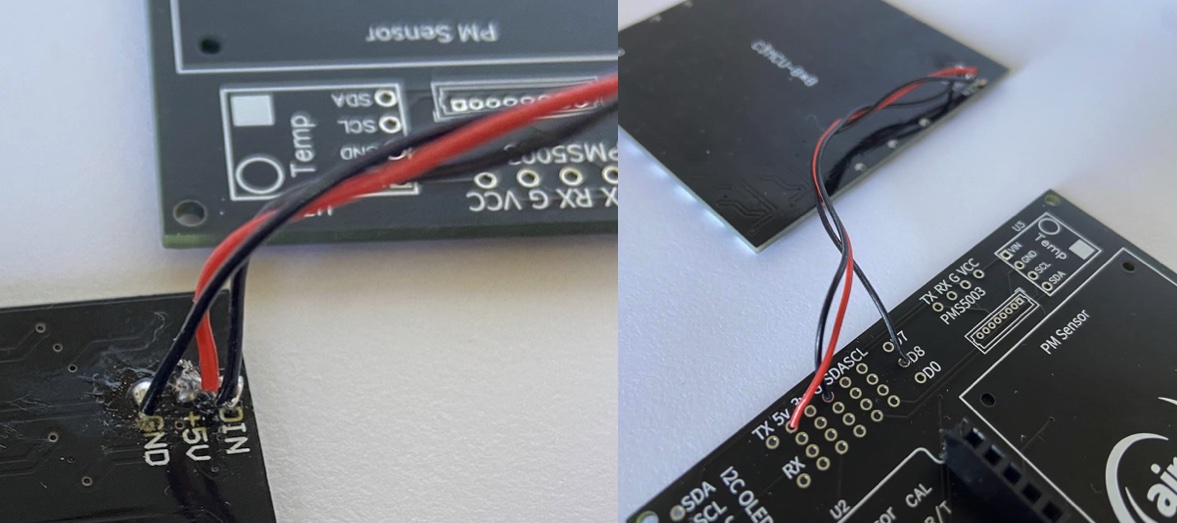

Connecting the LED matrix to the board
Take a 3 wire low voltage cable, around 10cm. Solder one part to the LED matrix. Important please make sure you soldet it to the pins labelled DIN.
Then solder the other end of the cable to the through holes of the board.
Please ensure that you connected the cables the following:
| AirGradient PCB | LED Matrix |
| 5v | +5V |
| G | GND |
| D8 | DIN |

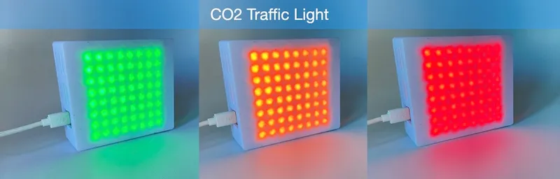

Done & Enjoy

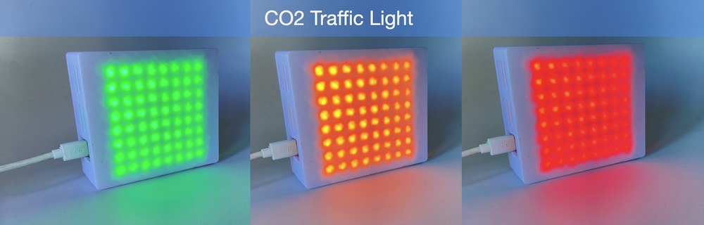

That’s all and you can now connect the AirGradient DIY CO2 Traffic Light with power and after a short while the LEDs will light up. If you flashed the Wifi version, you need to connect the D1 Mini to wifi. To do this open youw Wifi Settings on the phone and look for a hot spot called “AirGradient xxx”. Then connect to it and enter your Wifi network credentials. It will then connect to Wifi and start sending the air quality data.

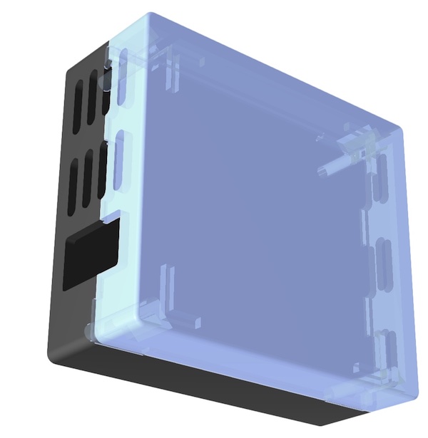

3D Enclosure and Mount
We have created a 3D printable enclosure that exactly fits the LED matric and the AirGradient DIY board consisting of a top and bottom part.
