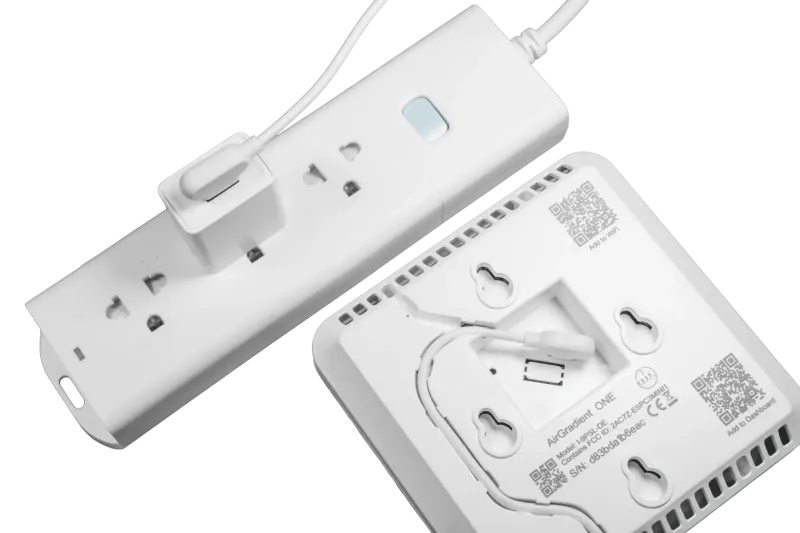

  • Plug the ONE into a stable USB-C power source.

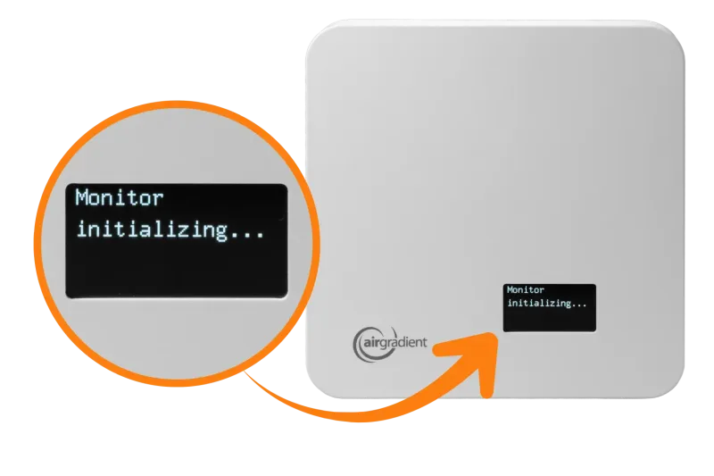

  • The device display will show initialization messages.
Alt text

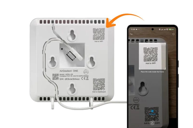

As mentioned in the Video Guides section above: All pre-assembled AirGradient ONE units include a QR code printed on the back of the enclosure. Scanning it connects you directly to the device’s WiFi hotspot. You can still join the hotspot manually if you prefer - the setup process is otherwise identical.
Option A: Scan the QR Code (pre-assembled units)
Scan the QR code on the back of the enclosure.
Alt text

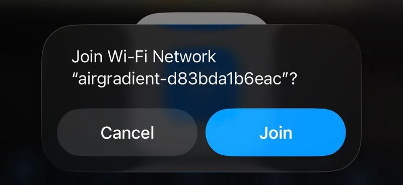

Your phone will prompt you to join the WiFi network:
Alt text
Tap Join (this skips the step of manually locating the hotspot)

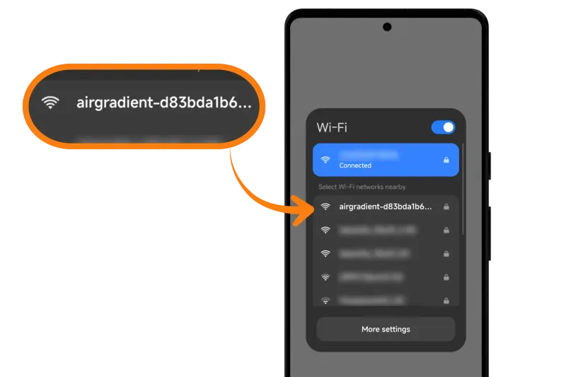

Option B: Join the Hotspot Manually (all units, including DIY kits)
Open your phone, tablet, or laptop WiFi settings.
Look for and select the network:
airgradient-xxxxxxxxxxxx

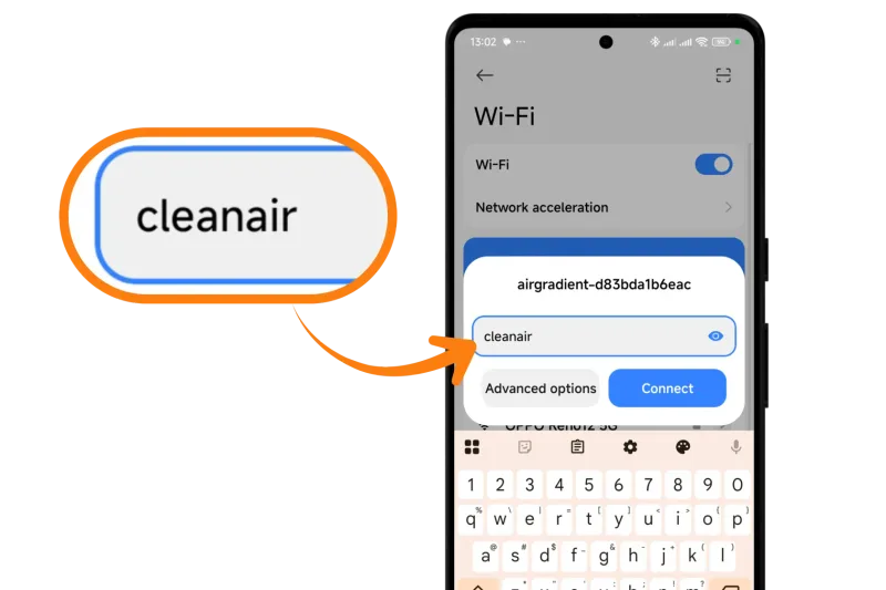

Alt text
Enter the password:
cleanair
Alt text

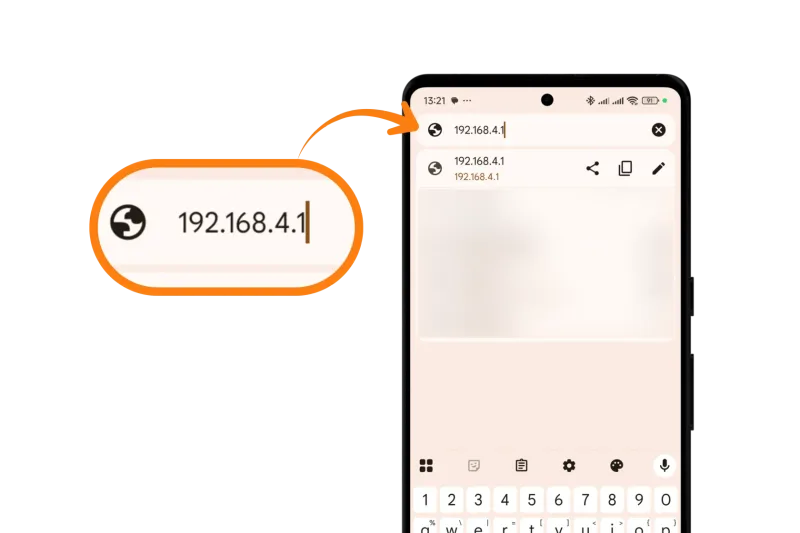

Once connected to the hotspot, the WiFi Manager should open automatically within ~10 seconds.
If it doesn’t:
Open a browser.
Go to:
192.168.4.1
(Enter it in the address bar, not a search engine.)
Alt text
  • Make sure you are still connected to the device hotspot. On iPhone, see the iOS notes above if the phone switches away from the hotspot or 192.168.4.1 does not load.

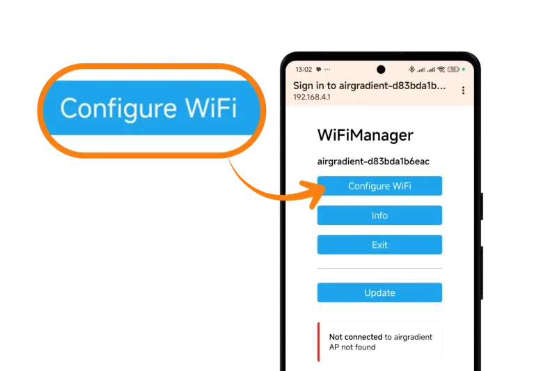

On the WiFi Manager page:
  • Tap Configure WiFi
Alt text

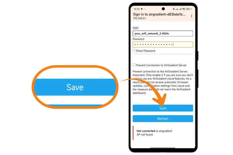

  • Enter your WiFi password
    (Enter the password for your WiFi network. Do not enter ‘cleanair’ here—that password is only for connecting to the device hotspot.)
  • Ensure “Prevent connection to AirGradient servers” is unchecked, if you want the devices to connect to the AirGradient dashboard and receive automatic firmware updates.
  • Tap Save
Alt text

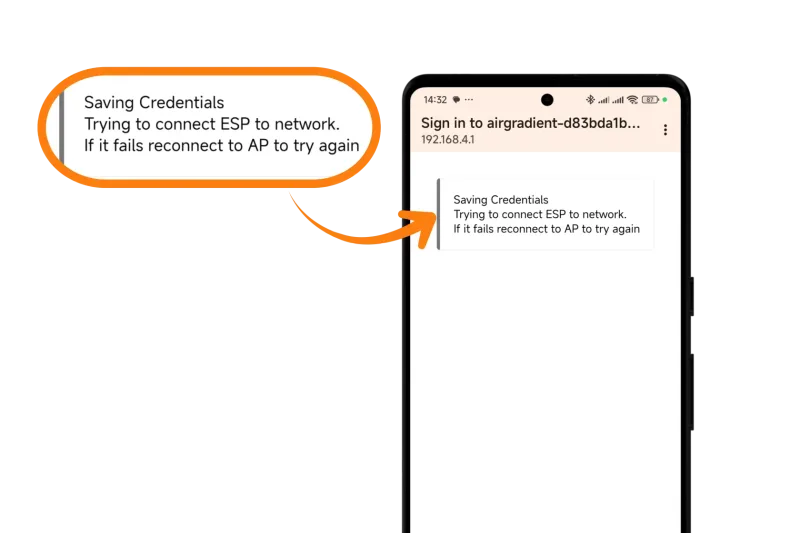

1.5 Credential Saving & Expected Behavior
You’ll see:
saving credentials…
Stay on this page. Do not disconnect.
Alt text
  • If the password is correct → the window closes automatically.
  • If incorrect → you are returned to the network list.
  • If the captive portal times out → the device reboots. Reconnect to the hotspot and start again.
  • If the window closes without showing “saving credentials…” → it still means success.
“No Internet Connection” warnings: Totally normal. Stay connected to the hotspot until the process completes.
