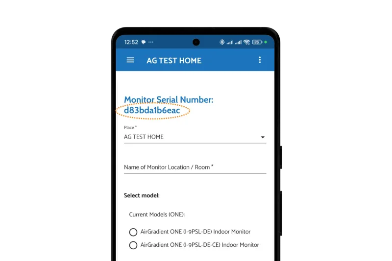

1 - Scan the Add to Dashboard QR code
Alt text
2 - You will be taken to the AirGradient Dashboard: https://app.airgradient.com/
  • Log in, or create an account if you don’t already have one
  • The monitor’s serial number will be pre-filled

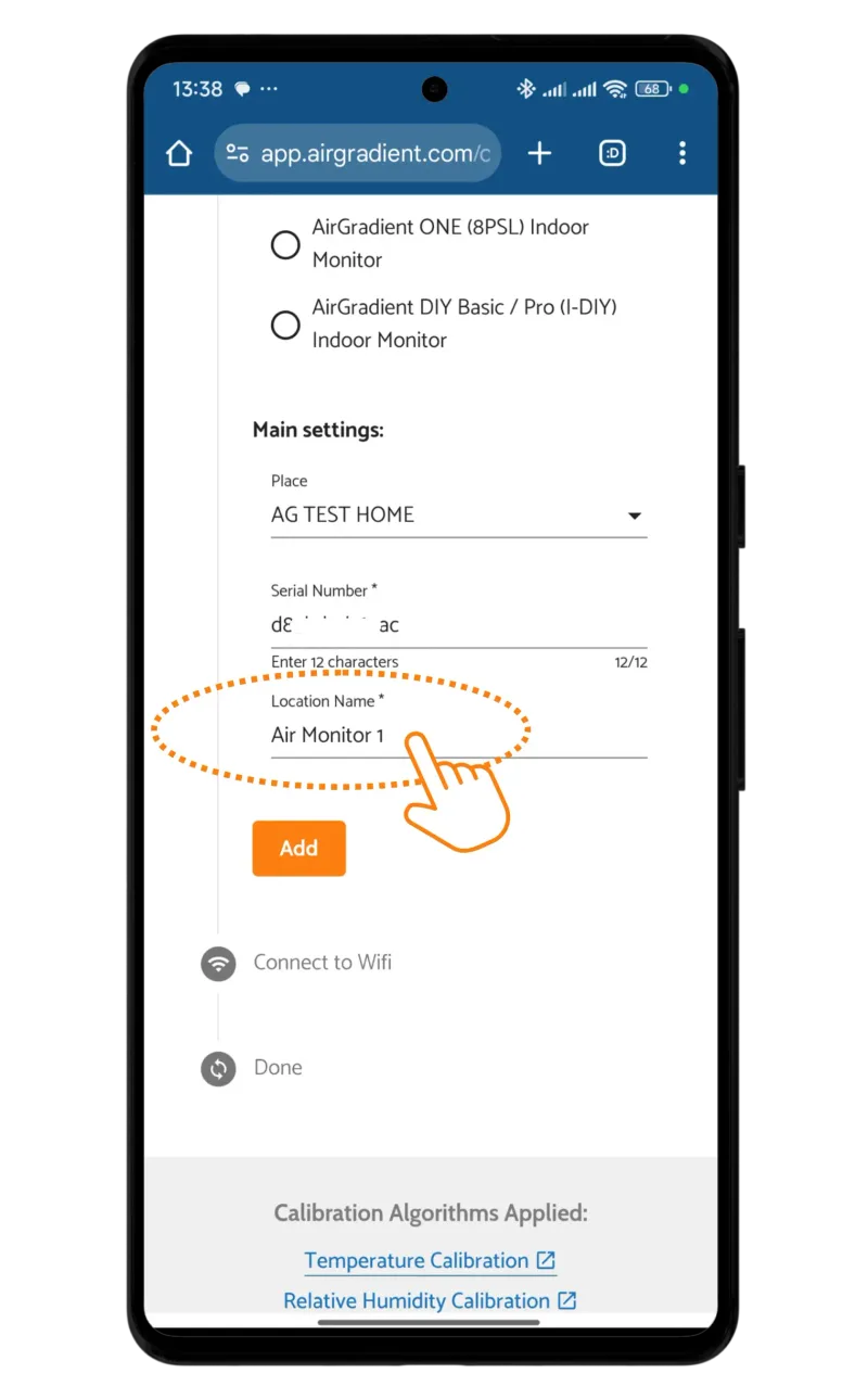

4 - Enter a location name for the monitor
Alt text

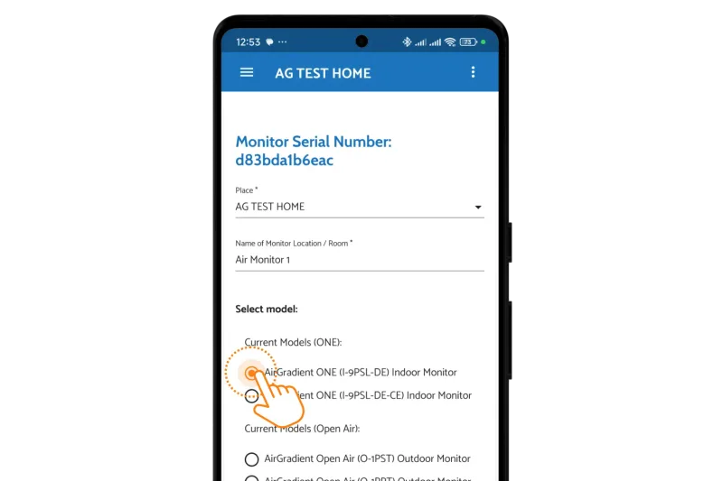

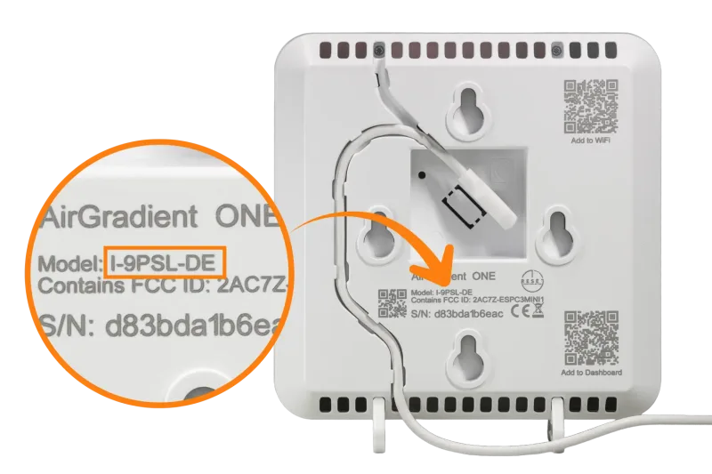

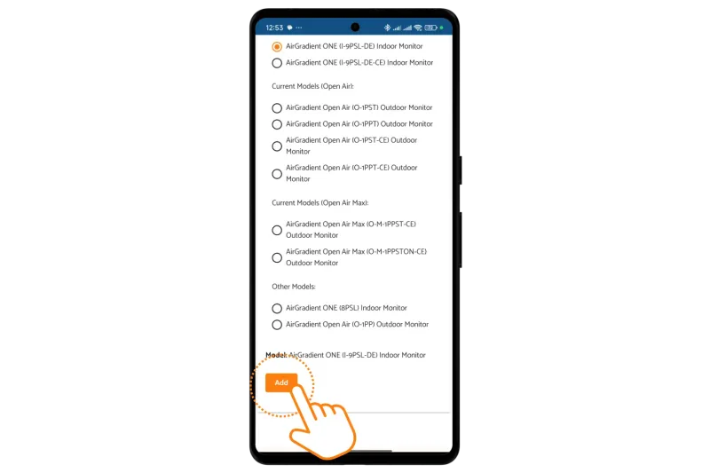

5 - Select the exact model number. For assembled monitors, this is printed on the back of the monitor:
Alt text
If you’re unsure, see: AirGradient Models
Alt text
6 - Click Add
Alt text

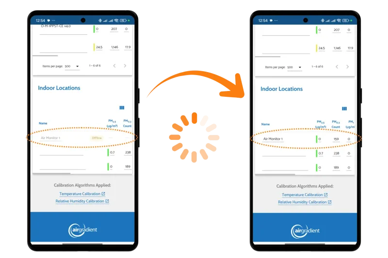

The monitor will now appear in your dashboard. You should see an entry for the monitor on your dashboard, but it will likely show as offline for the first minute or two. Please allow up to five minutes for the monitor to show as online and for the data to begin reporting.
Alt text

3 - Select the exact model number. For assembled monitors, this is printed on the back of the monitor but for DIY kits, it is not. For the AirGradient ONE the latest model number is generally either:
  • I-9PSL-DE (Standard Wi-Fi Version)
  • I-9PSL-DE-CE (Cellular Version)
Alt text

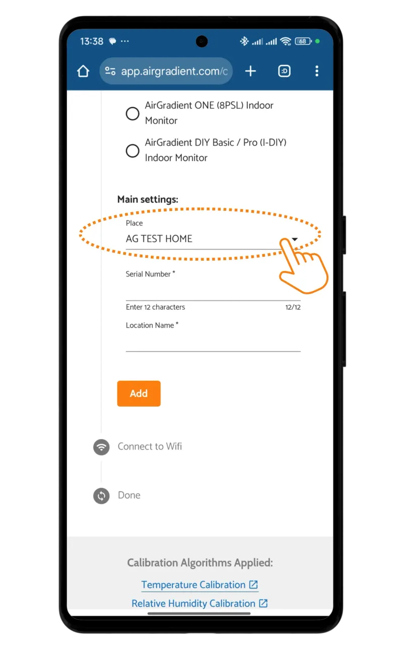

4 - Pick which dashboard (Place) you want to associate the monitor with (if you have multiple) or create a new Place
Alt text

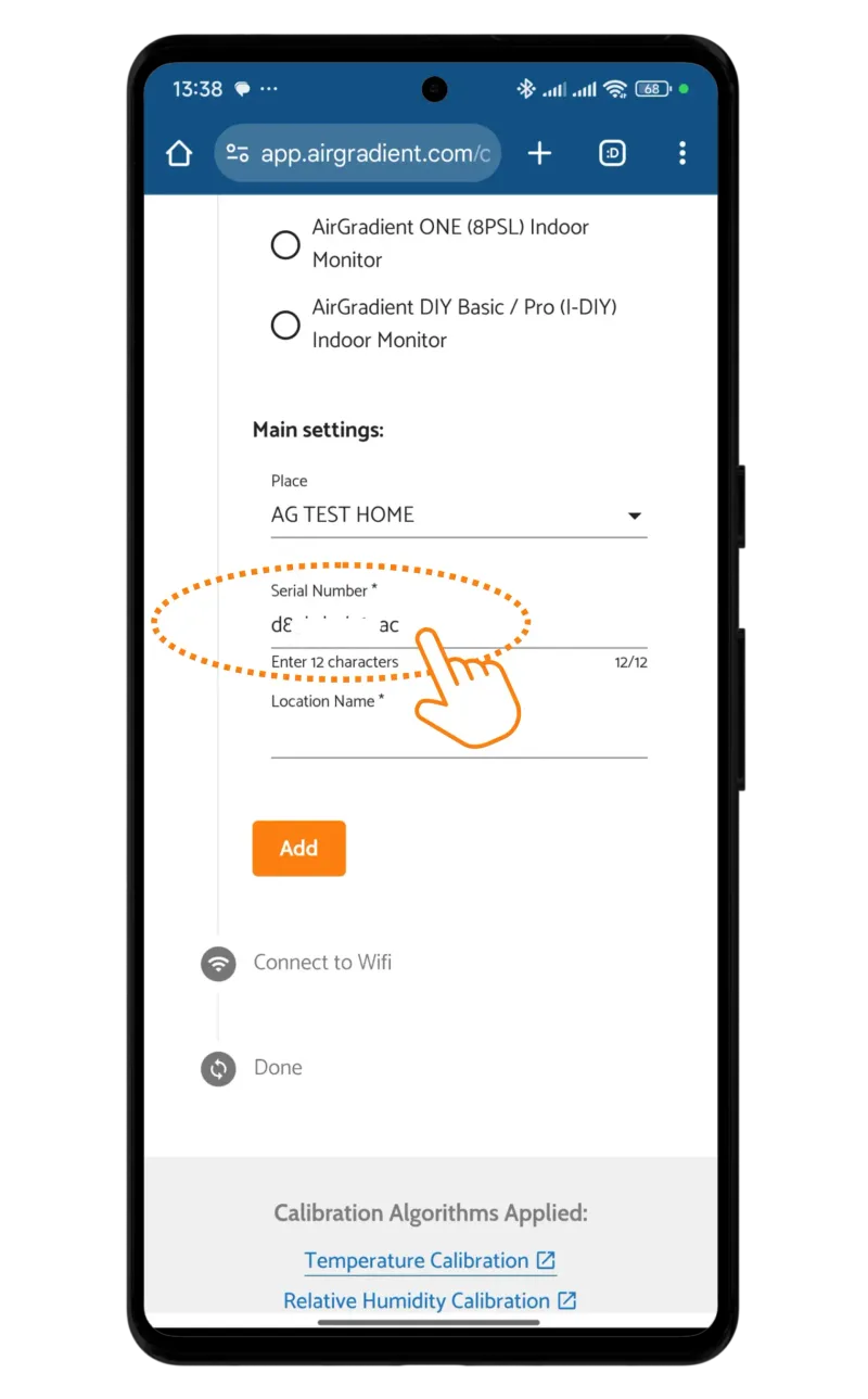

5 - Enter the serial number (SN) of the monitor.
Alt text
For assembled monitors, the SN printed on the back of the monitor but for DIY kits, it is not. To find the SN for the DIY kits, when you startup the monitor, you can see a message “180s to connect to WiFi Hotspot airgradient-xxxxx”. The xxxxx is the serial number of the monitor. Please make sure that you use it in lower case only and also do not use “airgradient-” which is not part of the serial number. So if for example, the display shows “airgradient-625bf2”, then “625bf2” is the serial number.

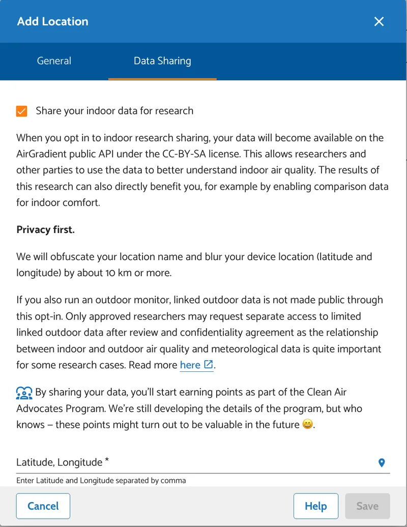

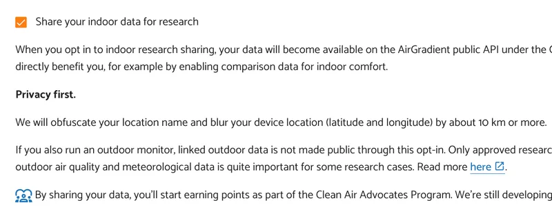

7 - Choose whether to share your indoor data for research
Indoor data sharing is optional. To participate:
  • Check Share your indoor data for research.
Alt text

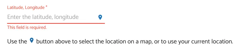

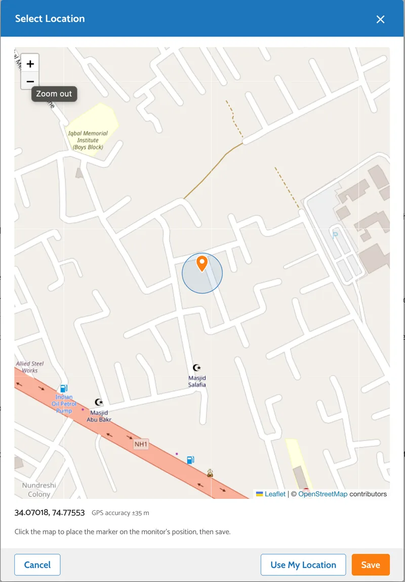

  • Find your coordinates using the location picker:
    • Tap the location pin beside Latitude, Longitude.
Alt text
  • Use your current location or place the pin manually on the map.
Alt text
  • Confirm the selected location by tapping Save.
Alternatively, enter the latitude and longitude manually in this format:
40.1792, 44.4991

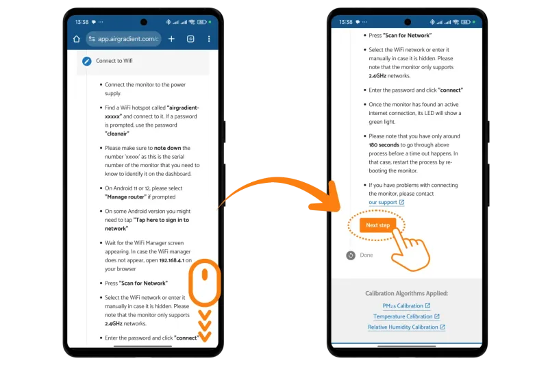

8 - Finally click Add. You will next be provided with the steps to connect the device to your WiFi network. If you’ve already connected the device to your network, you can skip this step and click Next Step. Finally, click To Dashboard.
Alt text
Alt text
If you don’t begin to receive data after five minutes, please confirm that the serial number is correct.

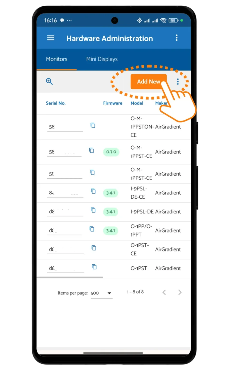

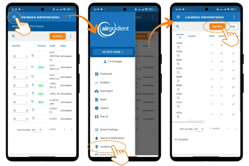

Adding an additional monitor to an existing dashboard
If you already have an AirGradient dashboard and the device is already connected to Wi-Fi:

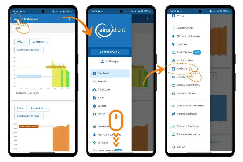

1 - Go to Dashboard > Hardware
Alt text
2 - Click Add New
Alt text

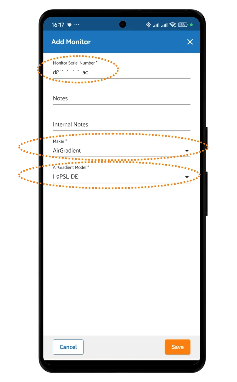

3 - Enter:
  • Serial number
  • Maker: AirGradient
  • Model
Alt text

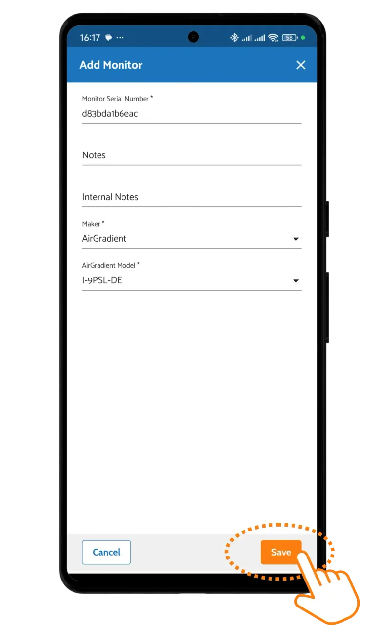

4 - Click Save
Alt text
Please note that adding a hardware entity alone is not enough.
To see data, you must also create a Location and assign the monitor to that Location.
Alt text
Alt text
To share data from the indoor location, enable Data Sharing while creating the location.
Alt text
