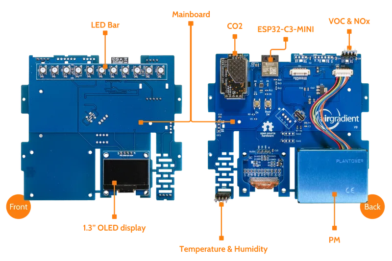

Here’s a quick overview of the main parts inside the device:

Inside the AirGradient ONE
1. AirGradient ONE Mainboard
The mainboard includes:
  • An ESP32-C3-MINI microcontroller that handles processing, Wi-Fi connectivity, and data transmission
  • Connectors and pin sockets for all sensor modules
  • Power management and onboard circuitry
This board coordinates sensor readings and sends data to the AirGradient dashboard or your own integrations.
2. RGB LED Bar
The pre-mounted 11 RGB LEDs display air quality/device status. It can be switched off.
3. 1.3" OLED Display (128x64px)
The pre-mounted 1.3" OLED display with 128x64px resolution displays real-time air quality measurements and device status. It can be switched off.
4. Plantower PMS5003 PM Sensor
This pre-mounted sensor measures:
  • PM1
  • PM2.5
  • PM10
5. SenseAir S8 / S88 CO₂ Sensor Module
This NDIR (Non-Dispersive Infrared) sensor measures carbon dioxide (CO₂) levels.
6. Sensirion SGP41 TVOC / NOx Sensor Module
This sensor measures:
  • TVOC (Total Volatile Organic Compounds)
  • NOx (Nitrogen Oxides index)
7. Sensirion SHT40 Temperature & Humidity Sensor Module
  • Temperature
  • Relative humidity
