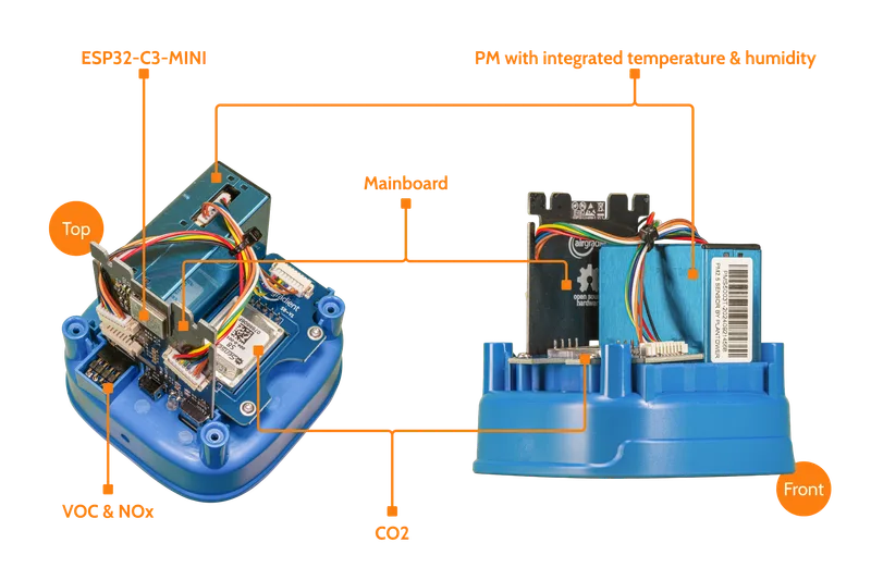

Here’s a quick overview of the main parts inside the device:

Inside the AirGradient Open Air
1. AirGradient Open Air Mainboard
The mainboard includes:
  • An ESP32-C3-MINI microcontroller that handles processing, Wi-Fi connectivity, and data transmission
  • Connectors and pin sockets for all sensor modules
  • Power management and onboard circuitry
This board coordinates sensor readings and sends data to the AirGradient dashboard or your own integrations.
2. Plantower PMS5003T PM Sensor
This pre-mounted sensor measures:
  • PM1
  • PM2.5
  • PM10
  • Temperature
3. SenseAir S8 / S88 CO₂ Sensor Module
This NDIR (Non-Dispersive Infrared) sensor measures carbon dioxide (CO₂) levels.
4. Sensirion SGP41 TVOC / NOx Sensor Module
This sensor measures:
  • TVOC (Total Volatile Organic Compounds)
  • NOx (Nitrogen Oxides index)
Modular by Design
One of the key advantages of the AirGradient Open Air is its modular design.
This means:
  • Sensors can be replaced individually if needed
  • Maintenance is easier
  • Future upgrades are simpler
This open and repairable approach helps extend the life of the monitor and supports long-term reliability.
For video instructions on replacing a module, see How do I replace a sensor module?.
