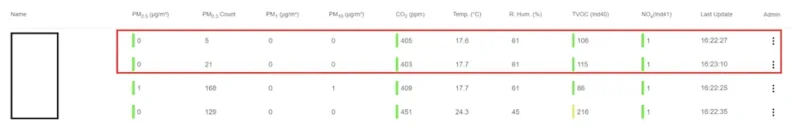

The first and easiest way to check for an affected sensor is to check the dashboard. Below, highlighted in red, are two sensors exhibiting this issue, followed by two working. At first glance, they look very similar as the monitors are in a very clean environment.

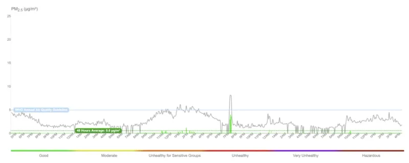

However, as soon as we look at more data (click on the PM2.5 value in the first column), we can see a big difference in the measurements taken by each sensor. Below are the measurements one of the working monitors took over the past 48 hours.
pms calib fix 2 mm4hppfj oynr4188
As you can see, there are regular fluctuations, which we would expect in a normal environment. When looking at one of the two too-low sensors (which are co-located) over the same time period, there is a very obvious difference. As you can see below, except for during the largest spike, the monitor almost consistently reads 0ug/m3 of PM2.5. If your monitor shows a graph like this, it will likely have this issue and need to be calibrated. It is important that these differences are still within the manufacturers specified accuract range of +- 10 ug/m3.

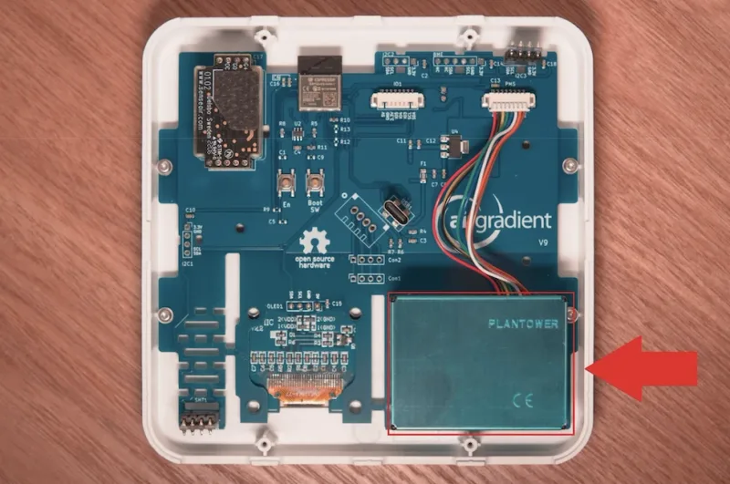

You will need to open your monitor to view the sensor’s serial number. You can do this quickly by unscrewing the four screws in the back of your monitor. Don’t worry - if you purchased a pre-assembled monitor, opening the device will not void any warranty you have.
pms calib fix 4 mm4hppoc j7wd1jey
Now, you will want to locate the largest sensor, which stands out as it’s a large blue box with the word PLANTOWER engraved on it. On the side of this sensor (the right hand side if the word is correctly orientated), you will find a sticker with a barcode, and, importantly, a number. The number will have a similar format to the following:

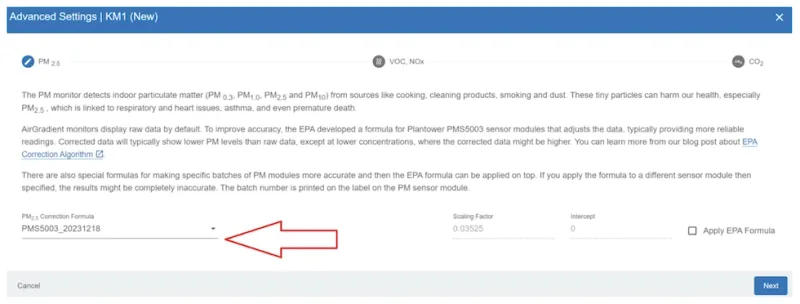

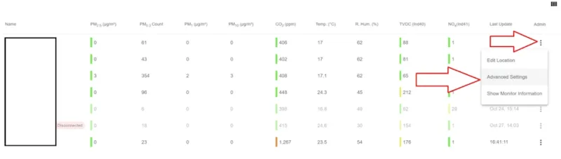

Back on the dashboard, you will want to navigate to the admin menu which is the final column shown for monitors on your homescreen. Under this menu, select ‘Advanced Settings’.
pms calib fix 6 mm4hpqbh ymoxeakr
On the first page of this menu (PM2.5), you will be able to apply a calibration formula as seen in the screenshot below. Select the formula with the number that matches the beginning of your sensor’s serial number. You can now apply the EPA formula on top of the calibration if you like.
pms calib fix 7 mm4hpqf9 rl5igof0
As soon as you change the formula in the drop-down menu, it will be saved for your dashboard.
You can also apply the EPA formula on top by selecting the checkbox. The EPA formula has been developed by the US EPA and improves the accuracy further, especially for areas close to wildfires.
