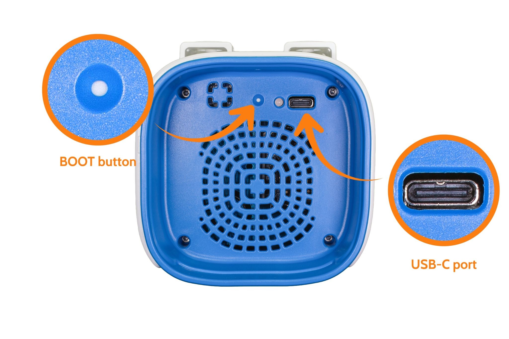

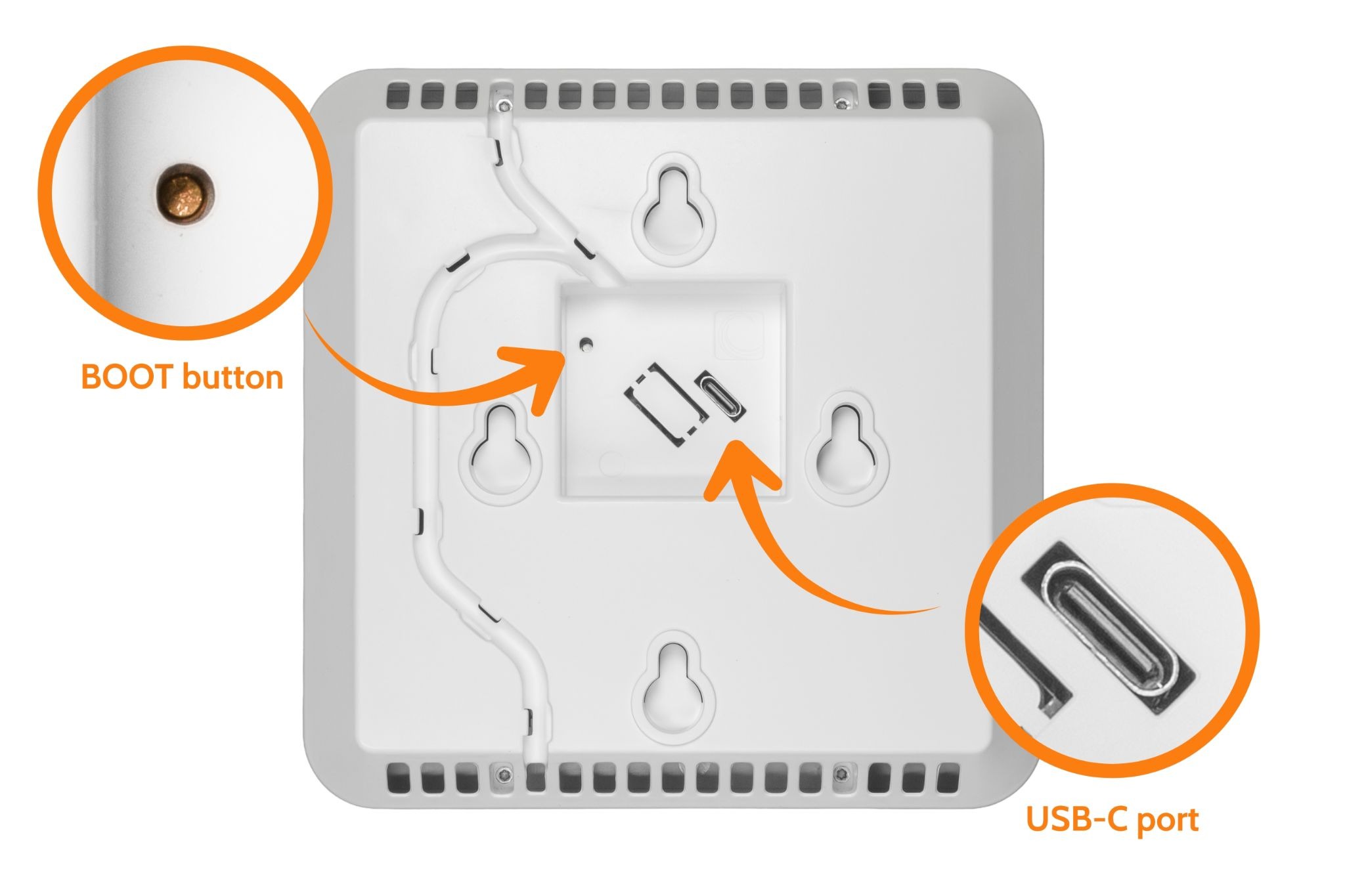

- A tool (paperclip, toothpick, small screwdriver) that fits through the pin hole on the back of the device to reach the BOOT button. This is because the BOOT button is on the mainboard inside the enclosure.

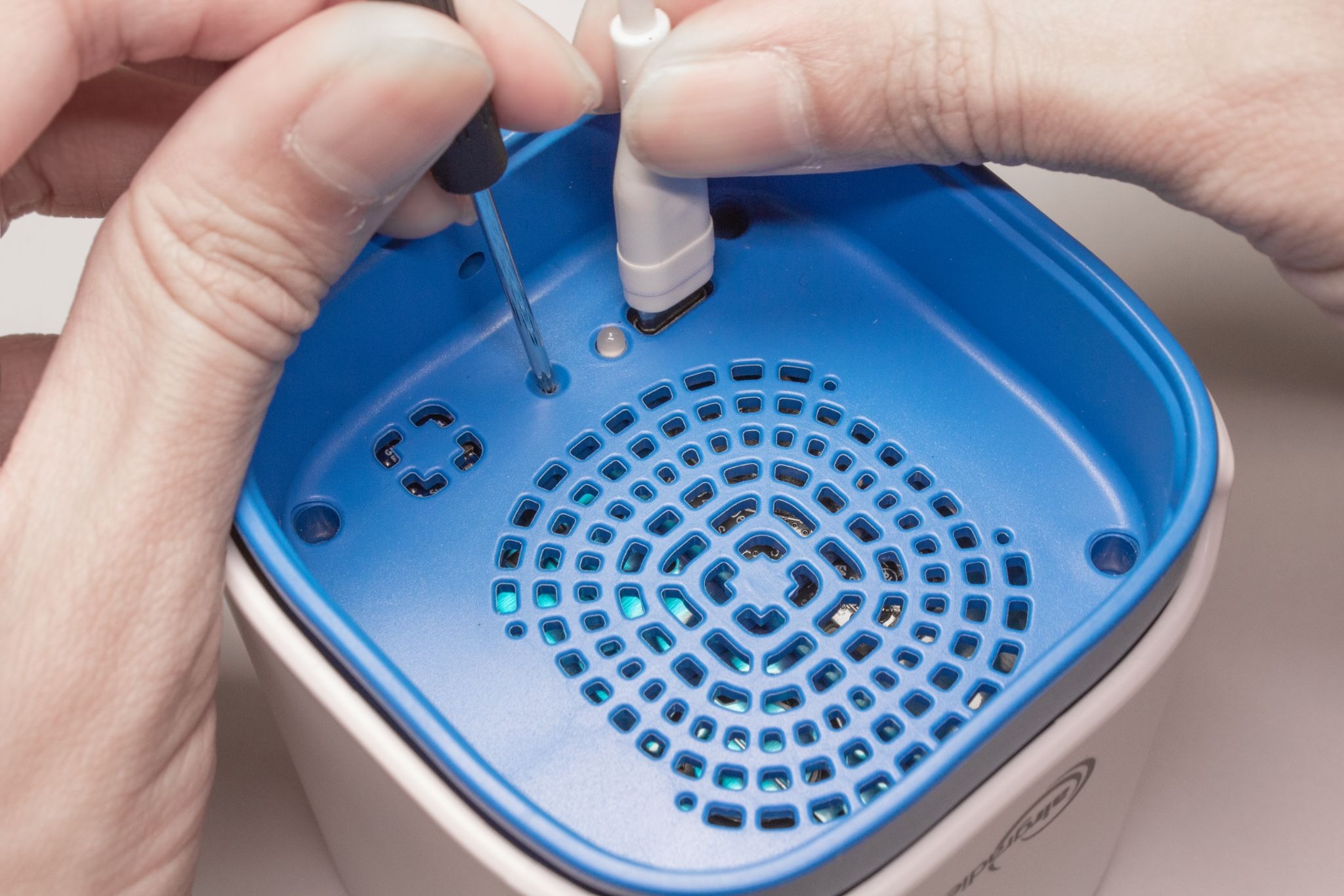

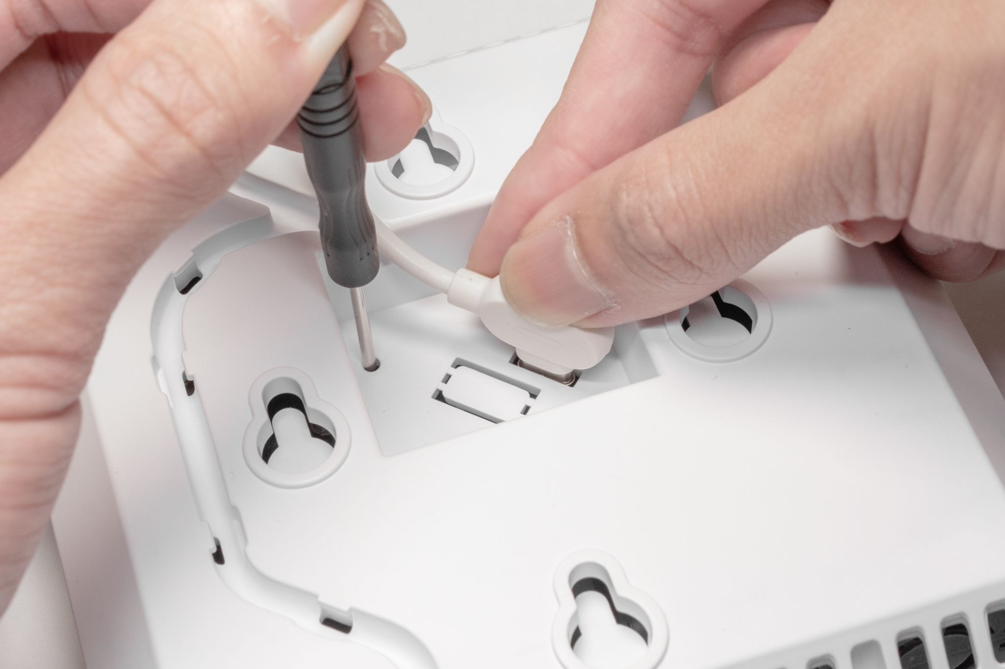

Step 1: Enter Flash Mode

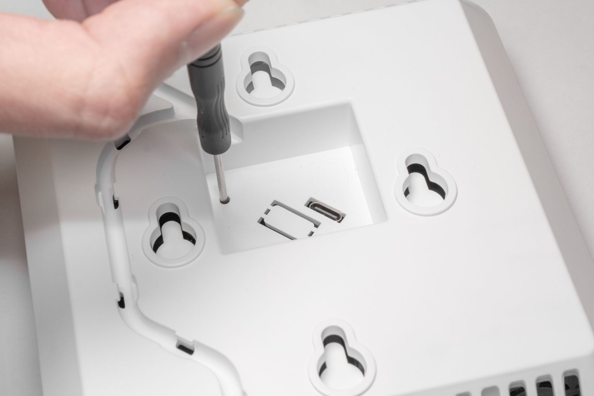

  1. Press and HOLD the BOOT button on the back of the AirGradient ONE:
  1. While holding the BOOT button, plug in the USB-C cable:
  1. Release the BOOT button AFTER the USB-C cable is plugged in.
Note: Ensure the correct sequence is followed:
Press and hold BOOT button → plug USB cable → release BOOT button.If done correctly, the device will appear off (no screen, no LEDs). This is normal.

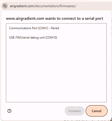

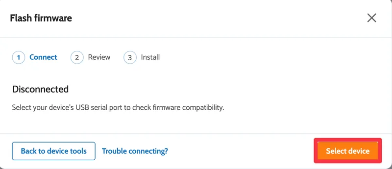

Step 3: Select Your Device Port
Choose the option named: USB JTAG / Serial Debug (or similar depending on your OS)
Click Connect.

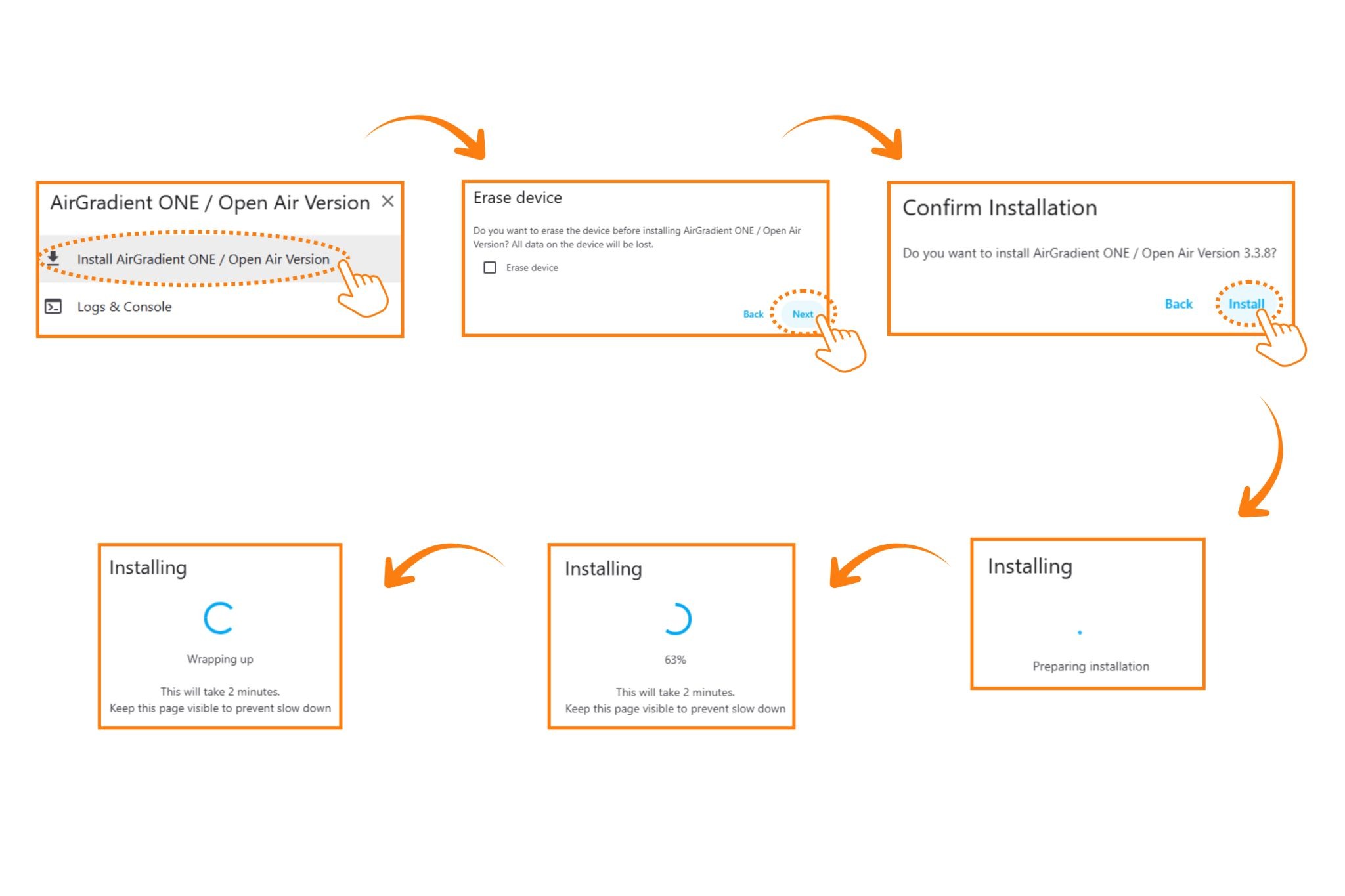

Step 4: Flash the Firmware

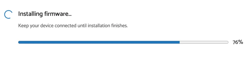

The flashing sequence will begin:
Do not disconnect the cable during this process.

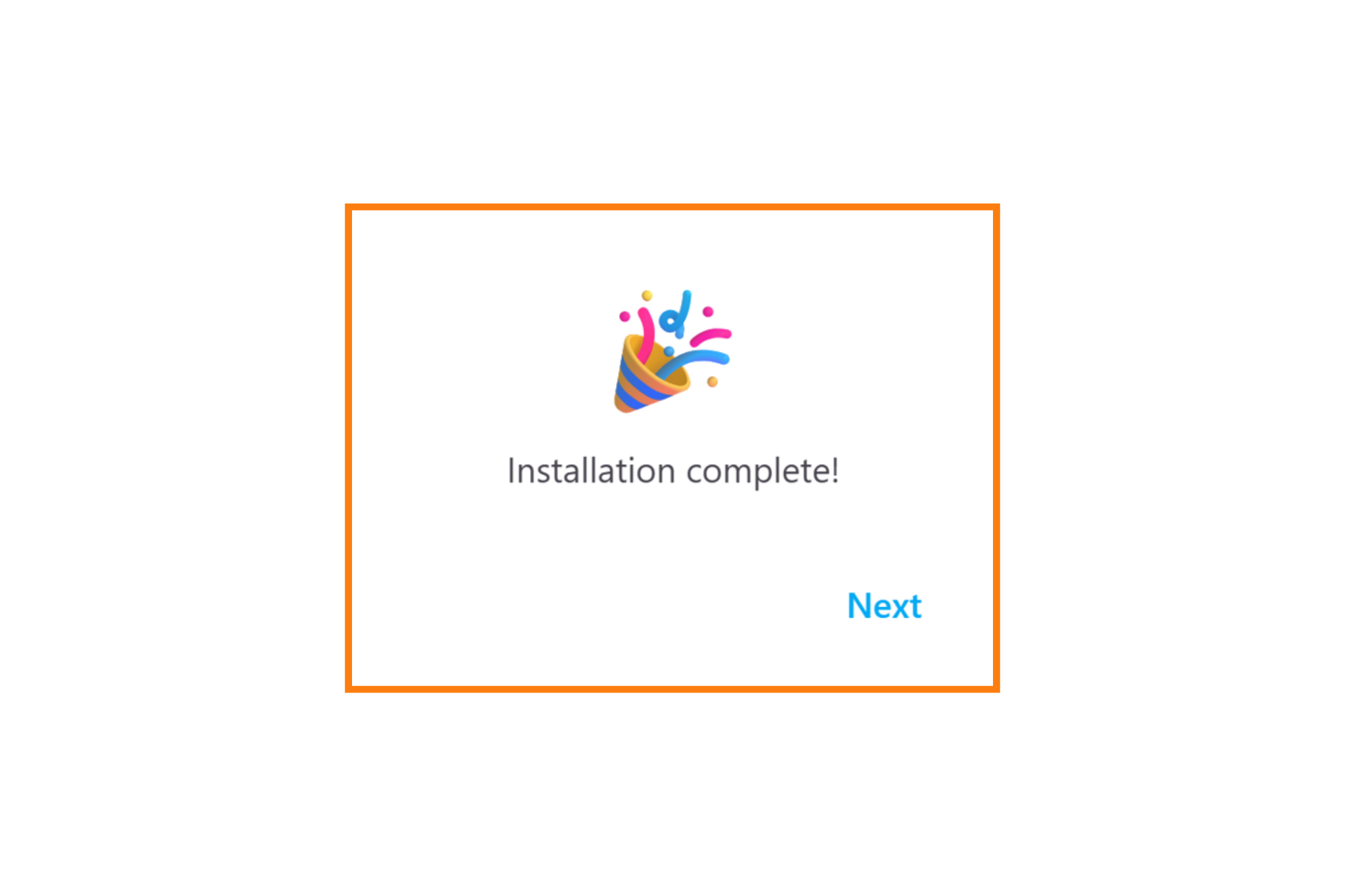

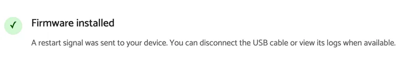

Once completed, the tool will show a success message.

The device will now boot with the updated firmware.

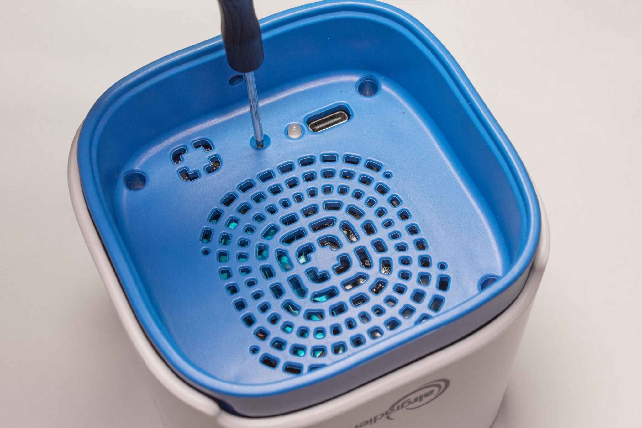

- A tool (paperclip, toothpick, small screwdriver) that fits through the pin hole on the underside of the device to press the BOOT button.
Follow the steps below carefully to ensure a successful update.

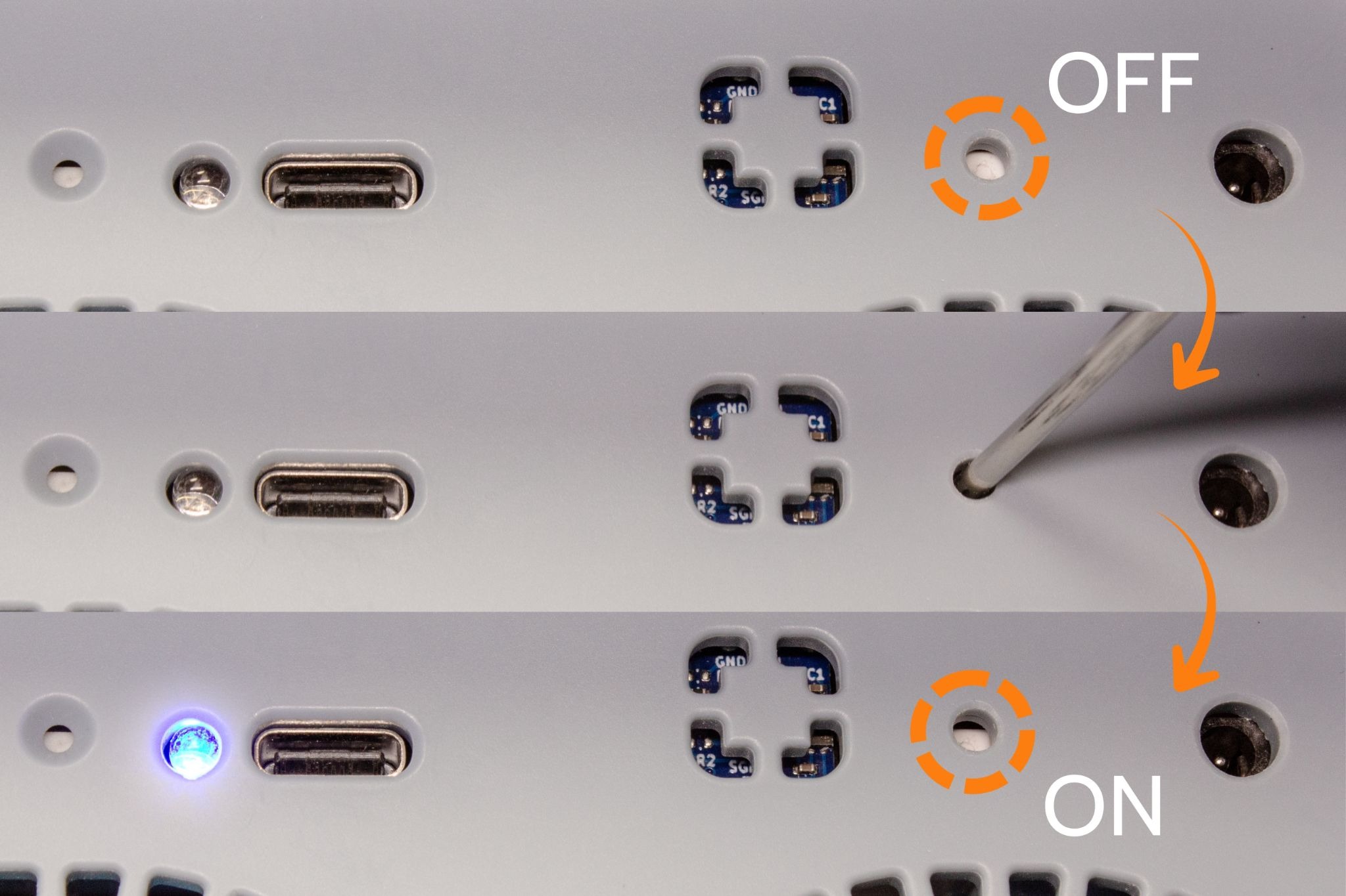

  1. Press and HOLD the BOOT button on the underside of the AirGradient Open Air:
If done correctly, the device will appear off (no LED indication).

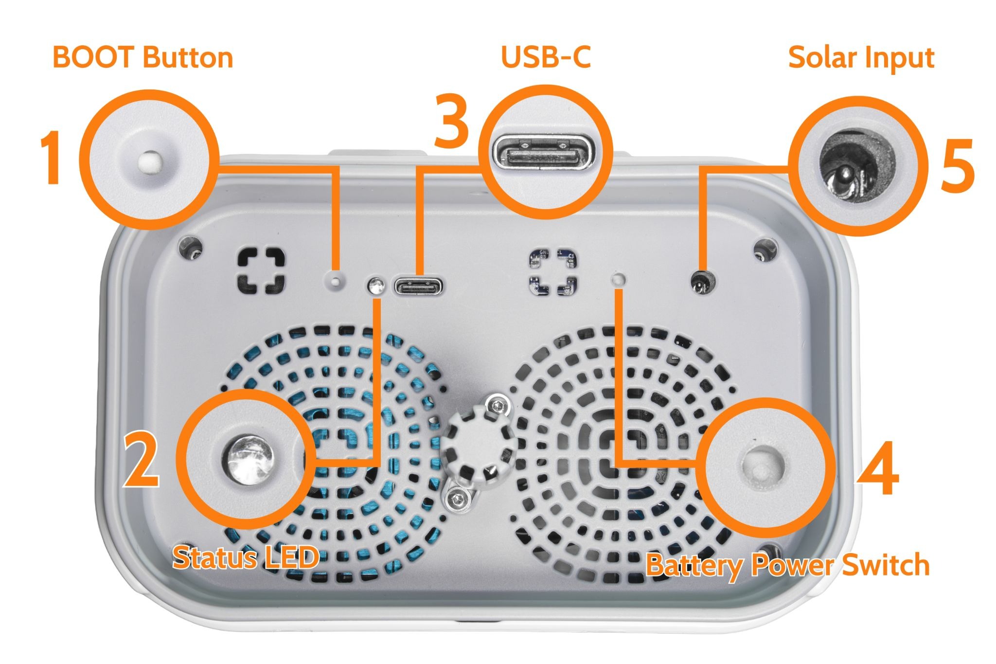

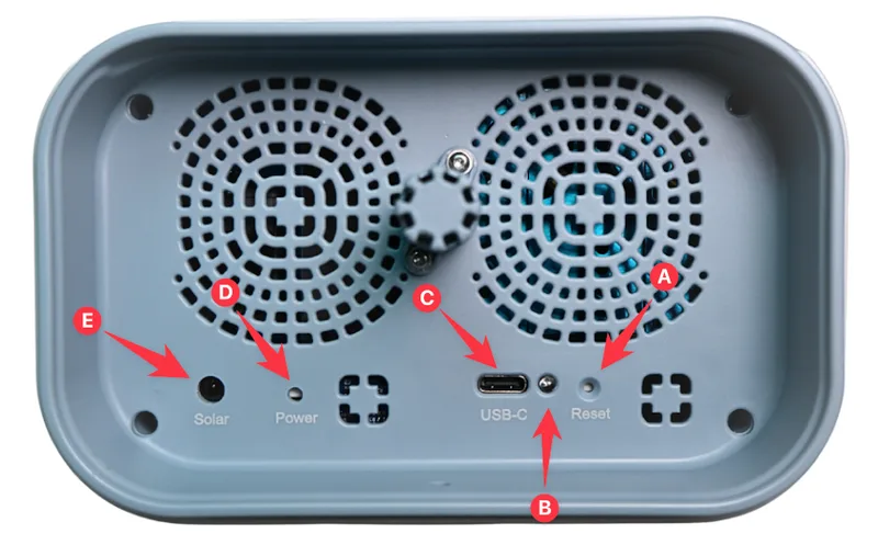

  1. BOOT Button, 2. Status LED, 3. USB-C, 4. Battery Power Switch, 5. Solar Input

Step 1: Connect the monitor to a computer
  1. Turn the Open Air Max ON by making sure the battery power switch is in the ON position (pushed in). If the monitor was already ON, turn it off first then turn it back ON.
  1. Connect the Open Air Max to your computer.

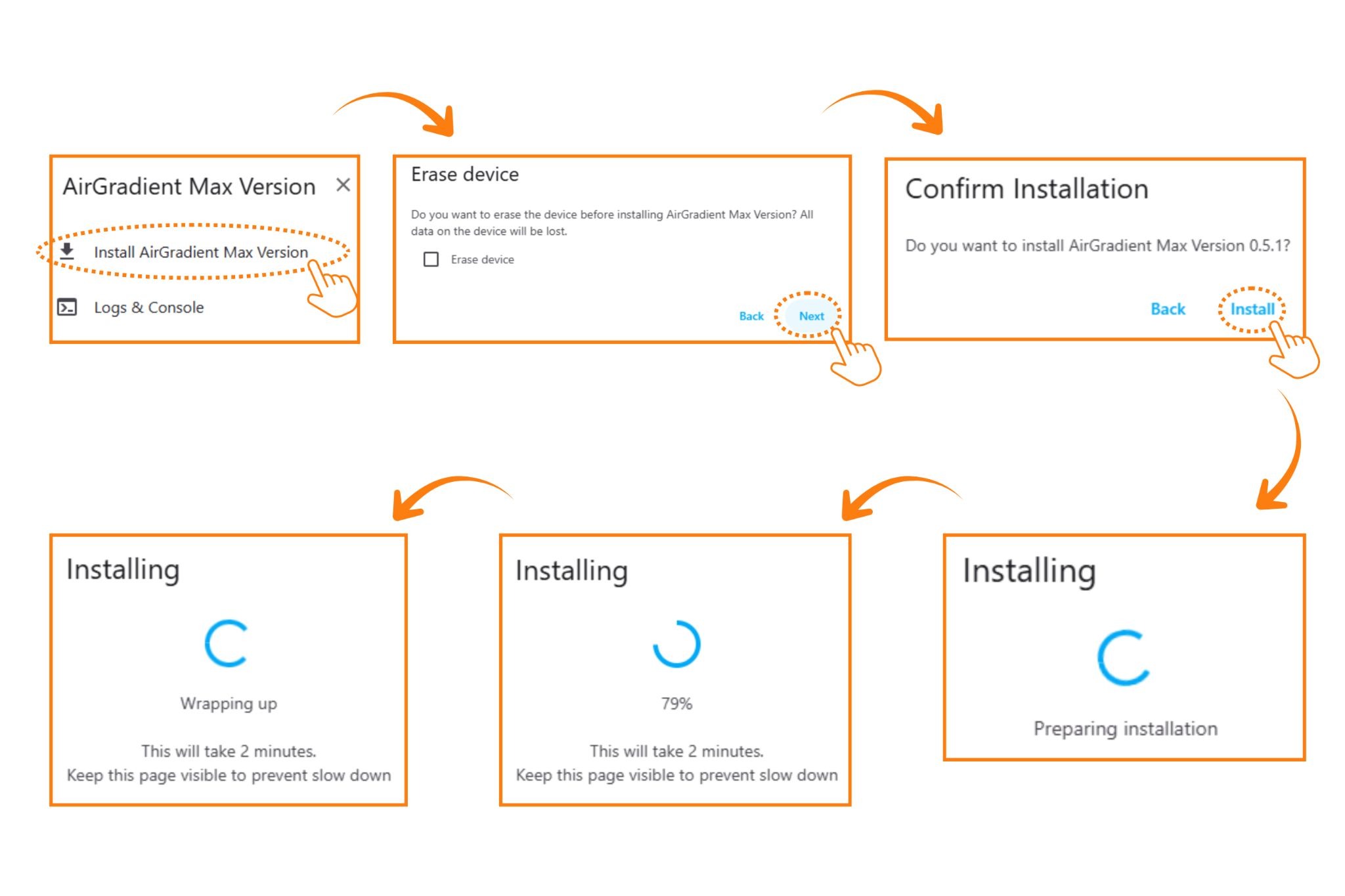

Step 2: Start the Flashing Tool
Click the button below:
Your browser doesn't support this. Please use Chrome or Edge on Mac or PC.You are not allowed to use this on HTTP!
A pop-up window will appear asking you to select the device.
If the blue “FLASH NOW” button above is not visible, this usually either means you’re accessing the webpage using a non-Chromium browser or the browser is blocking WebSerial. Try the following:
  • Use Google Chrome, Microsoft Edge or any other Chromium- based browser.
(Safari and Firefox do not support WebSerial)
  • Disable any script-blocking extensions (uBlock Origin, NoScript, etc.)
Click Connect.
The device firmware has now been updated.
