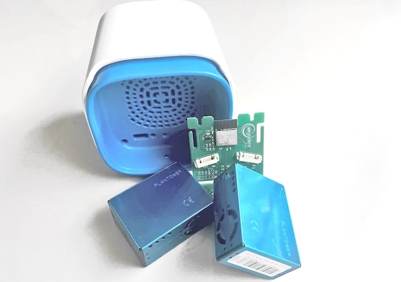

Below is the list of components that you will receive with the pre-soldered kit:
Component Details
AirGradient Open Air PCB with ESP-32-C3
2x Plantower PMS5003T PM Sensor
2x JST 8 cross-over cable for connecting PM sensors
USB-C cable 4 meter long (for flashing and power)
Enclosure UV-resistant injection molded ASA plastic
4x Screws for enclosure M1.8x11 (Torx T6)
Screwdriver Torx T6

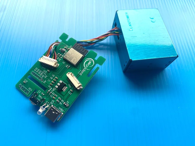

Connect the PM Cables
First connect the PM cable to the PM sensor. Make sure you put the cable into the PM sensor in the right way. Then feed the cable through the small slots on the PCB and connect the cable to the PCB. You need to press the cables into the PM sensor and connector tightly. Please ensure that the cable is fully plugged in on both ends.
Connecting the pm sensor to the PCB
Then repeat the same thing for the second PM module.

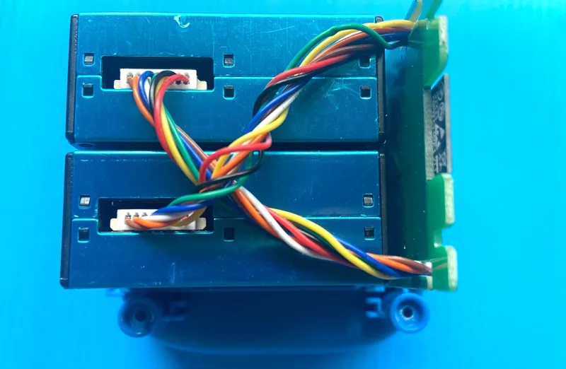

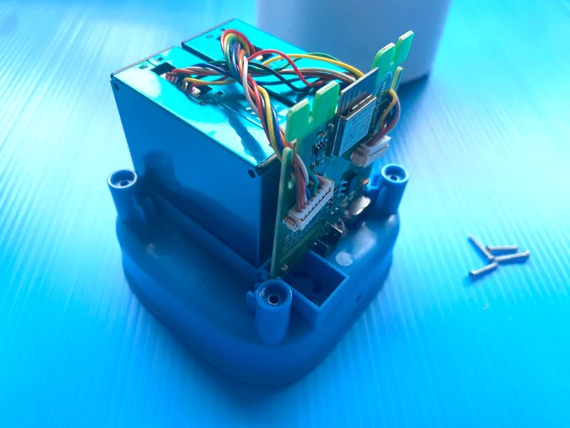

Placement of the parts inside the enclosure
After you have connected both PM modules, place the PCB, PM modules into the blue bottom plastic part of the enclosure.

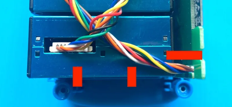

Please note the following: Twist the cable around 3 times and put the PM modules cross over from the cable exit on the PCB.
Picture of fully assembled units before enclosure is closed
It is important that the cables are not squeezed from the plastic parts of the enclosure. So you should avoid that the cables are on the areas marked red in below image. Have a look at the inside of the white top part of the enclosure to see which parts might press onto the cable.
Closing the enclosure
After you have made sure that the cables are aligned correctly, the PCB is 100% upright and that all parts are fitted in correctly, carefully slide the top part onto the assembly. As soon as you feel there is some resistance from components inside the enclosure, do not force it but lift up the top part and check again if the PCB is upright and the cables not interfere with the pastic rifts.
Once the two parts slide together smoothly, turn the complete assembly around and use the four screws to put it together.
