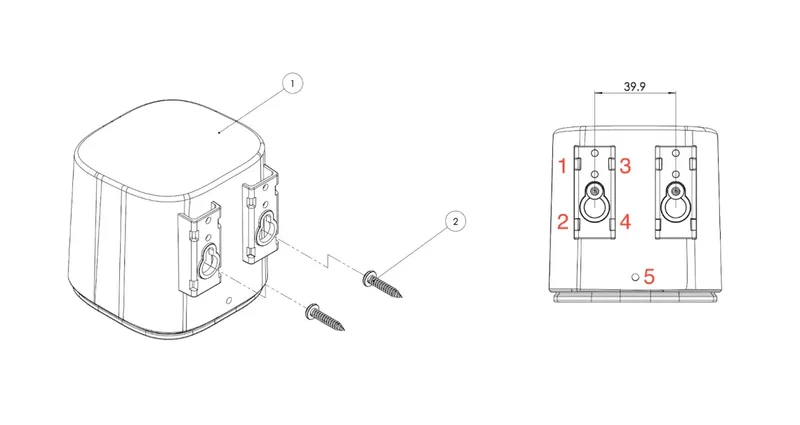

The AirGradient Open Air comes with a mounting bracket on the back of the device designed to allow flexibility during the mounting process. There are different mounting methods available.
Alt text
For most installations, the included cable ties, sturdy string, or wires can be passed through the four holes on the sides of each bracket (marked 1-4 on the image above). This method is best suited for mounting the device on poles, fence posts, or any other object to which the monitor can be tied.
When installing the device on a flat surface where cable ties or wire can’t be used, we recommend using the two large screw mounts (located 39.9mm apart) and drilling two M4 screws into the flat surface with the screw heads sticking out. The monitor can then be mounted on these heads and pushed down to ensure a solid mount. When removing the monitor, push it up before pulling it off the screws.
For additional security, the Open Air features an additional hole for screws at the bottom (marked 5 on the image above) of the monitor. This is intended to be used as a theft deterrent and will ensure the monitor can’t be quickly removed from its mounting position.

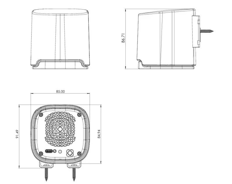

Below is a diagram showing the full dimensions of the Open Air and how it will look when mounted with M4 screws. Please note the screws should first be screwed into the surface which you want to mount the monitor on.
