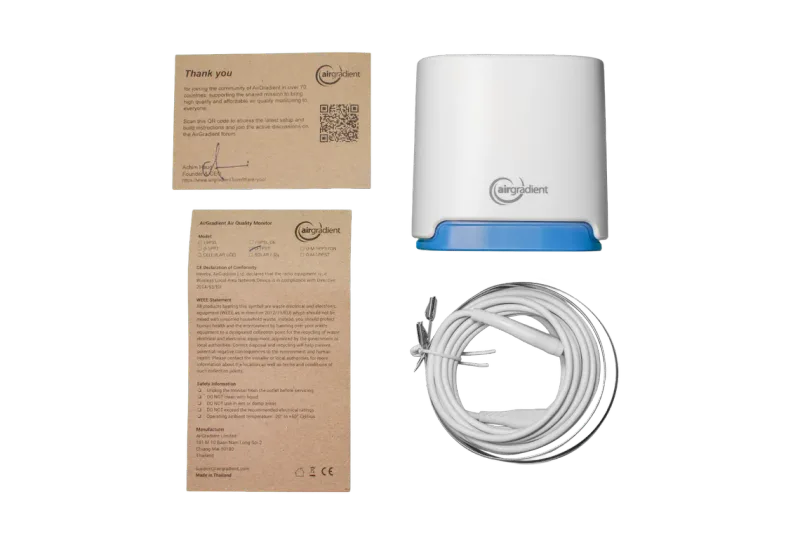

Fully assembled monitors
Fully assembled monitors come ready to use. Check that the box contains the monitor, two metal cable ties, and the 4 m USB cable. See Unboxing the AirGradient Open Air.

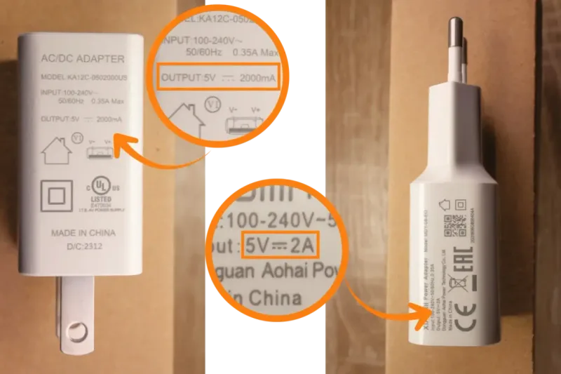

Connect the cable to a stable 5 V, 2 A USB power adapter. The adapter is not included.
See Powering the AirGradient Open Air for complete power guidance.
