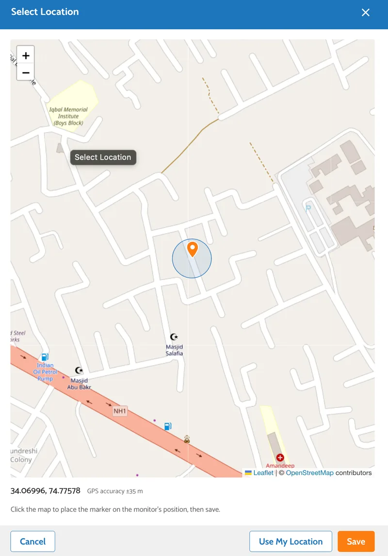

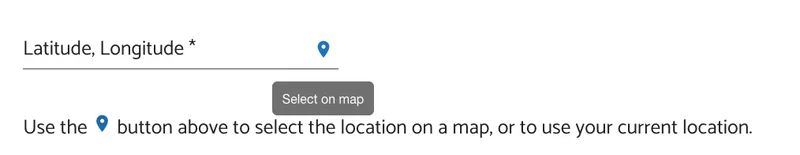

2. The location coordinates
If you share your data publicly, you also need to provide the location coordinates for the monitor.
Tap the location pin beside the Latitude, Longitude input.
The location picker lets you:
  • use your current location
  • place the pin manually on the map
You can also enter the latitude and longitude from Google Maps:
  • Open Google Maps.
  • Right-click on the monitor’s location.
  • Copy the coordinates shown in the menu.
  • Paste them into the location coordinates field in the AirGradient dashboard.
Example format:
40.1792, 44.4991
The coordinates should be accurate enough to represent the monitor’s outdoor location. For OpenAQ sharing, both the latitude and longitude must have at least three decimal places.
For example, these coordinates may be accepted by the AirGradient Map but may not be precise enough for OpenAQ:
7.14, 125.62
Instead, use at least three decimal places:
7.143, 125.625
This is important because coordinates with only two decimal places can represent a location roughly within 1 km of the actual monitor position, which is not precise enough for OpenAQ.

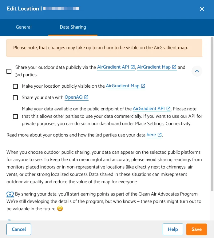

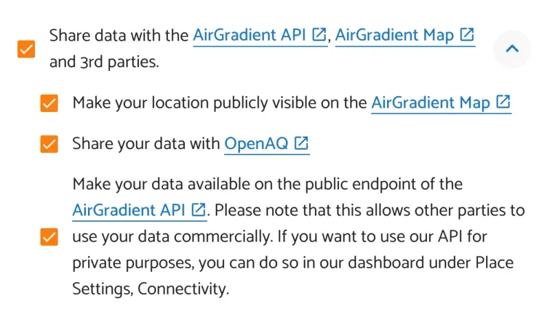

Option 2: Enable Public Data Sharing After the Monitor Has Been Added to the Dashboard
You can also enable or update public data sharing after the monitor has already been added to your dashboard.
To do this:
  • Open the AirGradient dashboard.
  • Go to Locations.
  • Go to Admin for the relevant location.
  • Click Edit Location.
  • Find the Data Sharing section.
Here, you can choose whether you want to share the data publicly.
If public sharing is enabled, enter a public location name and the location coordinates according to the steps described above.
  • Save the changes when finished.
